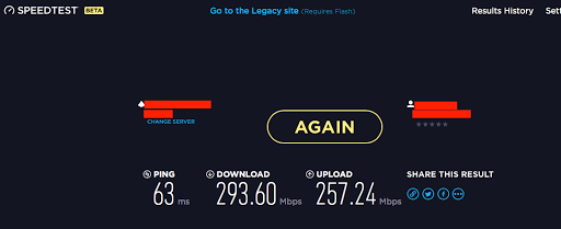

G+_Daniel Stagner Posted May 29, 2017 Author Share Posted May 29, 2017 Update: 1.3.4 is not being updated. I can't get it working. I will wait for a stable version of 2.0 before i continue to play with it. I have download the 30 day trial of Arq and started a backup from a mac mini of a 18tb volume from the FreeNAS box. It has backed up 300gb's in 13 hours but has slowed way down to about 3~6 MB per sec. Its a bit slower then what should be possible but I do not know where the Amazon server is in relation to my location. I have several 3+ TB Aperture libraries in that volume and i am very curious to see how/if Arq will handle them. I will also setup an other box to try CloudBerry tomorrow or tonight time permitting. Do you know of any other paid service that can backup to my Amazon Drive. I mite as well try them all out. Link to comment Share on other sites More sharing options...
