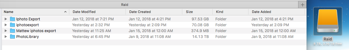

G+_Daniel Stagner Posted January 17, 2018 Share Posted January 17, 2018 What other file systems can use space like APFS from High Sierra. Please see the attached photo if you are wondering what I mean. The other day I started moving all my photo libraries to one hard drive in order to search them for photos of my brother. I wanted them in a local USB drive for ease and speed of access. I decided to place them on an apple JOBD RAID that I cobbled together from two 4 TB hard drives. I went with APFS knowing that APFS would likely be a good choice for the file system due to the extra copies of images files I was likely to generate. I was not expecting that APFS could use space so effectively. As I copied library after library to the raid it just stopped taking up space. This was due to the multiple libraries being backups of each other over the years. In any case what I want to know is there a file system available for FreeNAS or it's like that will do the same thing. Also is APFS using hashing to identify the duplicate files or something else. Link to comment Share on other sites More sharing options...
