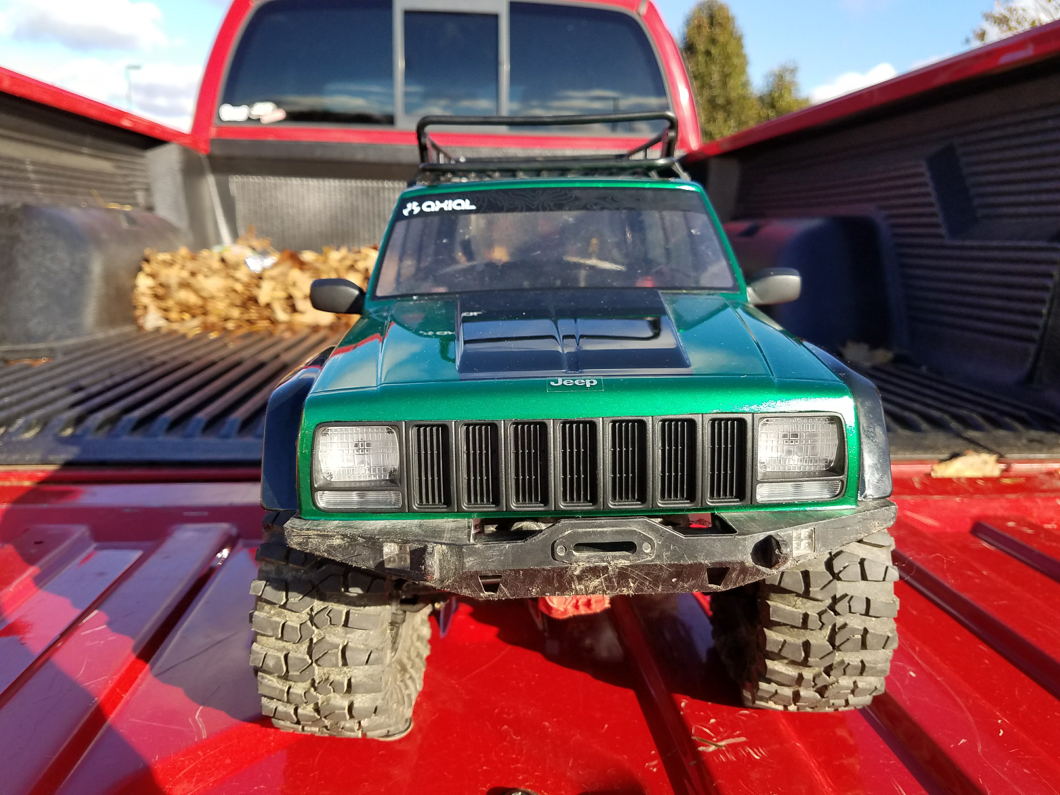

G+_Darwin Bohnke Posted November 28, 2016 Author Share Posted November 28, 2016 Here is a pic of my rc, those headlights are just begging to shine Link to comment Share on other sites More sharing options...
