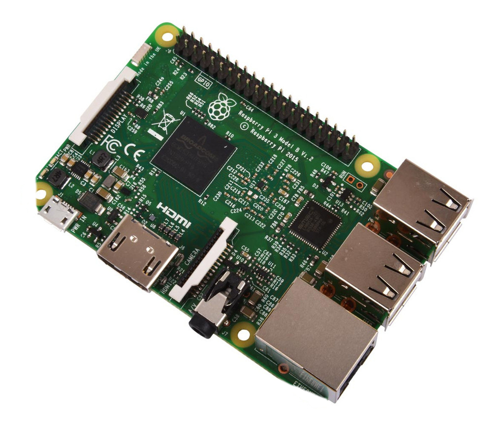

G+_Richard Hedderly Posted April 18, 2016 Share Posted April 18, 2016 I need guidance, HiveMind.... I need to put a Rasp Pi 3 in a very tight space. I can do it IF I trim the corners off the PCB on the HDMI socket side. I've looked online and some say to use an Exacto/Craft knife where others say to use a Dremel. Any preference?? Link to comment Share on other sites More sharing options...
G+_Richard Hedderly Posted April 18, 2016 Author Share Posted April 18, 2016 Thanks +Taylor Graham "depends on how much work you want to do and how steady your hand is. If you're good with a dremel, and/or have a grinding wheel, just nip the edges off quickly. If you aren't good with a dremel its probably best to use a razor since there's less possibility of the tool jumping and breaking your pie, though im sure it will take longer." Reposted due to my double post. Link to comment Share on other sites More sharing options...
G+_Eddie Foy Posted April 18, 2016 Share Posted April 18, 2016 should be ok. But these are multi layer PCBs, hard to see the inner traces. But looking at the pic, I'd hope the DRC would pick up anything that close to the edge. Link to comment Share on other sites More sharing options...
G+_Eddie Foy Posted April 18, 2016 Share Posted April 18, 2016 Can you move the mountain to Mohammad instead? Link to comment Share on other sites More sharing options...
G+_Eddie Foy Posted April 18, 2016 Share Posted April 18, 2016 I'd use a file or sand paper. its not that much to trim, more control. Link to comment Share on other sites More sharing options...
G+_Ben Reese Posted April 19, 2016 Share Posted April 19, 2016 Sharp fingernail or toenail clippers might work on the corner. I'd probably try a fine-grain sander or grinder though. Dremel would also be an option. I don't think I'd use a knife just because of the risk of slipping and cutting into the board. Just depends on your level of confidence and how much you're willing to risk damaging it. Link to comment Share on other sites More sharing options...
G+_Eddie Foy Posted April 19, 2016 Share Posted April 19, 2016 I wouldn't use the nail clippers (or dykes or the like) They cut with a crushing method. This can lead to delamination. You also aren't 'supposed to' use them to cut semiconductor leads either; it 'can' cause a damaging shock-wave Link to comment Share on other sites More sharing options...
G+_Jason Perry Posted April 19, 2016 Share Posted April 19, 2016 I think I would use a file. cutting sounds like a bad idea Link to comment Share on other sites More sharing options...
