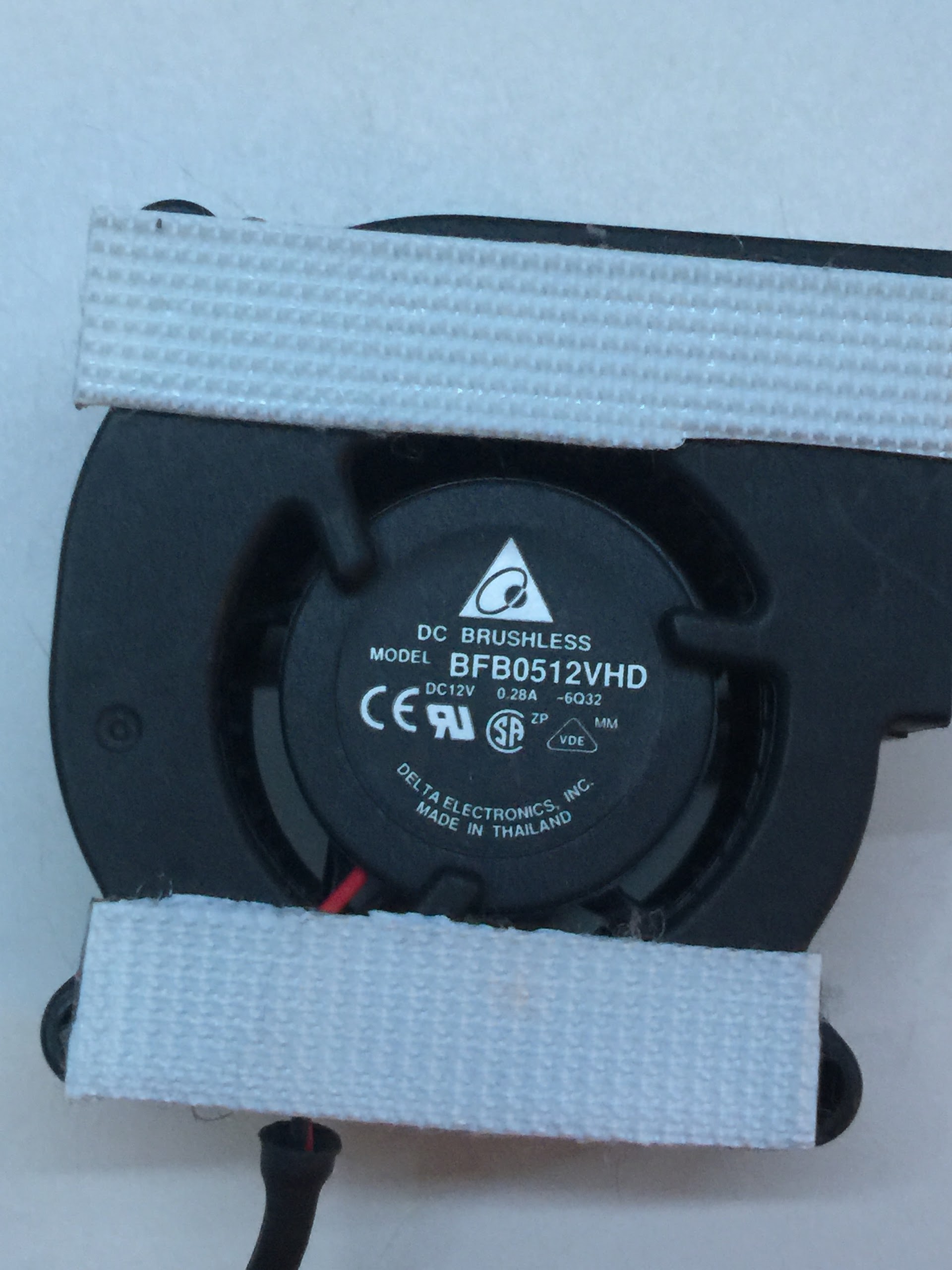

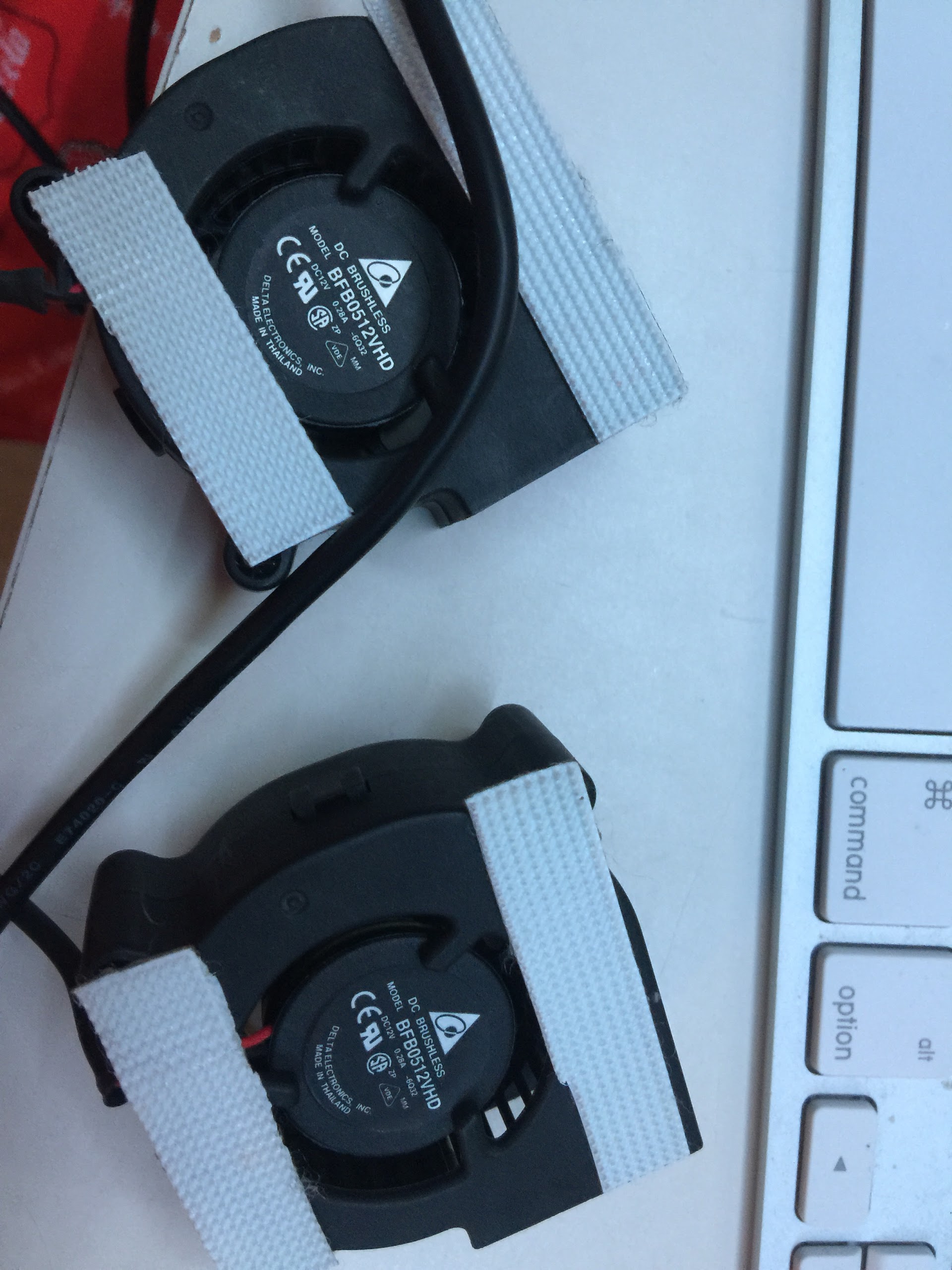

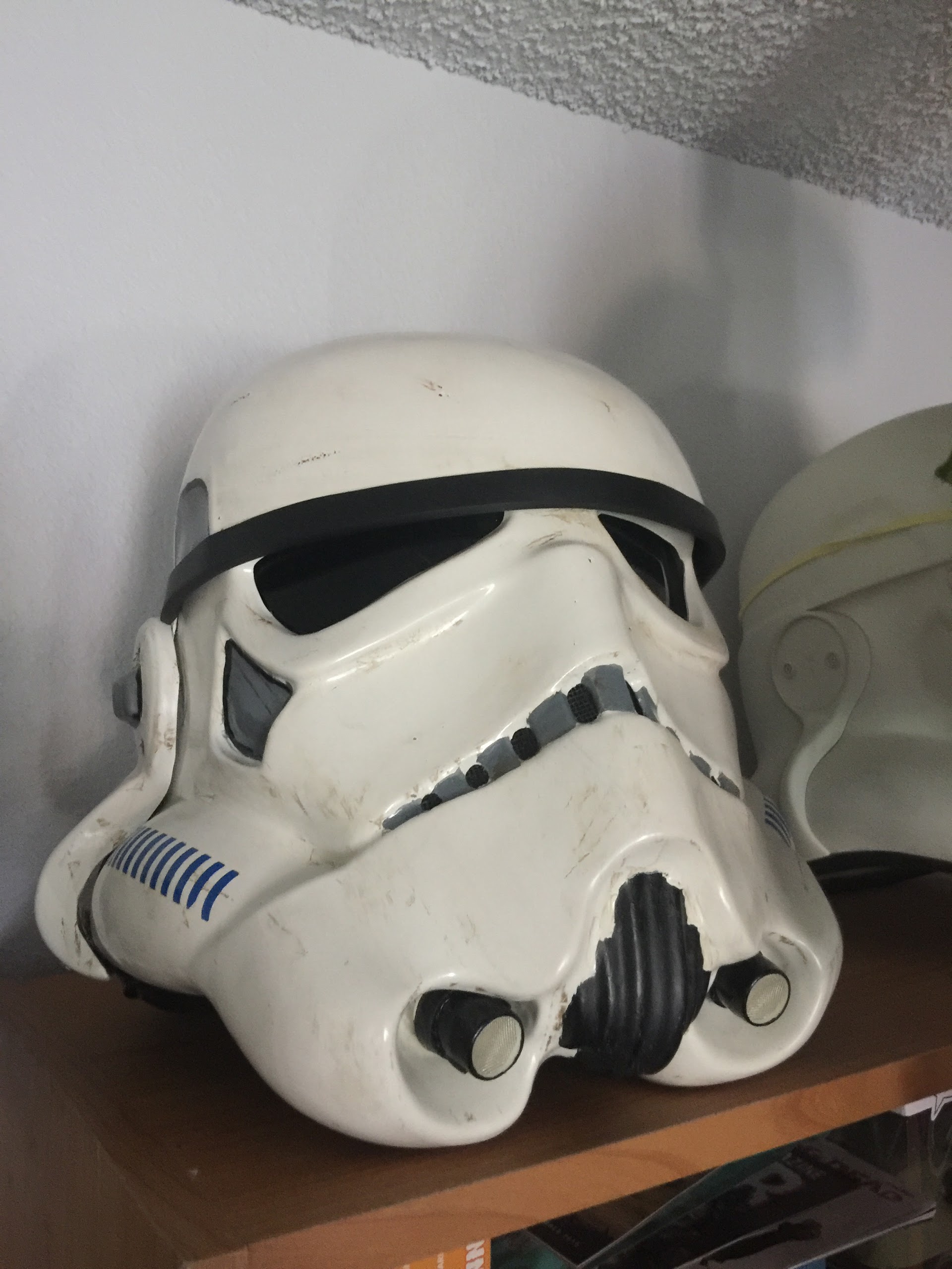

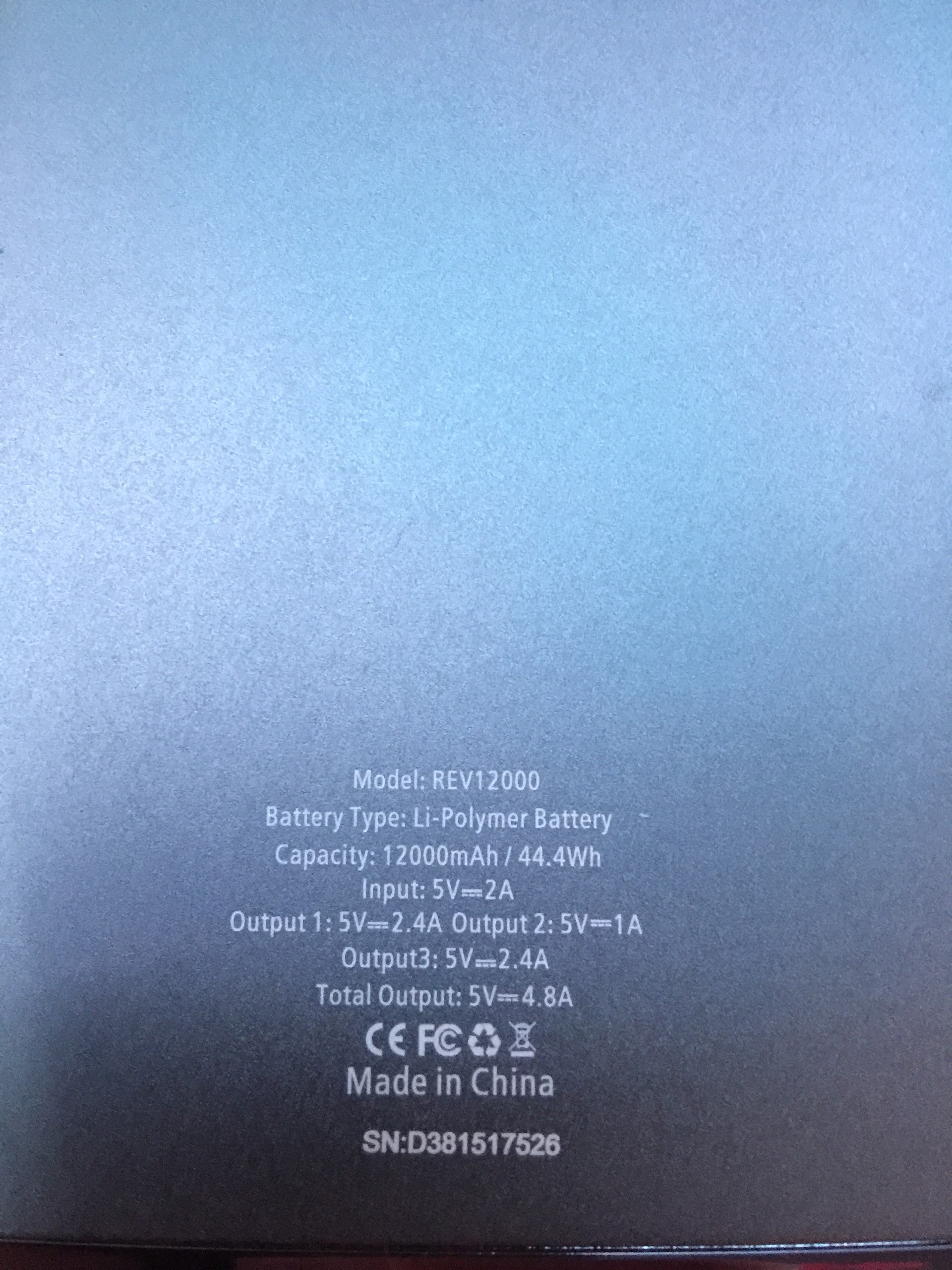

G+_Erik von Oy Posted April 16, 2016 Share Posted April 16, 2016 How can I make this work using these fans with this cellphone battery backup so that I don't get to hot wearing this helmet Link to comment Share on other sites More sharing options...
G+_Ben Reese Posted April 16, 2016 Share Posted April 16, 2016 The fans are 12v so won't run full speed off a 5v USB - but that might be ok. An old USB cable with the end cut off should hook up just fine to the fans. Link to comment Share on other sites More sharing options...
G+_Mr covert Posted April 16, 2016 Share Posted April 16, 2016 Step up converter Wayne Hobbins? linked to is exactly what you want. Run time will be about 6 hours with both fans on. Link to comment Share on other sites More sharing options...

G+_Erik von Oy Posted May 1, 2016 Author Share Posted May 1, 2016 It won't let me add a photo. :( But I've had the fan's running at about 50% and I have only used 17% of the battery. No more AA battery's. :) Link to comment Share on other sites More sharing options...
