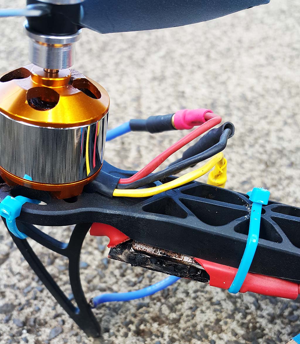

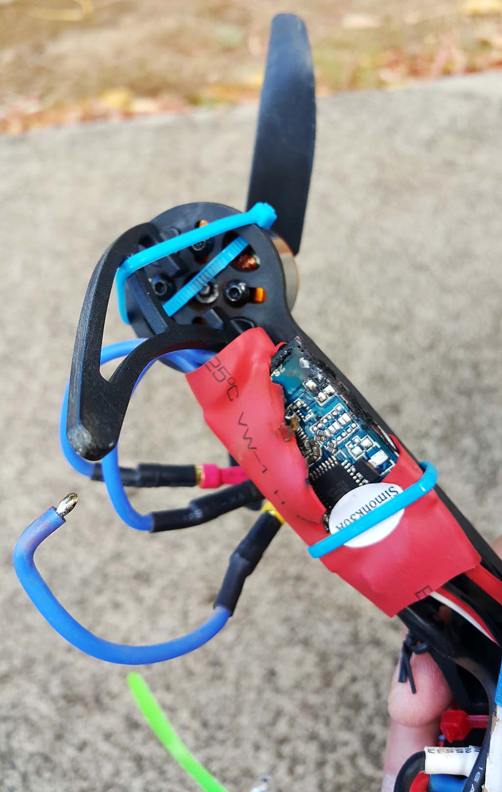

G+_Jeth Rigoroso Posted June 24, 2015 Share Posted June 24, 2015 I burned out my ESC. It was an Andoer SimonK 30 amp unit powering a 2200KV motor. It ran on a 3S 20C lipo. I guess it's back to the drawing board. Link to comment Share on other sites More sharing options...
G+_Fr. Robert Ballecer, SJ Posted June 24, 2015 Share Posted June 24, 2015 hmm... .that looks like a 2212 class motor... shouldn't have burned... Link to comment Share on other sites More sharing options...
G+_Jeth Rigoroso Posted June 24, 2015 Author Share Posted June 24, 2015 That's actually the second time it happened, but with a different motor! Maybe I should switch to a different ESC brand. Link to comment Share on other sites More sharing options...
G+_Kellen Razzano Posted June 25, 2015 Share Posted June 25, 2015 Jeth Rigoroso? what size prop are you using? Link to comment Share on other sites More sharing options...
G+_Jeth Rigoroso Posted June 25, 2015 Author Share Posted June 25, 2015 5x4 plastic Gemfans Link to comment Share on other sites More sharing options...
G+_Kellen Razzano Posted June 25, 2015 Share Posted June 25, 2015 The prop size is absolutely important when it comes to what your motor is drawing on the ESC -- you really need to use a watt meter like this http://goo.gl/CXJ68J. But agreed, you should be okay with a 5x4. You are running some very high-KV motors for a quad. 2200kv is usually used on EDFs or like a FunJet. Do not get any ESC less than 30A though -- even the mfgr specs advise a 30A. I'd just chalk this one up as some bad parts from that brand. Link to comment Share on other sites More sharing options...
G+_Fr. Robert Ballecer, SJ Posted June 25, 2015 Share Posted June 25, 2015 Kellen Razzano 2200KV is not abnormal for a 250-class quad. He looks to be running a 250 or 260 class diatone frame. I use 2208-2300KV motors on those... and that's the right prop size. My 450 class quads use 935kv, and my 660 class use 450kv. :) Link to comment Share on other sites More sharing options...
G+_Kellen Razzano Posted June 26, 2015 Share Posted June 26, 2015 Fr. Robert Ballecer, SJ? hah, what am I thinking, I have 2300kv's on my 250 as well. ...That's what I get for thinking about quads during an office meeting. Link to comment Share on other sites More sharing options...
