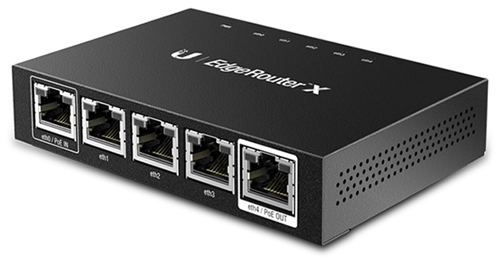

G+_Golden Retriever Posted November 26, 2016 Share Posted November 26, 2016 I think about the time 3 dumb router config came about, Ubiquiti Networks introduced the EdgeRouter X for fifty bucks. People went to using this for connecting the two Wi-Fi routers to there cable modem Link to comment Share on other sites More sharing options...

G+_Ben Reese Posted November 26, 2016 Share Posted November 26, 2016 EdgeRouter X is a great deal if you're using separate access points. Really the best way to do it anyhow. I think if you pair that with the Ubiquiti APs, you can even have multiple subnets setup on each AP - which might accomplish both tasks. Link to comment Share on other sites More sharing options...
