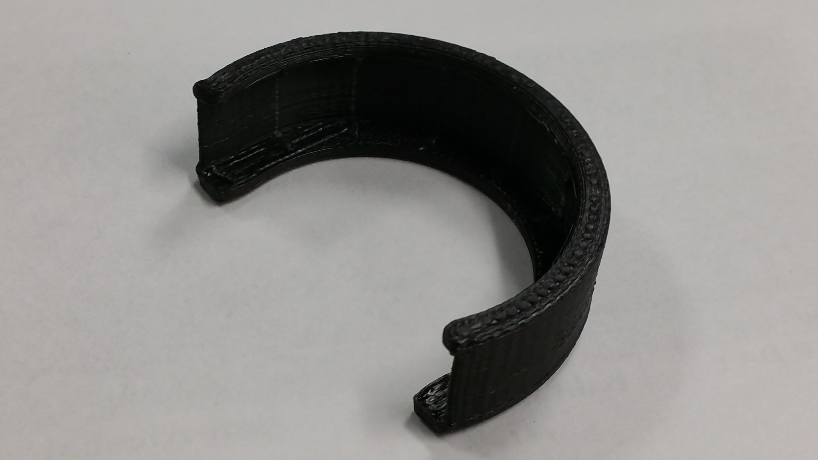

G+_James Hughes Posted October 31, 2017 Share Posted October 31, 2017 Are there any resin casting experts that could help me find the best product for my project? I'm want to cast some small bumpers for a project I'm making. I 3d printed some out of ABS and they work really good. But after a few times taking them off and on they start to get a little bit of layer delamination. It would need to be a bit flexible as it has to flex to be put on. But not too flexible as it needs to capture a sheet of acrylic. Link to comment Share on other sites More sharing options...

G+_James Hughes Posted November 1, 2017 Author Share Posted November 1, 2017 Mark Jurisch I did a little research and found that I need something with a durometer of around A70 which should be similar to the rubber tread on an automobile tire. The resin, pigment, and silicone mold material is going to set me back about $120. So I'm going to have to think about it for a day or two. Link to comment Share on other sites More sharing options...
G+_James Hughes Posted November 1, 2017 Author Share Posted November 1, 2017 Jason Perry I'm printing abs at 258c which should give me good layer adhesion. Might need to redesign the part to beef it up a bit. Don't want to go too far and lose the flexibility needed to put it on and take it off. Plus I think casting would be quicker. Link to comment Share on other sites More sharing options...

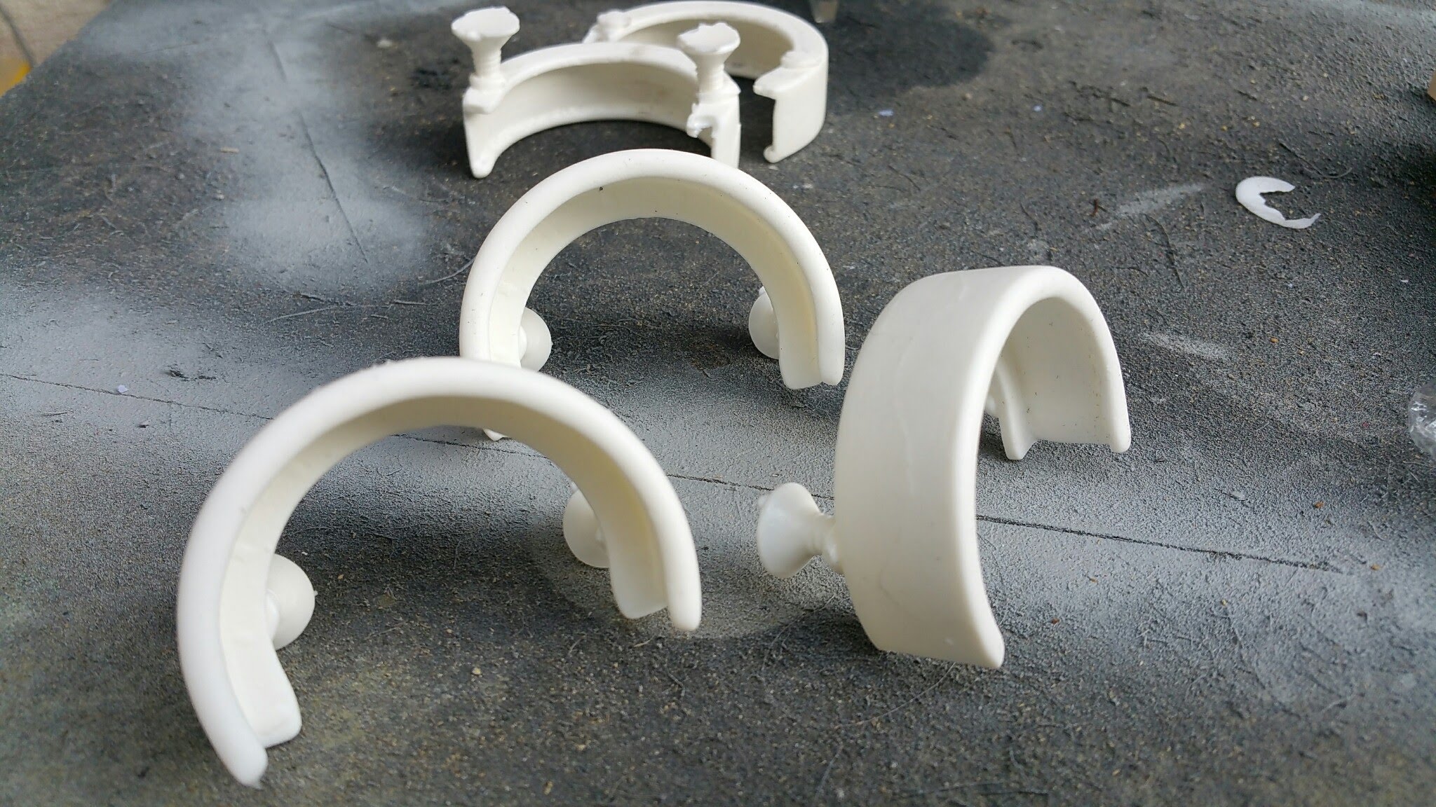

G+_James Hughes Posted November 17, 2017 Author Share Posted November 17, 2017 Just a quick update. I think I found the right mix. I used a resin with a hardness of A60 in a silicone mold from the 3d printed part. I need to put more pigment in if it's going to come out black but I'm super happy with the results. photos.google.com - New photo by James Hughes Link to comment Share on other sites More sharing options...

G+_James Hughes Posted November 21, 2017 Author Share Posted November 21, 2017 Did some more casting yesterday. Going to make another mold from the parts cast so I can make four parts at a time instead of one. Had a few fails but did get four good parts. > Link to comment Share on other sites More sharing options...
