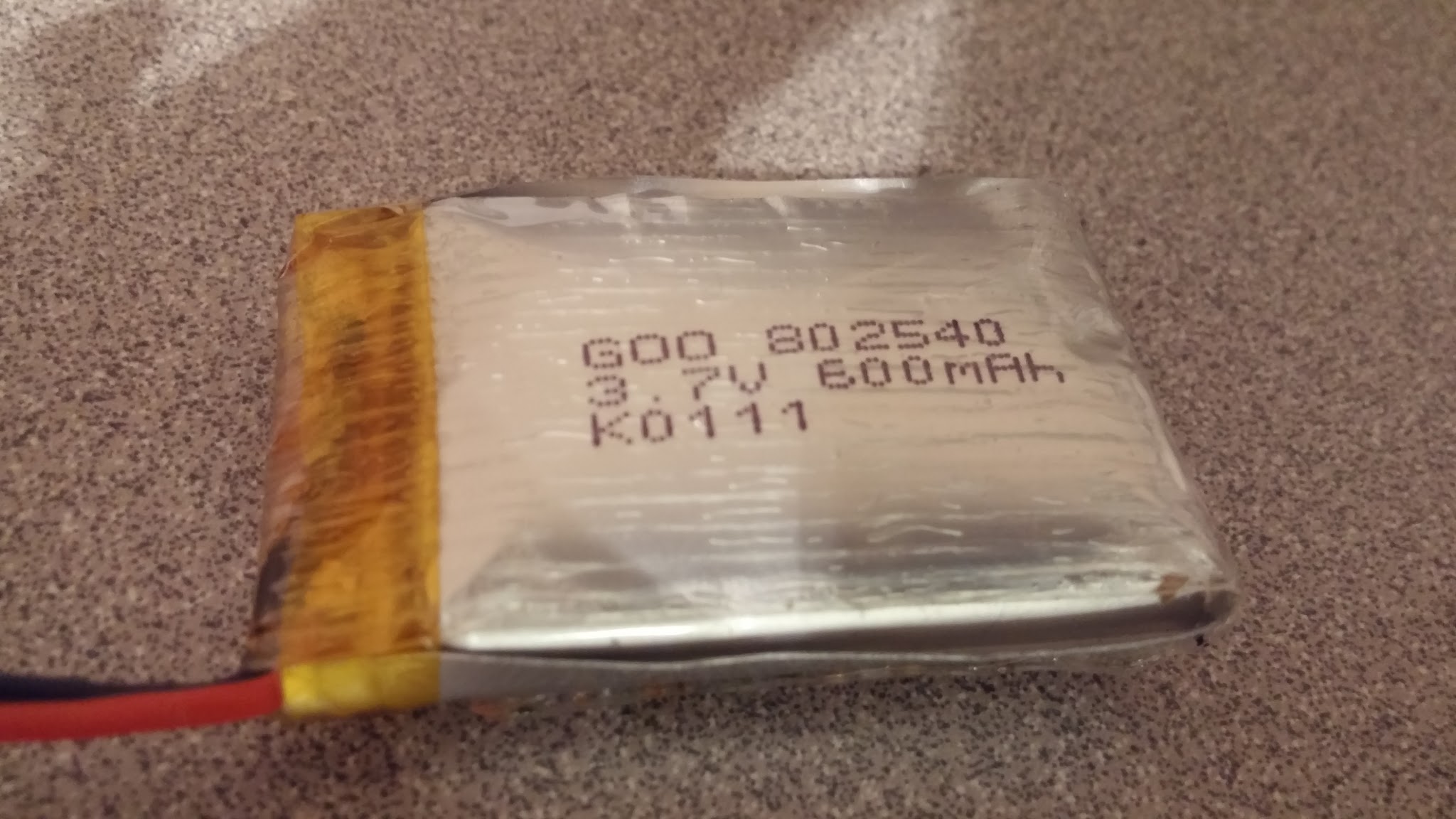

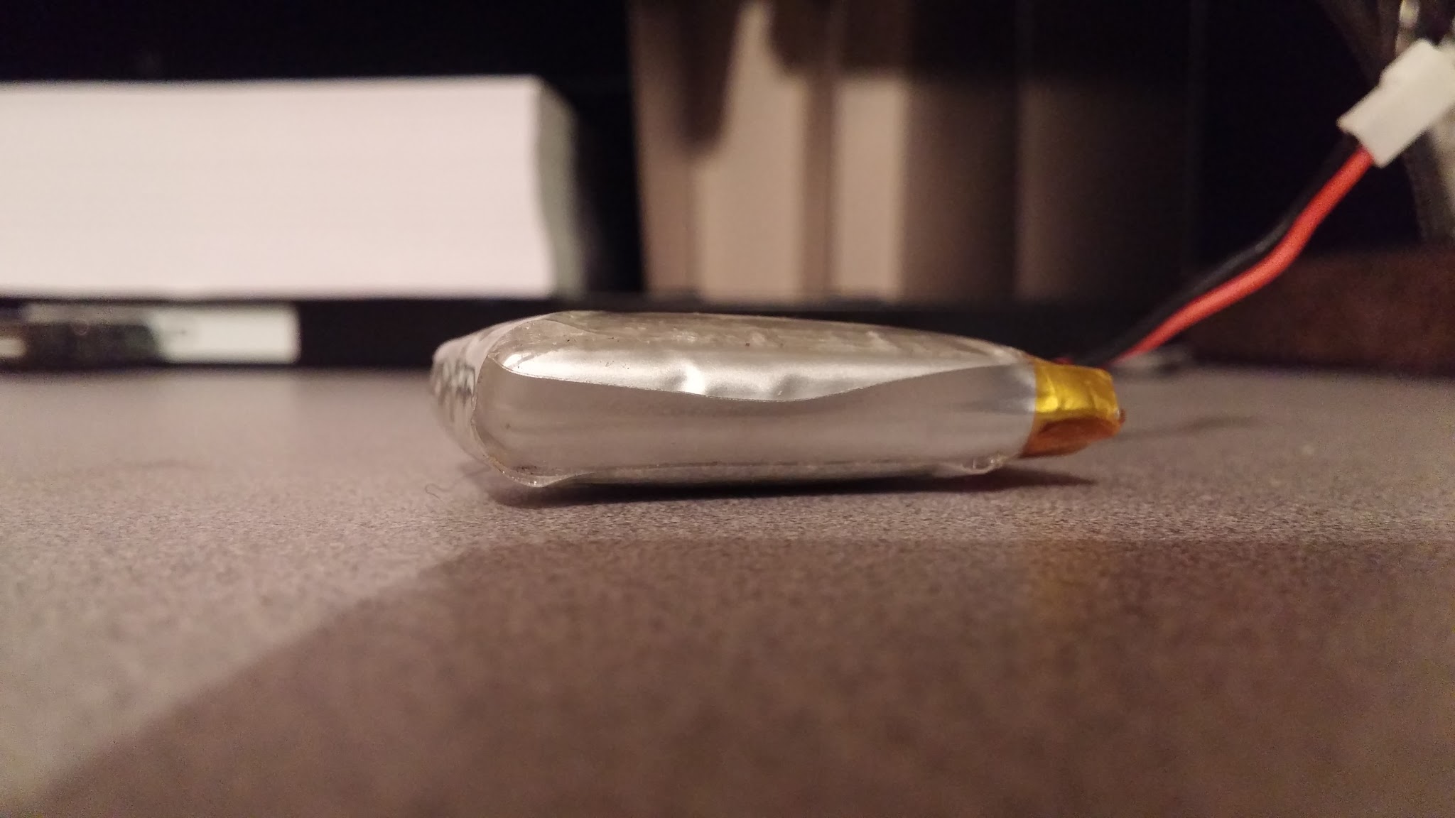

G+_Ed Harvey Posted September 13, 2015 Share Posted September 13, 2015 Is this safe to use? Li-po battery outer case seems to be filled with air? Link to comment Share on other sites More sharing options...
G+_Travis Hershberger Posted September 13, 2015 Share Posted September 13, 2015 I would not trust it. That's classic signs of overheating. Could you use it, probably. Would it start a fire, almost definitely. Link to comment Share on other sites More sharing options...

G+_Ed Harvey Posted September 13, 2015 Author Share Posted September 13, 2015 Thanks everyone! I am glad I checked, when you buy these online they don't provide a lot of details on proper handling and risks. If it wasn't for the show I would have never thought to ask. Link to comment Share on other sites More sharing options...
