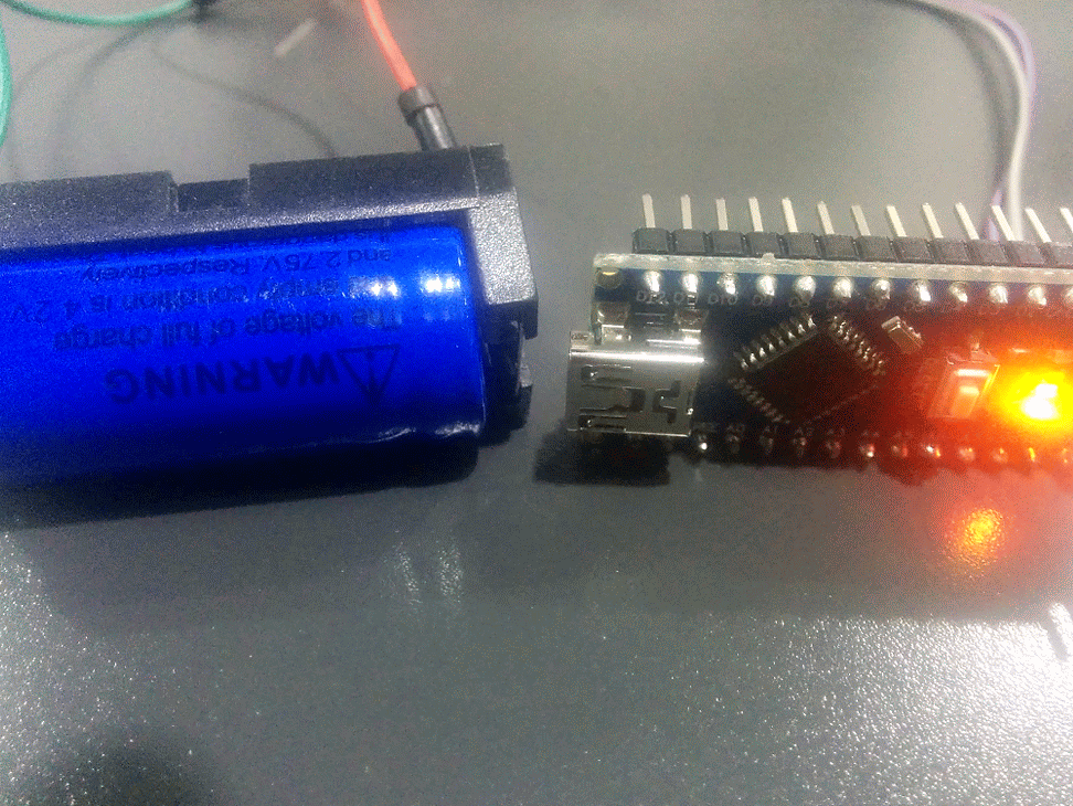

G+_Aye Mossum Posted July 7, 2015 Share Posted July 7, 2015 I've been trying to get an idea of how long an Arduino can run on batteries. I'm trying to get an idea of how many launches I can get on my rocket flight recorder I'm building. Over 20 hours on this (just running a blink sketch) with a 1200mAh battery so far. My recorder will be running on a 130mAh. Anyone know how much juice a microsd card uses? Link to comment Share on other sites More sharing options...
G+_Aye Mossum Posted July 7, 2015 Author Share Posted July 7, 2015 BTW I'll be running at 3.3v and I plan to use a ProMini with the power LED desoldered. Link to comment Share on other sites More sharing options...
G+_Taylor Graham Posted July 7, 2015 Share Posted July 7, 2015 the atmega probably uses >1ma. With everything else on the board, including the LED, maybe 20-30ma. Link to comment Share on other sites More sharing options...
G+_Aye Mossum Posted July 8, 2015 Author Share Posted July 8, 2015 Stopped operating after about 24 hours. My estimate based in the 1200 mAh battery is roughly a 50mA draw. I'll try the experiment again with my ProMini and the sensors I'll be using. I hope to get a couple hours of solid use on my 130mAh battery. Link to comment Share on other sites More sharing options...
