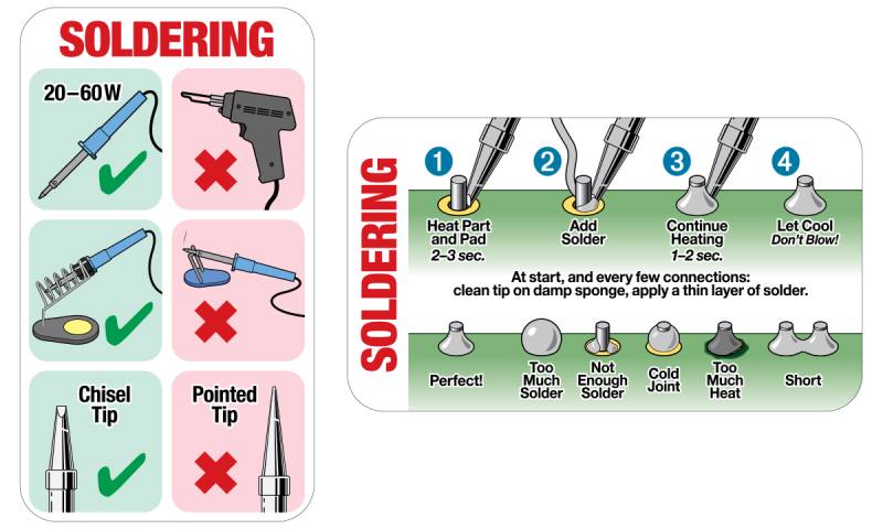

G+_Peter Hanse Posted May 15, 2017 Share Posted May 15, 2017 Just thought I would share this to help with Soldering Originally shared by Gadgetronicx Soldering tips Link to comment Share on other sites More sharing options...

G+_Shooter_FPV (Shooter_FP Posted May 17, 2017 Share Posted May 17, 2017 Thanks for this... I use a pointed tip on my soldering iron, but not anymore... :) Link to comment Share on other sites More sharing options...
G+_Daryl Henderson Posted May 18, 2017 Share Posted May 18, 2017 Great soldering guide. I mainly use a pointed tip as it is better for fine detail work. If you are re-flowing with lead free solder you will need run your iron at around 380°C about 40°C hotter than leaded solder Link to comment Share on other sites More sharing options...
