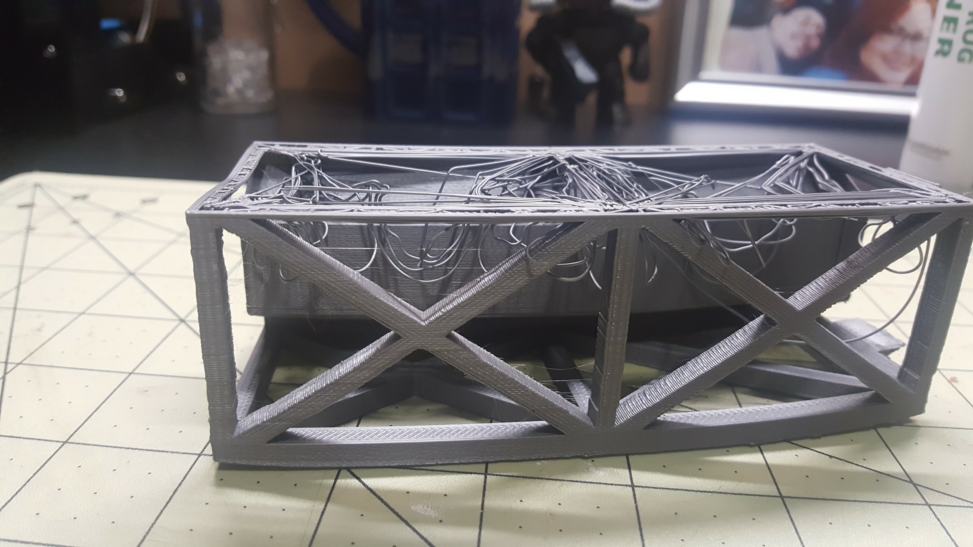

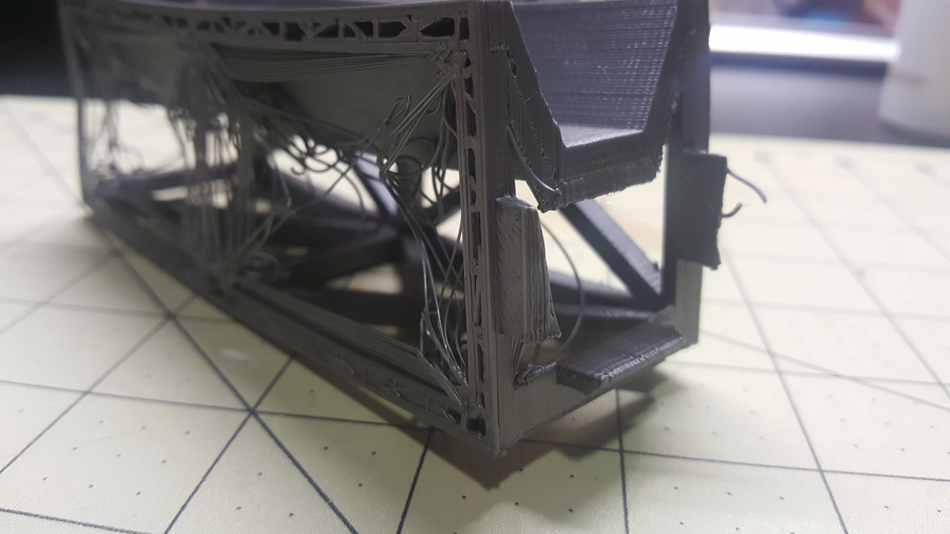

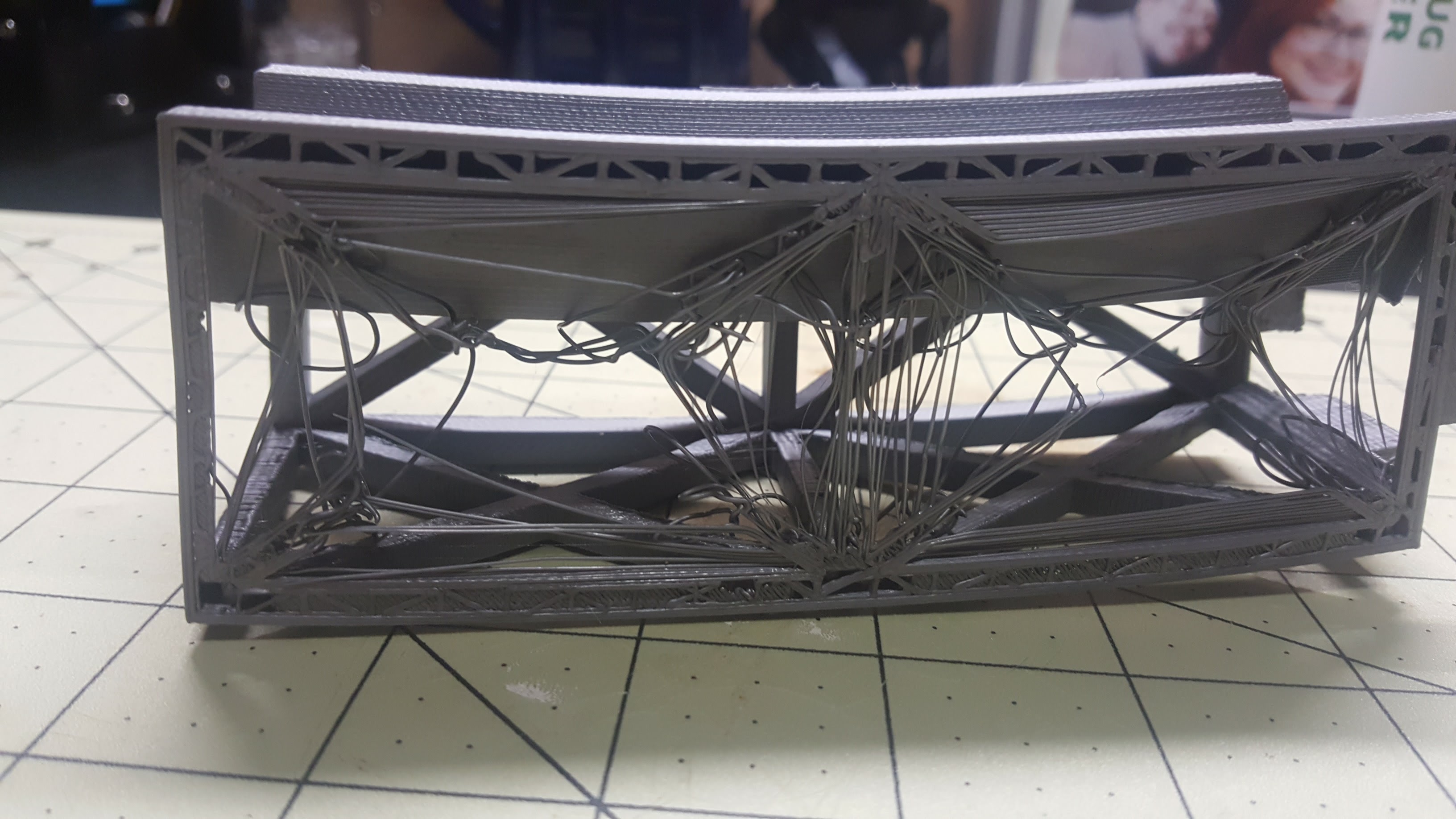

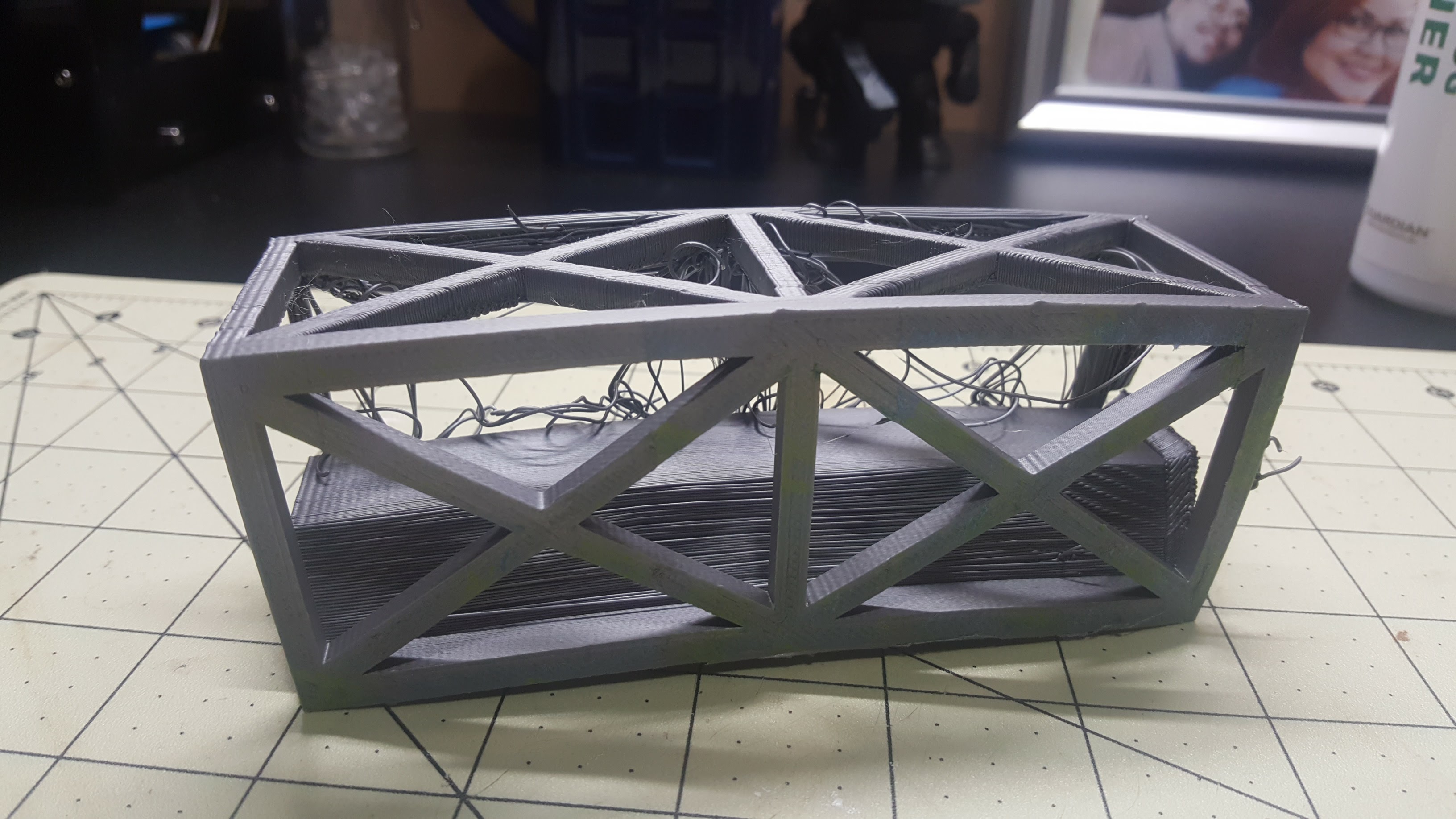

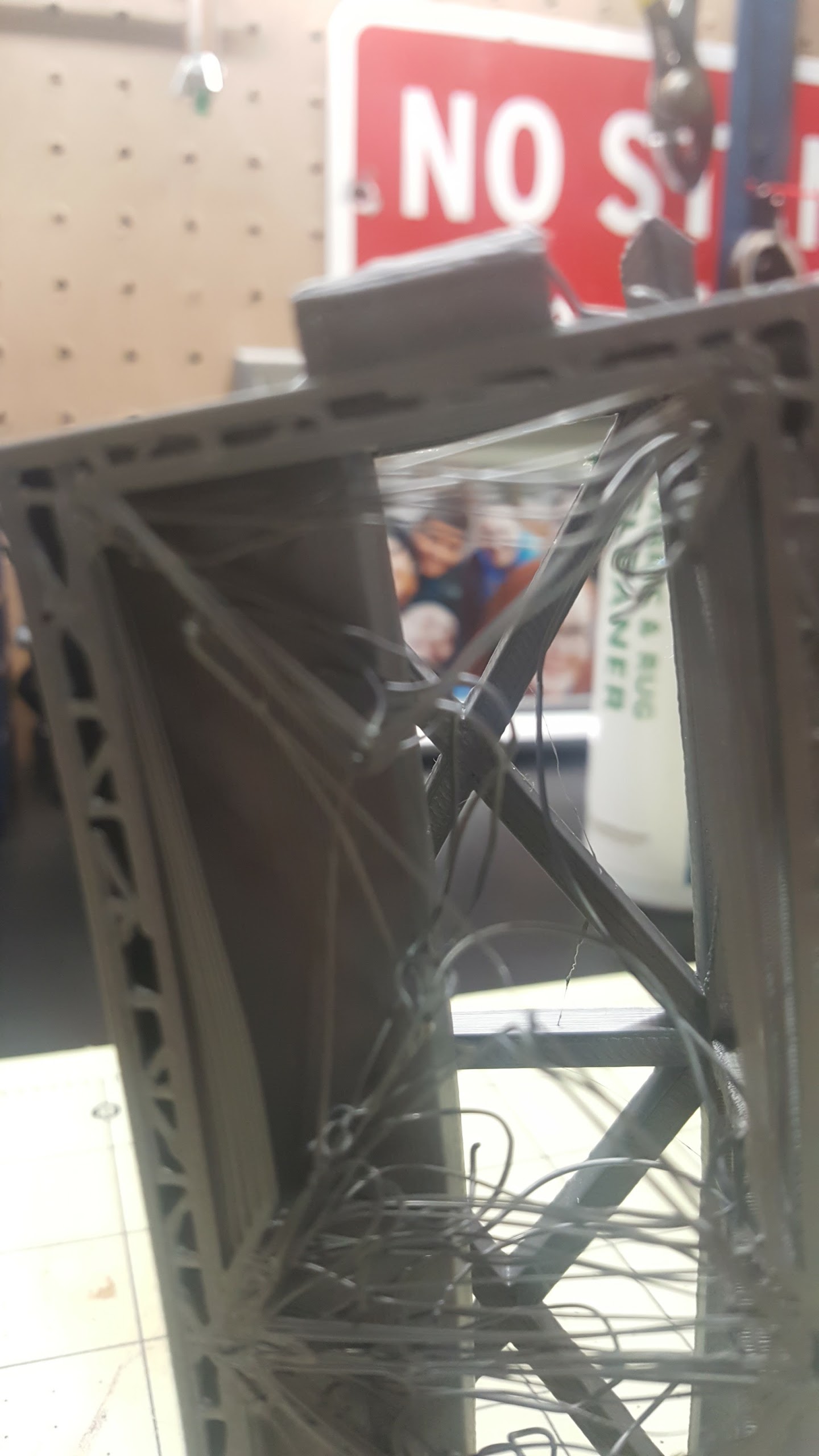

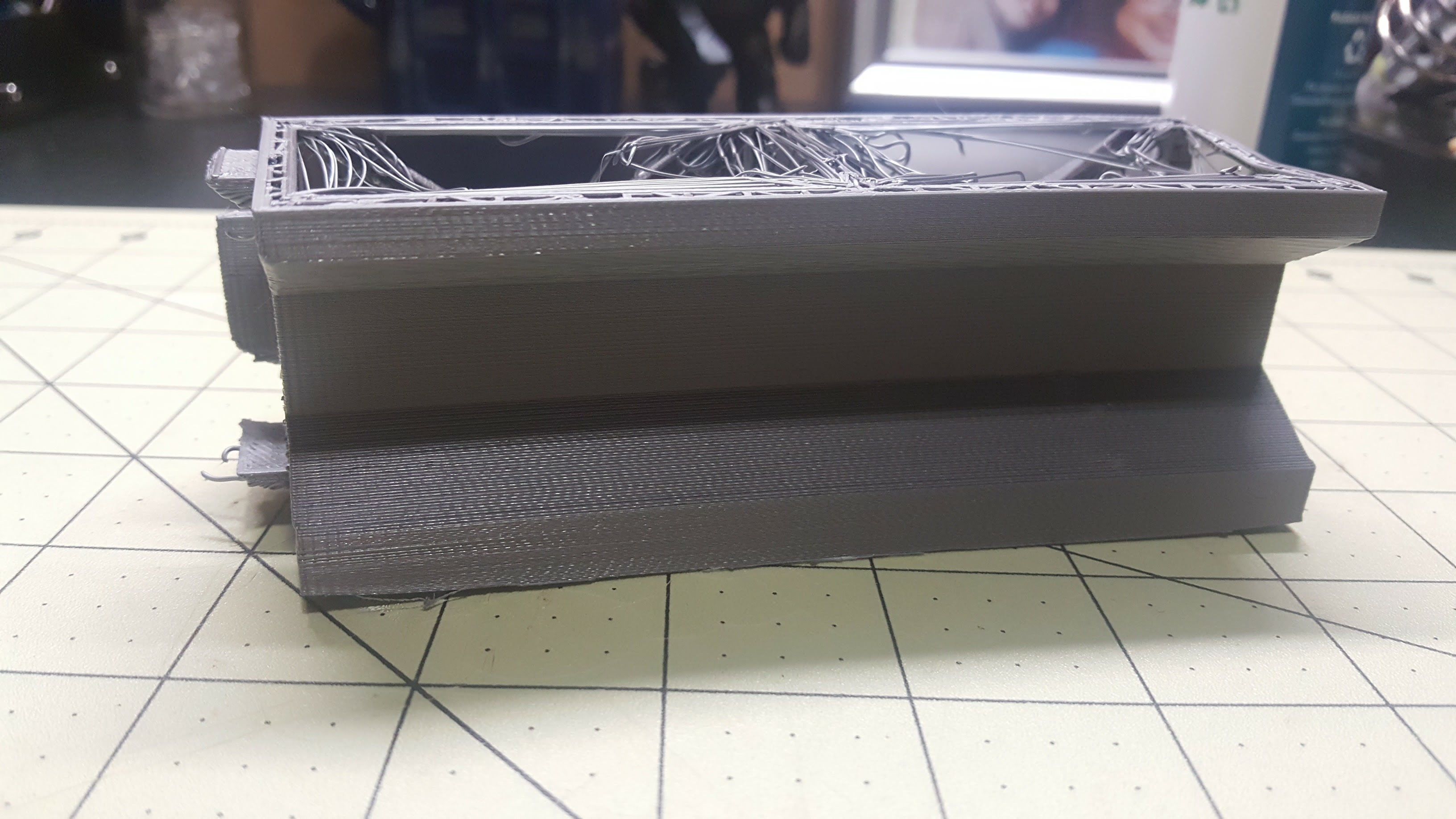

G+_Carlos Velez Posted April 21, 2017 Share Posted April 21, 2017 Hey guys. So I got the maker select v2 based on the shows recommendation and have managed to print out some minor things with it but still learning the ropes. I want to go bigger and I am trying to build an led bridge I downloaded from thingieverse. It's a huge project with lots of parts. As you can see in the pics it started to print out well but screwed up at the last minute (4 hours later). Project requires I print about 16 of these. I know there are ways to identify what I might have setup incorrectly based on how the print job failed but I'm still too knew to identify. Was hoping someone could help. This was printed on pla at 225 temp. Non heated bed. Default speed. Something I recall also reading was projects can fail like this if there are sudden changes in room temperature. Such as turning an ac on or off. It's this true? Link to comment Share on other sites More sharing options...
G+_Tony Martin Posted April 21, 2017 Share Posted April 21, 2017 It is hard to tell from the picture what the problem is but it looks like it missed a step or two. This could be because of a belt slipping or you could need to adjust the pot on the motor driver. Link to comment Share on other sites More sharing options...

G+_Bernard Bout Posted April 22, 2017 Share Posted April 22, 2017 Looking at that photo it also looks like your printer is not bridging well. So what may be happening is that since there does not appear top be any supports, your initial bridging layers are falling off and that could be those strings. You could try rotating the model so that it is vertical and turn supports on in your slicer before printing. Link to comment Share on other sites More sharing options...

G+_Tony Martin Posted May 2, 2017 Share Posted May 2, 2017 Hello again Carlos Velez, The tip on the show about aquanet was very good, it is what I use. I get it from the dollar store for about $3 a can. I do not know if I missed it the first time or if you updated the original post but 225c is to high for most printers printing PLA. On my two printers I print PLA between 190 and 200. The stringing is from poor bridging as Bernard suggested. The lower the temp that you print at the better your bridging will be because at lower temps the filament is stiffer and can cool faster which will let it hold its shape better and sag less. At a certain point the distance between the two sections that you are trying to bridge between can be to large for bridging to work well. That point is different for every printer and filament. When the distance between the two points becomes to large for your printer/filament to handle you have no choice but to use supports to hold up the bridges. If the bridging is on the top of a part adding more layers to the top of the print can also help in some cases because you are building up more material. Lowering the print temp will also help with the bed adheasion that they talked about on the show. There is a fine line between being hot enough to get a good bond between layers and being to hot to get quality prints. Here is some info about bridging from ultimaker. ultimaker.com - Bridging | Ultimaker Link to comment Share on other sites More sharing options...
