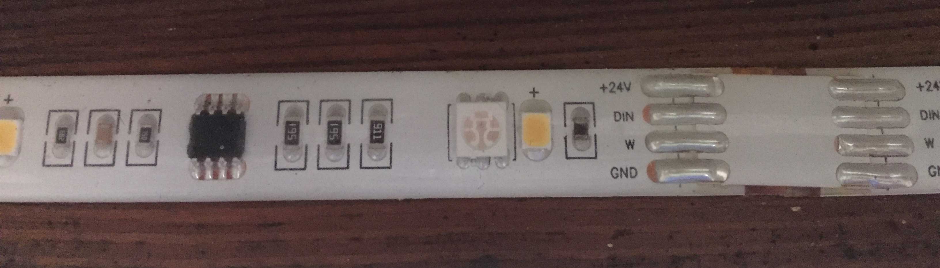

G+_John Stebbins Posted November 24, 2016 Share Posted November 24, 2016 Anybody know the model of this LED Strip? The controller that came with the strip appears to have failed so I want to power it with a Trinket to test the strip. Thank you. Link to comment Share on other sites More sharing options...
G+_Dan Hockey Posted November 24, 2016 Share Posted November 24, 2016 Is there any UL or FCC numbers on the controller? Model # or Serial #? Was it wireless? If so, are there any numbers on the remote? Something that can be Goolged for? If there's nothing on the outside would it be possible to open up the controller to see if there are possibly any markings on the inside? Just some random ideas. Hope this helps. Link to comment Share on other sites More sharing options...
G+_John Stebbins Posted November 24, 2016 Author Share Posted November 24, 2016 It's an IR controller. The LED strip is a ITM/ART 962683. I'm trying to figure out the IC in the strip. I've google the ITM/Art number and it usually goes back to Amazon or Costco for one of the Kits. Thanks for the reply. Link to comment Share on other sites More sharing options...
