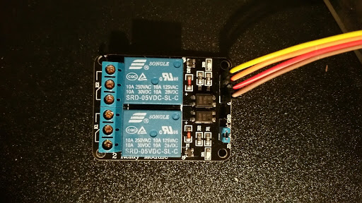

G+_John Saunders Posted December 7, 2016 Share Posted December 7, 2016 Mark Jurisch? This is what I use, cheap and available on Amazon, rated for both AC and DC. Triggered on a LOW input like the example Padre gave. Link to comment Share on other sites More sharing options...

G+_Jason Marsh Posted December 10, 2016 Share Posted December 10, 2016 It really would depend on the loads you're switching on and off with the relays, and the size and length of the leads running to those loads, but for most low-voltage and low-current applications you will be fine with very nearly any switch or relay rated for the amperage and voltage you intend to use, whether that rating is given as ac only or ac + dc. If you look at the common automotive relays available at any auto parts store and all over the internetz, they are built pretty cheaply, but don't erupt into a fireball every time the load is shut off. Link to comment Share on other sites More sharing options...
G+_Jason Marsh Posted December 10, 2016 Share Posted December 10, 2016 Geek out here, find what you want, then google the part number you want and you'll find someone selling them. Note the "Definitions" as it gives a pdf full of very useful information. Their downloadable catalog is chock full of information on relay construction, ratings, etc. as well.... te.com - Relays in Relays, Contactors & Switches Link to comment Share on other sites More sharing options...
G+_Mark Jurisch Posted December 11, 2016 Author Share Posted December 11, 2016 The problem with relays is they have be switched digitally, this doesn't always work. After looking around, I ordered a bunch of these switches which are rated for AC and DC voltages (up to 14v DC) and are $0.75 each. I'm still open to other suggestions if anyone else finds other switches that are reasonably priced and rate for both AC and DC. mouser.com - GRS-4011-1600 CW Industries | Mouser Link to comment Share on other sites More sharing options...
