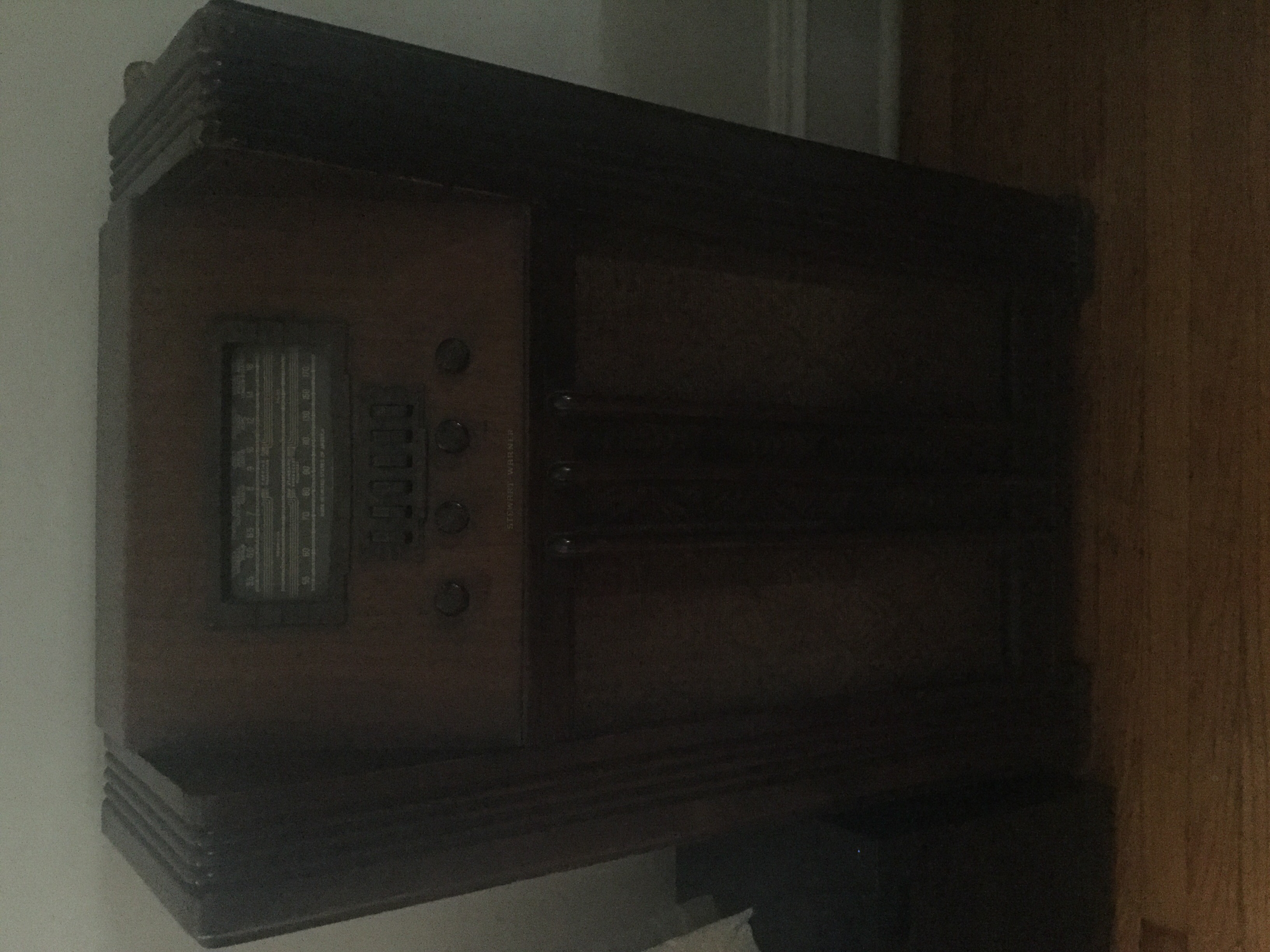

G+_Harry Henze Posted July 28, 2017 Author Share Posted July 28, 2017 Sorry for the quality but this is what I’m working with Link to comment Share on other sites More sharing options...
G+_Black Merc Posted July 28, 2017 Share Posted July 28, 2017 I'm thinking 'antiques road show'... Cannot tell from the darkened picture but, if it is in good or better condition, don't modify it very much, if at all. You may have a piece of history that many don't think much of now days. Link to comment Share on other sites More sharing options...
G+_David Peach Posted July 28, 2017 Share Posted July 28, 2017 For some reason Ben Reese, I don't think it will have a line-in option. :-) I also did an Instructable on how to broadcast via bluetooth and AM transmitter to an old radio like this. No modification of the radio at all. My radio worked fine, so I just had to build a bluetooth to AM transmitter and then tune the radio to the right frequency. It makes the radio into a bluetooth speaker but still gives that warm and scratchy AM sound to the audio. https://www.instructables.com/id/How-to-Add-Bluetooth-to-a-Vintage-Radio/ Link to comment Share on other sites More sharing options...
G+_Harry Henze Posted July 28, 2017 Author Share Posted July 28, 2017 The lights come on but no sound or even static, antique wise it’s worth maybe $70 Link to comment Share on other sites More sharing options...
G+_Black Merc Posted July 28, 2017 Share Posted July 28, 2017 Whatever you do, try your best to keep the outer look as-is. For the nostalgia effect. Link to comment Share on other sites More sharing options...
