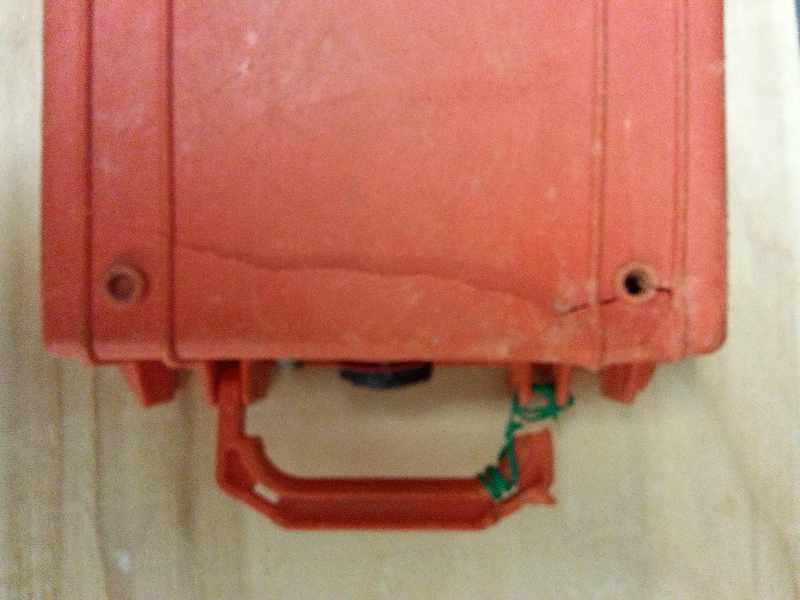

G+_Stephen Hart Posted February 17, 2017 Share Posted February 17, 2017 So - I fixed the handle on the Pelican case with twist-tie wire. For the crack in the bottom - hot glue or 2-part epoxy? Link to comment Share on other sites More sharing options...
G+_Kevin Britain Posted February 17, 2017 Share Posted February 17, 2017 I'd recommend either 2 part epoxy or plastic weld.. Link to comment Share on other sites More sharing options...
G+_Fr. Robert Ballecer, SJ Posted February 22, 2017 Share Posted February 22, 2017 Hmmm... perhaps a doubler? A thin, flat panel of poly past the length of the crack? 2-part epoxy in the crack and on the panel. Link to comment Share on other sites More sharing options...
G+_Jon Klinkefus Posted February 25, 2017 Share Posted February 25, 2017 Too bad the crack goes over the ribs. Hard to seal. Does it need water-tightness? Link to comment Share on other sites More sharing options...
G+_Stephen Hart Posted February 25, 2017 Author Share Posted February 25, 2017 Dust and rain are the concern. It won't be under water. Link to comment Share on other sites More sharing options...
