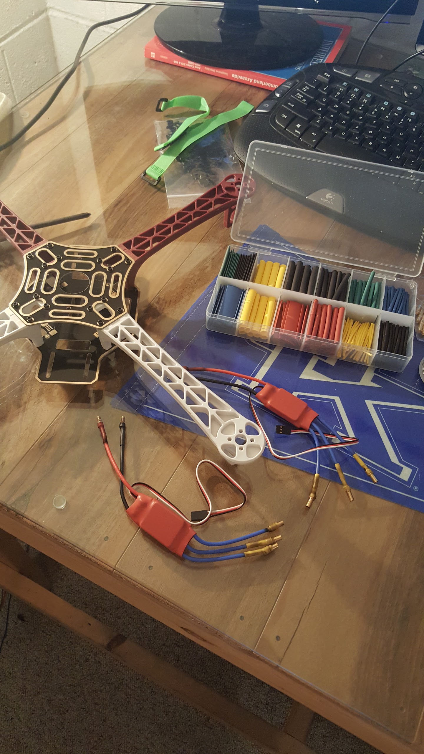

G+_Heath Reeder Posted July 31, 2015 Share Posted July 31, 2015 Got frame together and ends soldier on two esc so far so good as far as I know lol Link to comment Share on other sites More sharing options...
G+_Joshua Delaughter Posted July 31, 2015 Share Posted July 31, 2015 With that frame, the PDB is integrated into the bottom plate in the frame, you could save some space by soldering it directly to there. Bullet connectors do make for great reusability, but there isn't much room to work with on that particular frame. Link to comment Share on other sites More sharing options...
G+_Heath Reeder Posted July 31, 2015 Author Share Posted July 31, 2015 soldering the esc directly to it? trying to find the know how episodes now Link to comment Share on other sites More sharing options...
G+_Joshua Delaughter Posted July 31, 2015 Share Posted July 31, 2015 You didn't buy that frame from the KH episode, the one you have is very close, and a popular style, but not the stretched style Padre used. There is nothing wrong with it, it's just different. Lookup "dji flamewheel build" on YouTube and they'll be plenty of videos on that frame and its PDB Link to comment Share on other sites More sharing options...
G+_Heath Reeder Posted July 31, 2015 Author Share Posted July 31, 2015 pretty sure thats the one that was linked to, cause when ordering i went thru the parts list opened links and added to my wish list, might be possible that i seen one that looked the same that was prime i guess but not sure, also jsut noticed from padres video when puttin heat shrink on i didnt cover as much of the bullet as he did, female end mainly Link to comment Share on other sites More sharing options...
G+_Heath Reeder Posted July 31, 2015 Author Share Posted July 31, 2015 i guess i may need to redo that Link to comment Share on other sites More sharing options...
G+_Heath Reeder Posted July 31, 2015 Author Share Posted July 31, 2015 Joshua Delaughter i just checked and that is the same one linked to in parts list on episode 115 http://www.amazon.com/gp/product/B00ATLP6WM/ref=oh_aui_detailpage_o08_s01?ie=UTF8&psc=1 not htat it matters but was just checking lol Link to comment Share on other sites More sharing options...
G+_Joshua Delaughter Posted July 31, 2015 Share Posted July 31, 2015 There were 2 build lists iirc, and I think one may have had that one, and another had the stretched one. Also, Amazon will sometimes redirect to another product if a link was stale as well. Either way, it's all gravy, they're both good frames, just you have the option to use the integrated PDB or your own, but with that smaller frame, you might not have much room for batteries if you don't use the integrated board. Link to comment Share on other sites More sharing options...
G+_Heath Reeder Posted July 31, 2015 Author Share Posted July 31, 2015 oh ok, yea i used the list in the show notes, didnt even know there was another, Link to comment Share on other sites More sharing options...
G+_Heath Reeder Posted August 2, 2015 Author Share Posted August 2, 2015 Joshua Delaughter hey joshua im trying to figure out my power situation now, i think i am going to solder to the board like you mentions, im just nor sure how to do it, there arnt any hole in the board, so do u just put the wire over the gold spot, and then melt the solder over the wire onto the board? Link to comment Share on other sites More sharing options...
G+_Joshua Delaughter Posted August 2, 2015 Share Posted August 2, 2015 Correct, again, countless videos. Look for dji f450 build videos on YouTube. Link to comment Share on other sites More sharing options...
G+_Heath Reeder Posted August 2, 2015 Author Share Posted August 2, 2015 Thank you good sir Link to comment Share on other sites More sharing options...
