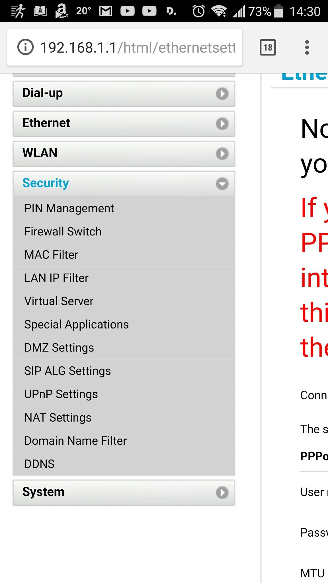

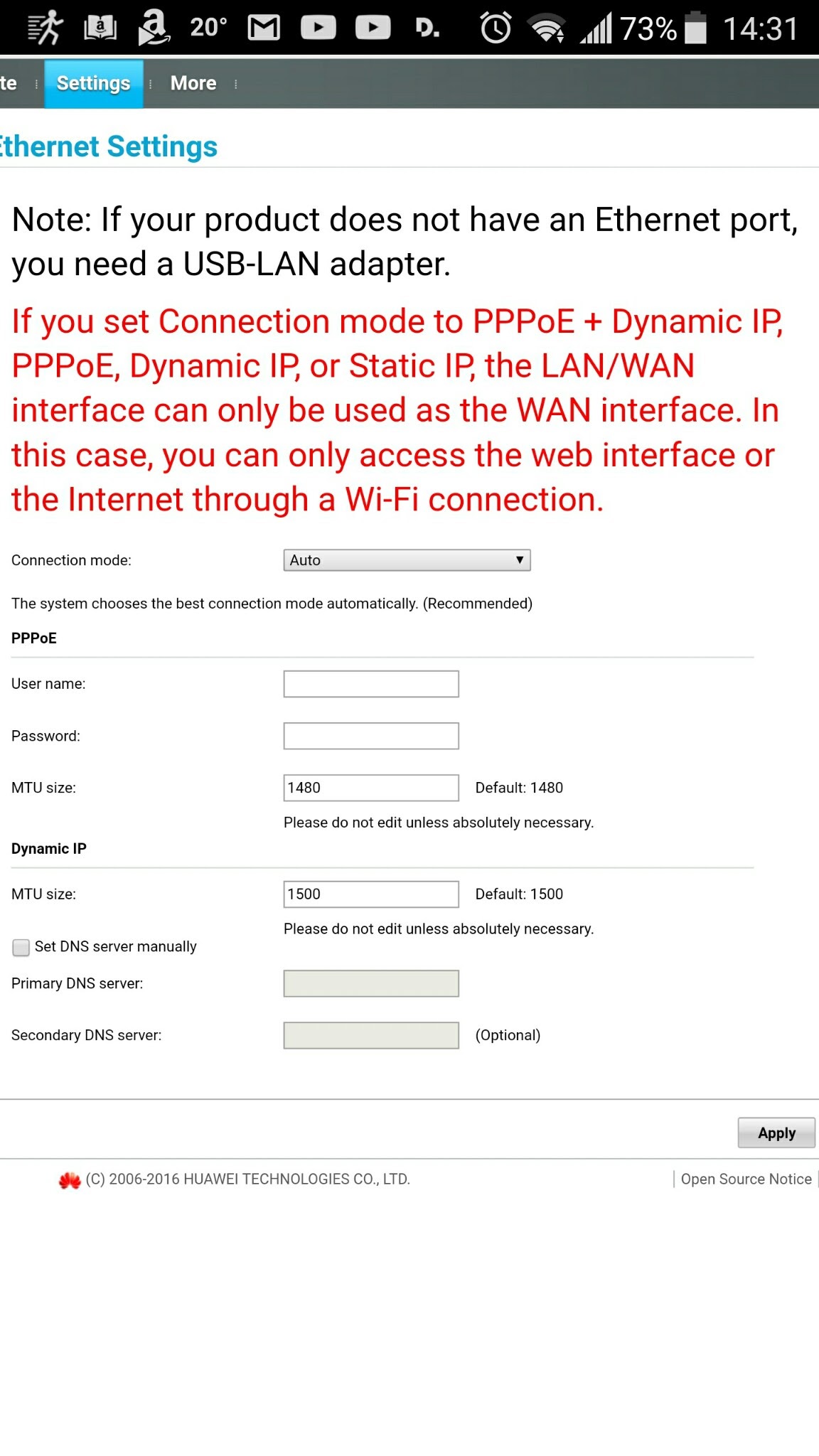

G+_Darren Lomax Posted July 8, 2017 Author Share Posted July 8, 2017 These are the only settings I think an option for vlans would be. Link to comment Share on other sites More sharing options...

G+_Darren Lomax Posted July 8, 2017 Author Share Posted July 8, 2017 The router has only 1 Ethernet port. So that goes into the switch, I've set up 2 vlans and when I need internet on which ever device I just change the routers port no. To what ever network I need. Its a bit of a pain but it'll do for now.thanks for your help. Link to comment Share on other sites More sharing options...
