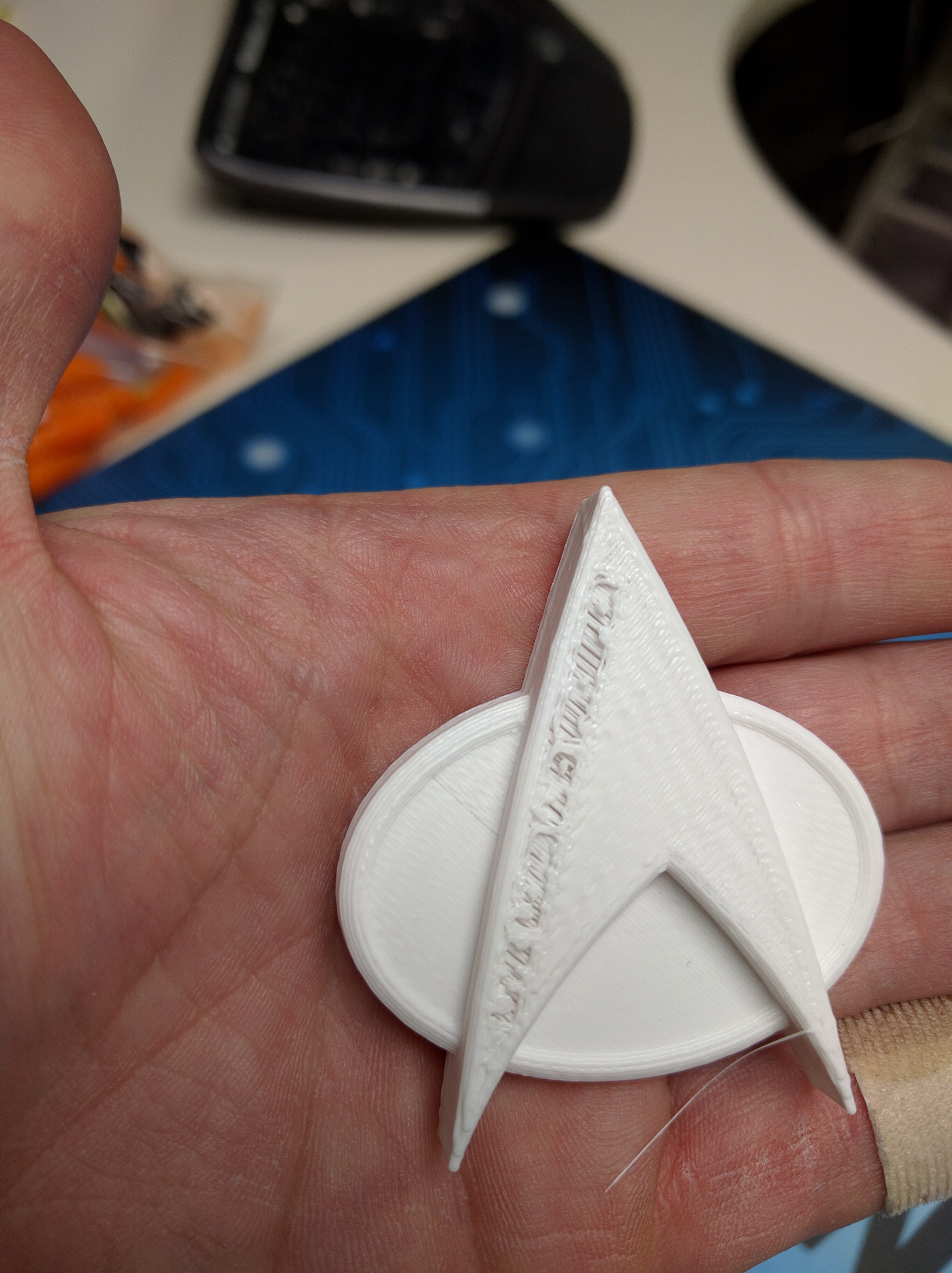

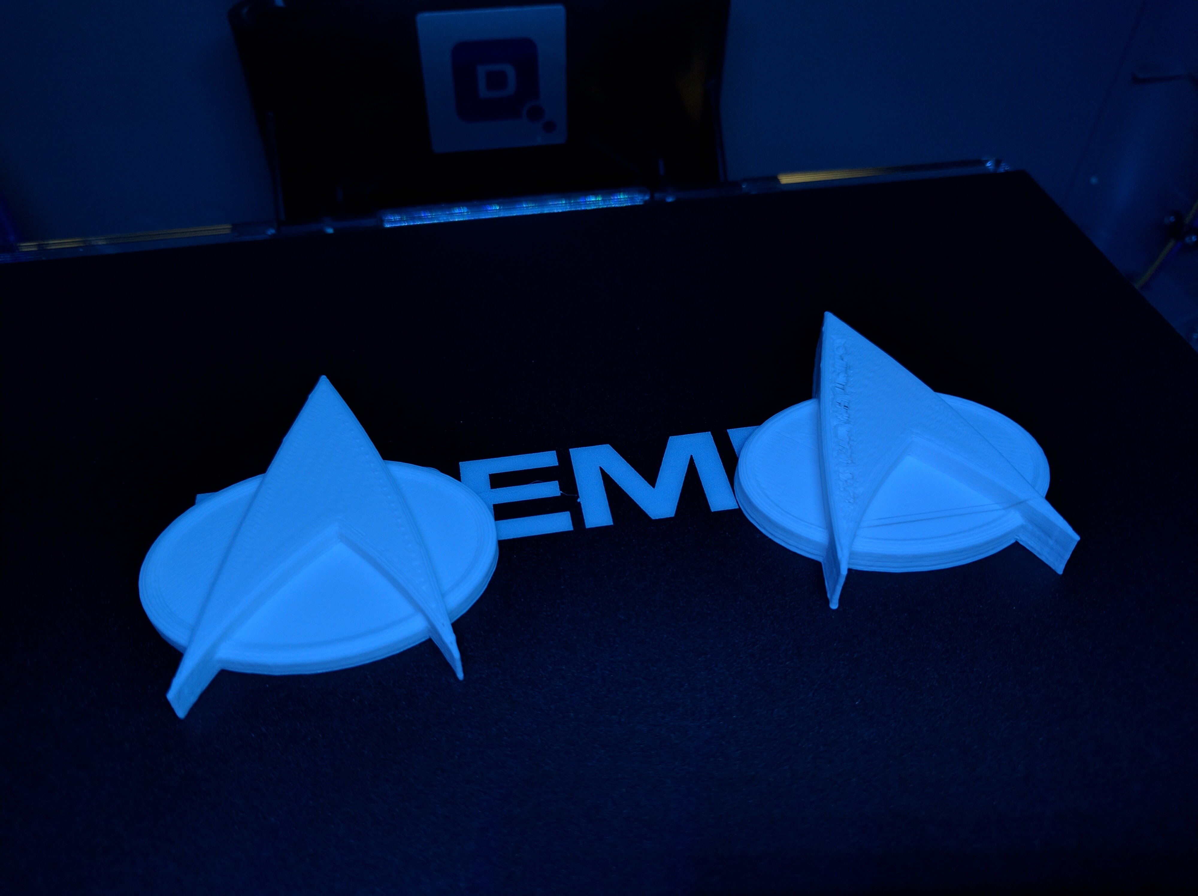

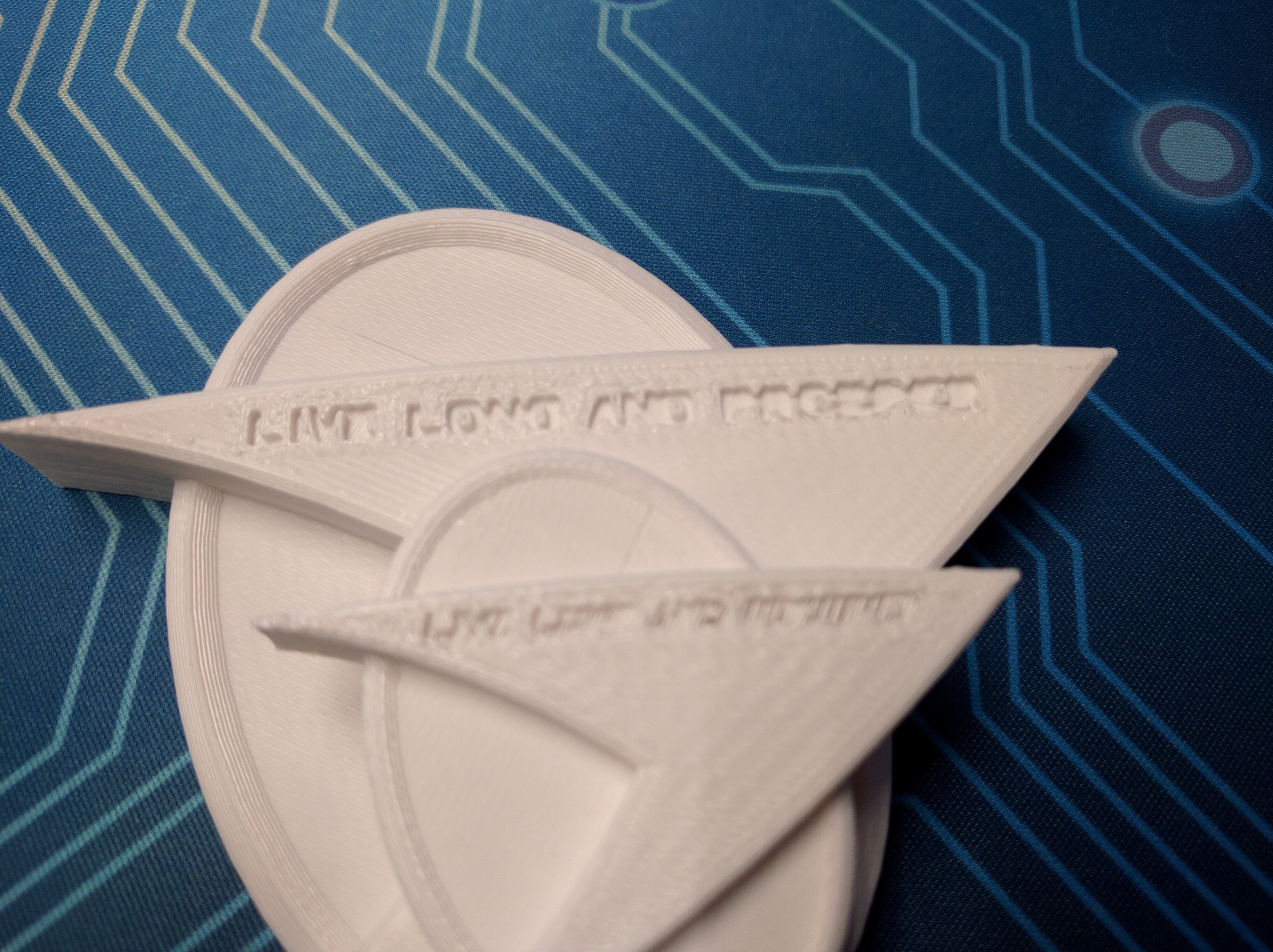

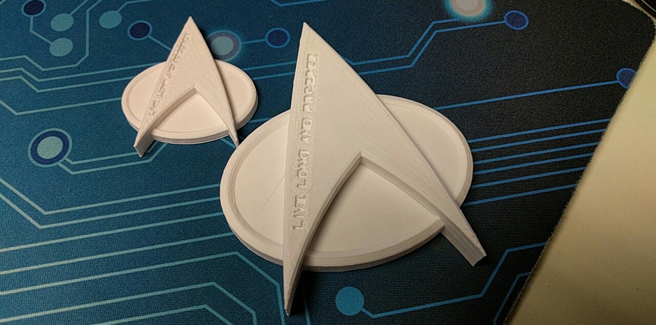

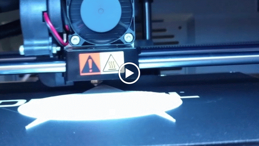

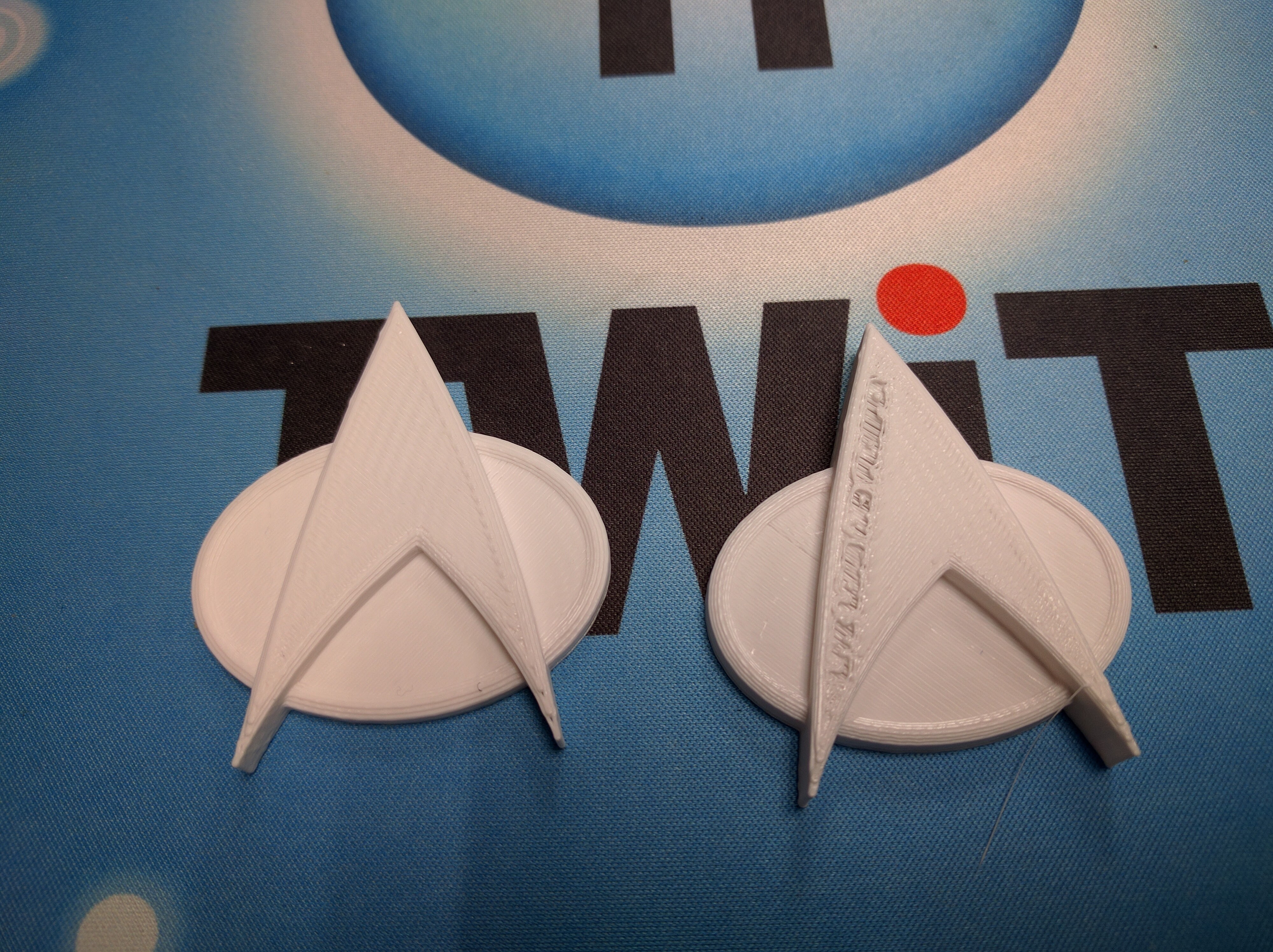

Here are some samples from the Dremel 3d Printer that arrived this week. After reading a ton of articles and horror stories about these type of printers, I was expecting a pile of goo instead of what I designed. This printer seems super simple to setup and get going without much fuss at all, except for missing parts that I have talked about before. Attached are some photos. I printed two prints, in different sizes. Trying to experiment with text go get text to print out more clear. I have a feeling FONT choices are critical. Let me know what everyone thinks. I will be using this printer pretty heavily this week to see how it hold up.

Have fun!!  All the possibilities you now have.
I typically undersize holes 0.1mm then clean out with a drill bit, if I need a quality hole.
Make a dovetail test set.  Best way to tweak your setting to get parts to fit right.
Just don't fall into the trap of printing stuff that can be easily made quicker, cheaper, easier otherwise (or bought for cheap)  I've seen too many little square boxes/bins and such on Thingiverse that are just pointless.
