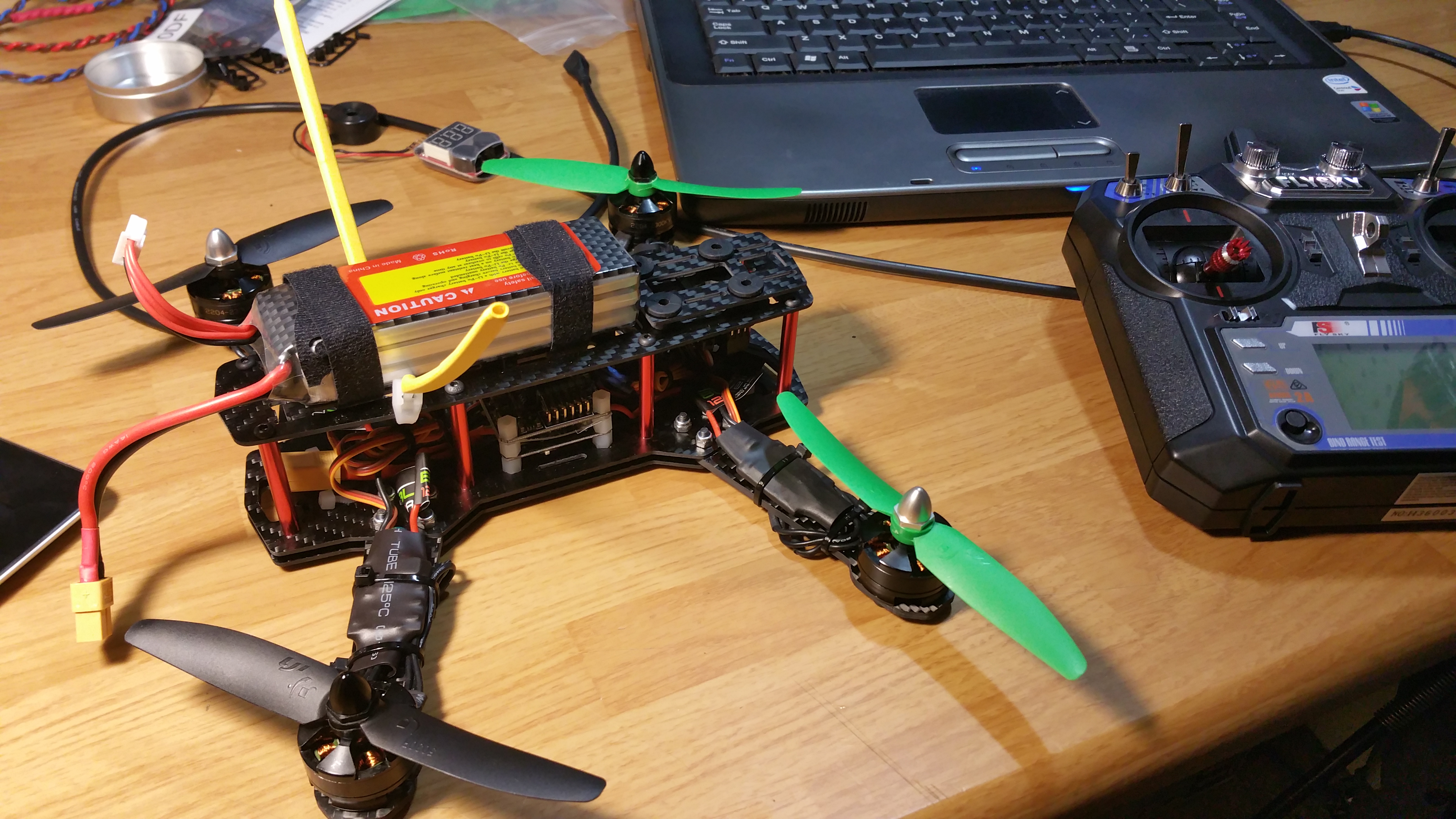

G+_Carlton Dodd Posted November 20, 2015 Share Posted November 20, 2015 I finished my ZMR250 build, and it flies! I was worried about the huge battery, but this thing has tons of power. On the test flight, it drifted pretty badly to the left, and slightly to the rear. I'll have to figure that part out. It's VERY sensitive on the controls! Any tips on best flight mode and/or Naze32 settings for a beginner? Link to comment Share on other sites More sharing options...
G+_Carlton Dodd Posted November 20, 2015 Author Share Posted November 20, 2015 Turns out my workbench (where I did the accelerometer calibration) is a few degrees off level. Leveled out a plate, and calibrated on that, and it flies pretty well. I think it needs a pilot upgrade, though. Link to comment Share on other sites More sharing options...
