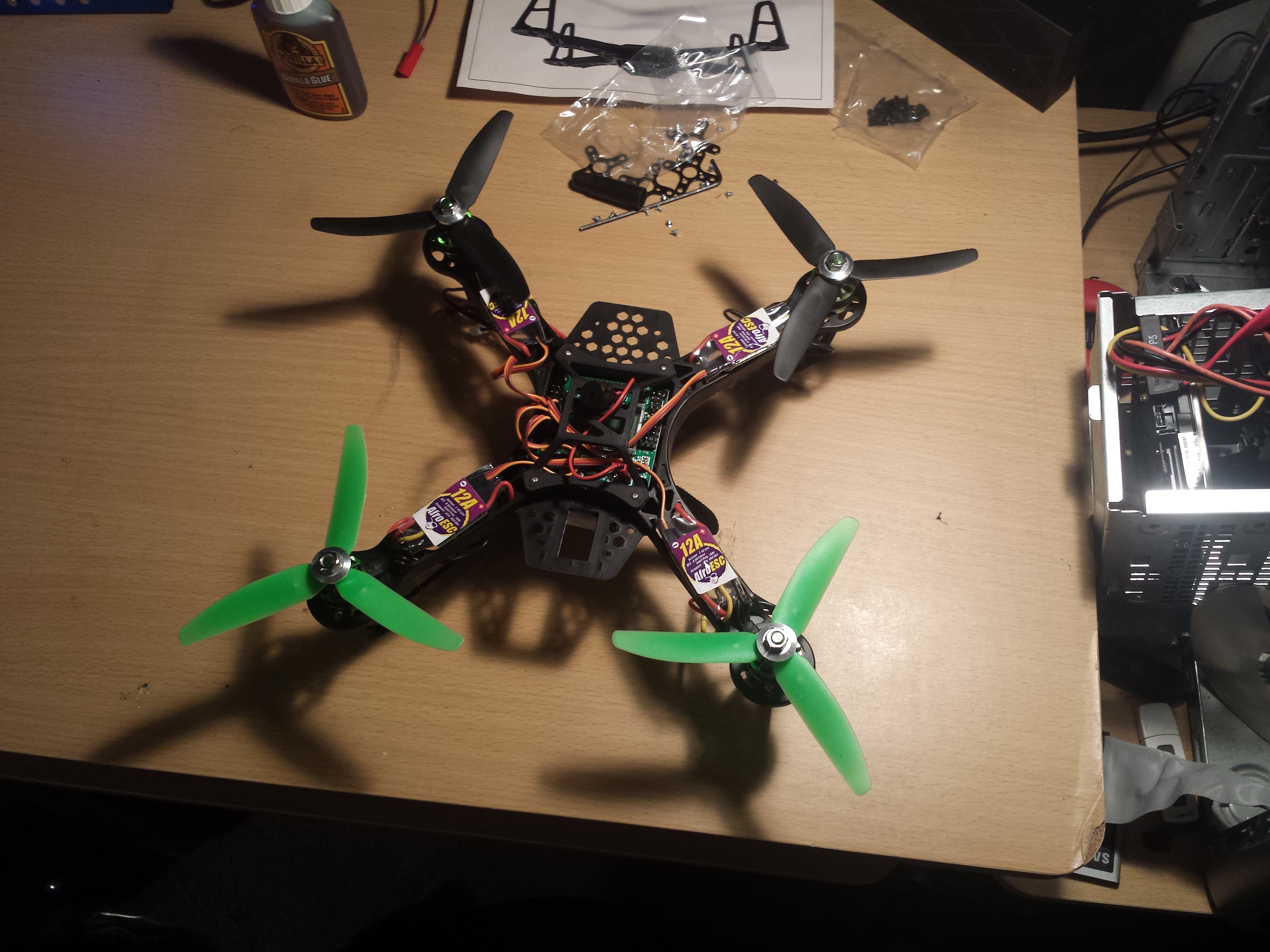

G+_MyTmou5 Posted February 12, 2015 Share Posted February 12, 2015 My fpv250 came in today. Still waiting on the Tx/Rx Link to comment Share on other sites More sharing options...
G+_Fr. Robert Ballecer, SJ Posted February 13, 2015 Share Posted February 13, 2015 Woot! 2 things though... 1. Your props are reversed. 2. You also may want to consider using the green ones on the rear. (Easier to see... Easier to keep your "nose out" orientation.) Link to comment Share on other sites More sharing options...
G+_MyTmou5 Posted February 13, 2015 Author Share Posted February 13, 2015 Yeah, I just put the props on there for the picture. Without the Tx/Rx, I can not test the motors for rotation. Link to comment Share on other sites More sharing options...
G+_Wayne Black Posted February 13, 2015 Share Posted February 13, 2015 Sucks, when the only thing you can do till you get the TX is run around, holding it up in the air and making wrrrrrrring noises! The Padre is right. The leading edge of the props should spin in toward the body. As it is now she'll be eating magma! Link to comment Share on other sites More sharing options...
G+_MyTmou5 Posted February 13, 2015 Author Share Posted February 13, 2015 Lol I actually did that as I was going to other part of the house to show my 2 boys? Link to comment Share on other sites More sharing options...
