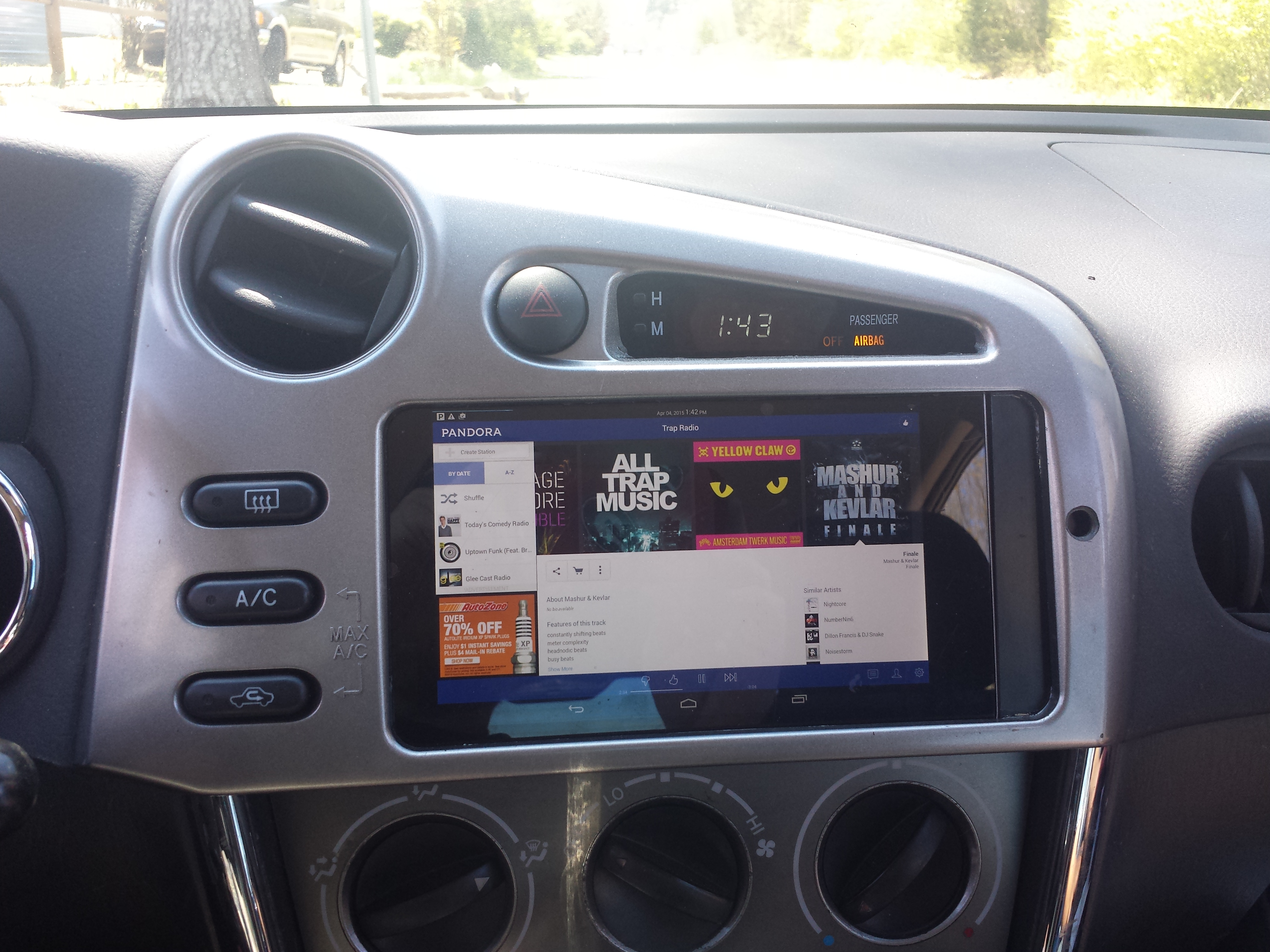

G+_MyTmou5 Posted April 4, 2015 Share Posted April 4, 2015 Originally shared by MyTmou5 Finally finished my tablet stereo integration. Look awesome Link to comment Share on other sites More sharing options...
G+_Paul Miller Posted April 4, 2015 Share Posted April 4, 2015 What tablet is that? Does it have LTE our do you tether to a phone or MiFi? Link to comment Share on other sites More sharing options...
G+_Jason Perry Posted April 4, 2015 Share Posted April 4, 2015 Looks nice. Is that the original opening for the radio or did you have to modify it? Link to comment Share on other sites More sharing options...
G+_MyTmou5 Posted April 4, 2015 Author Share Posted April 4, 2015 The tablet is a 1st gen Nexus 7. I'll be using my phone for data via WiFi or Bluetooth tethering. If you'll look just right of the tablet, there is a small vertical piece of plastic I made to fill a opening that the tablet didn't cover. That, along with a little cutting out the backside of the stereo bezel plus some zip ties is all had to do to get the tablet to fit?. Link to comment Share on other sites More sharing options...
G+_Ken Varanelli Posted April 5, 2015 Share Posted April 5, 2015 Looks Great, Andy. I have been wanting to do this for a while. Eventually using a GPS module, FM radio module and a Bluetooth or WiFi connected OBD sensor for getting car info. How did you connect the tablet to the stereo system? Link to comment Share on other sites More sharing options...
G+_MyTmou5 Posted April 5, 2015 Author Share Posted April 5, 2015 It's connected via the headphone jack and head unit has a rear line in input Link to comment Share on other sites More sharing options...
