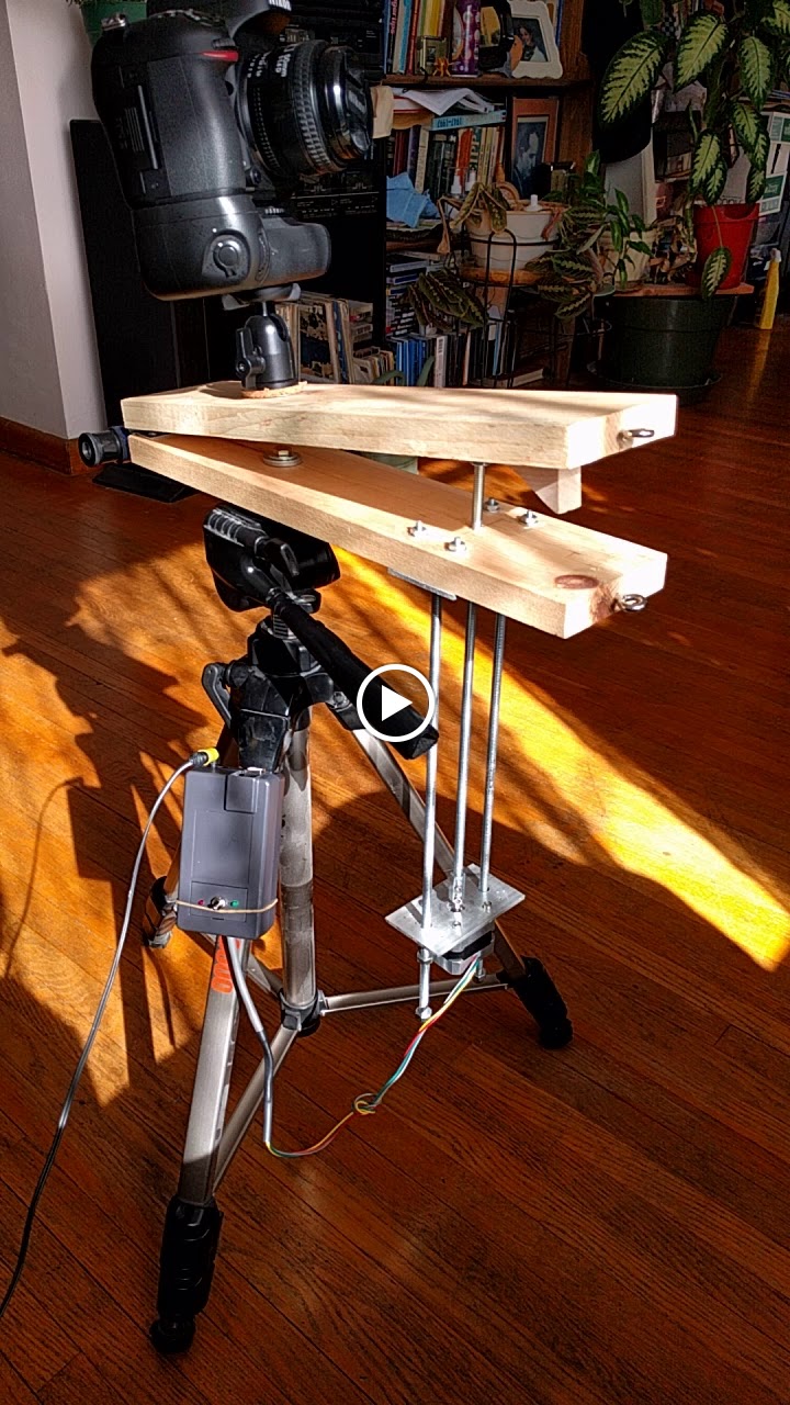

G+_Dominick Valentic Posted November 5, 2016 Share Posted November 5, 2016 You can't hear it but if you look at the connection to the stepper you can see it ? After everyone's help on how to wire it and that first episode on the Arduino a couple of weeks ago I finally have it running.... Other than a few tweaks all I need is clear, windless night (one that hopefully isn't freezing) to take it out for a test run Fr. Robert Ballecer, SJ? Link to comment Share on other sites More sharing options...
G+_David Wiggins Posted November 5, 2016 Share Posted November 5, 2016 That is a beautiful piece of work. Well it be smooth enough for long exposure shots? Link to comment Share on other sites More sharing options...
G+_Dominick Valentic Posted November 5, 2016 Author Share Posted November 5, 2016 David Wiggins only one way to find out ? I'm planning on putting some plastic grommets in the guide holes for the two threaded bars... Every so often you can kind of hear the plate rattle against them as the motor turns... I'm guessing it's because I can't quite get the shaft of the motor and the threaded rod to match up in a straight line and the edge of the plate catches ever so slightly on the guide rods Link to comment Share on other sites More sharing options...
G+_David Wiggins Posted November 5, 2016 Share Posted November 5, 2016 I am totally thrilled for you. I'll be praying you get some clear skies and can share some photos I can enjoy. Link to comment Share on other sites More sharing options...

G+_Michael Gates Posted November 9, 2016 Share Posted November 9, 2016 This is quite cool. Was it a project on TWiT Know How? I built a manual one nearly 30 years ago that I would give one full revolution per minute by hand. Here's a shot of it from a slide: https://drive.google.com/open?id=0B5qBVYNgUPLZY25wSlNKSXlPNDA . Once had a woodrat eat through my shoelace while I was halfway through an exposure. 8^) It was a tedious process. If I ever get back to the fire lookout, I'd love to try putting one like yours together. Have you thought about mounting a green laser pen on the hinge axis to point to the North Star? drive.google.com - Mikey at Saddleback w Tripod and Star Tracker FujiChrome June 1988 Crop.jpg - Google Drive Link to comment Share on other sites More sharing options...
