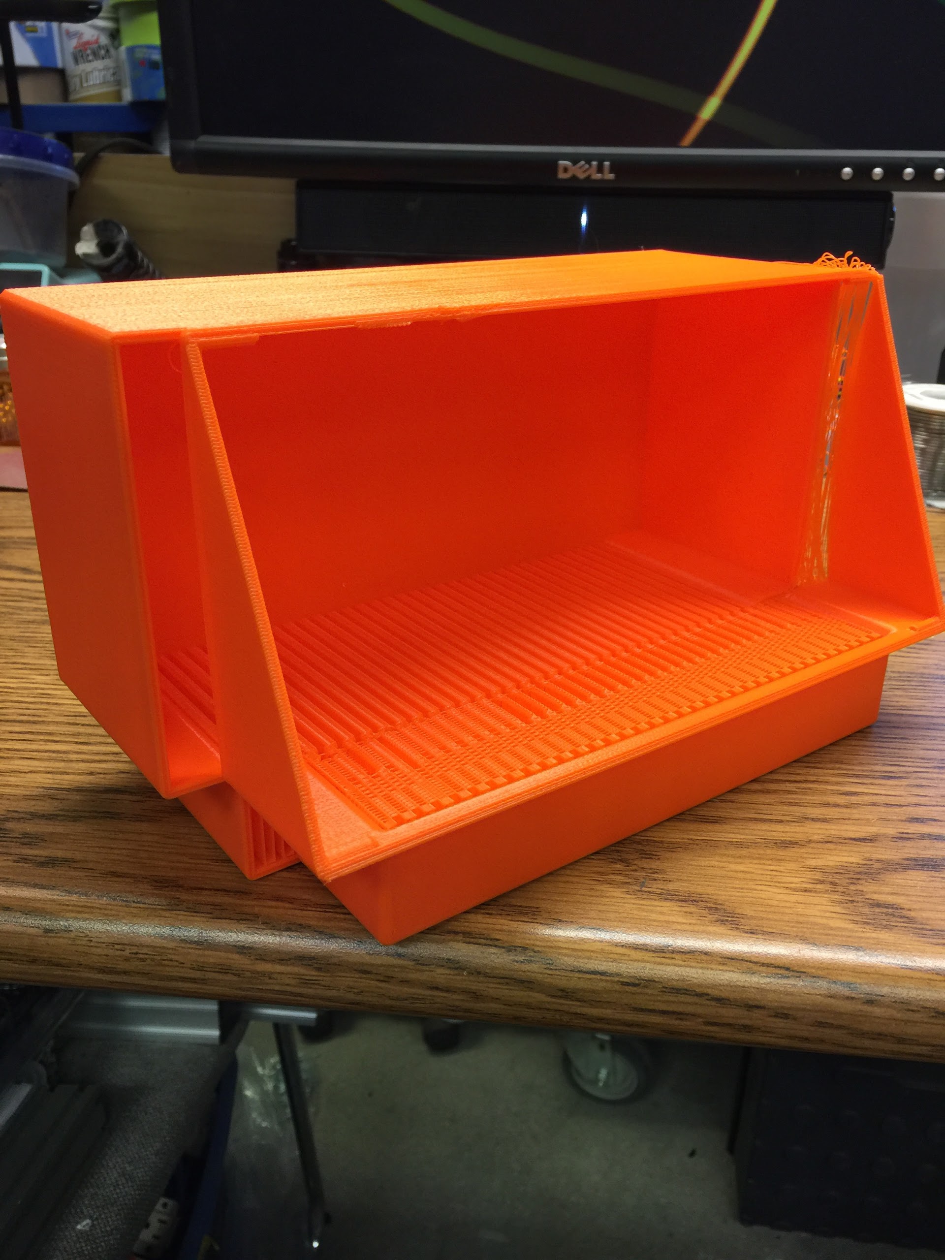

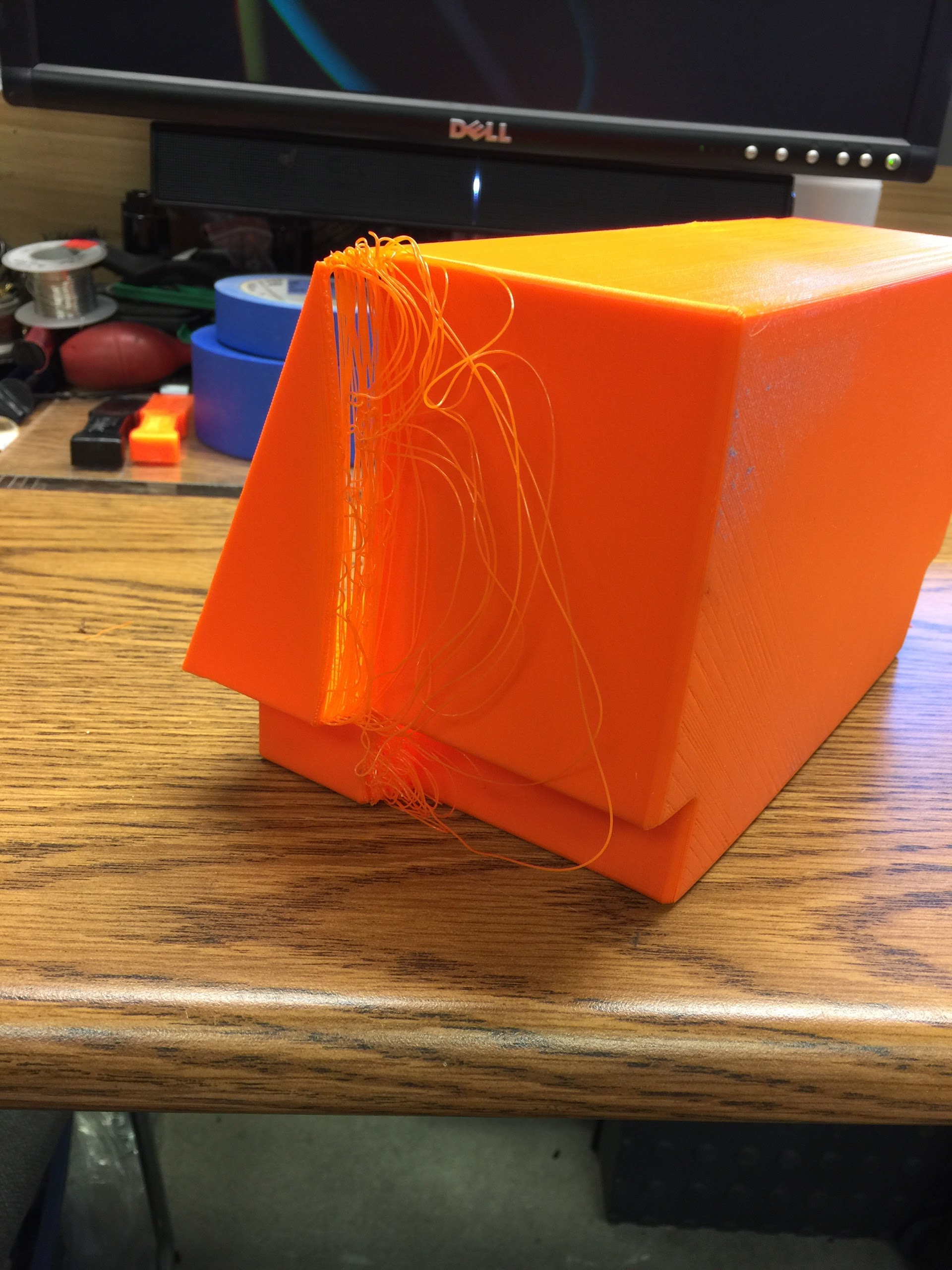

G+_Mark Vogt Posted May 15, 2016 Share Posted May 15, 2016 I'm a newbie to this forum and I really appreciate all the information on it. After starting a 3D print 24 hours ago I went to my backyard shop to check it this morning, this is what I found, it really sucks when your 3-D printer skip steps. I need to check the G code to make sure didn't slice funny either way I guess I'm starting over. Link to comment Share on other sites More sharing options...
G+_Mark Vogt Posted May 15, 2016 Author Share Posted May 15, 2016 Hi James I'm using a simple metal Printrbot with an extended X axis sliced it with Cura and the print is 10 x 6 x 6 printed it 100% Phil Link to comment Share on other sites More sharing options...
G+_Eddie Foy Posted May 15, 2016 Share Posted May 15, 2016 Is it turned on its side from print orientation? kinda looks like it. If so looks like the X or Y didn't move at one layer causing it to shift. (gotta love open loop, huh?) Link to comment Share on other sites More sharing options...
G+_Mark Vogt Posted May 16, 2016 Author Share Posted May 16, 2016 This was printed on the back that why you can see the supports on the bottom. Yes Eddie I agree with you I wish someone would make a closed loop 3-D printer system that wasn't 20 K, I guess having to reprint and pay a little more for filament justifies the low price of the printer. Link to comment Share on other sites More sharing options...
G+_Eddie Foy Posted May 16, 2016 Share Posted May 16, 2016 Make sure the belts aren't too tight, and the ways are clean and lubed. Push by hand and make sure they run smoothly. (Don't push too fast, because you will backfeed the generated electricity. The drivers should protect from this, but its not a given) Link to comment Share on other sites More sharing options...
