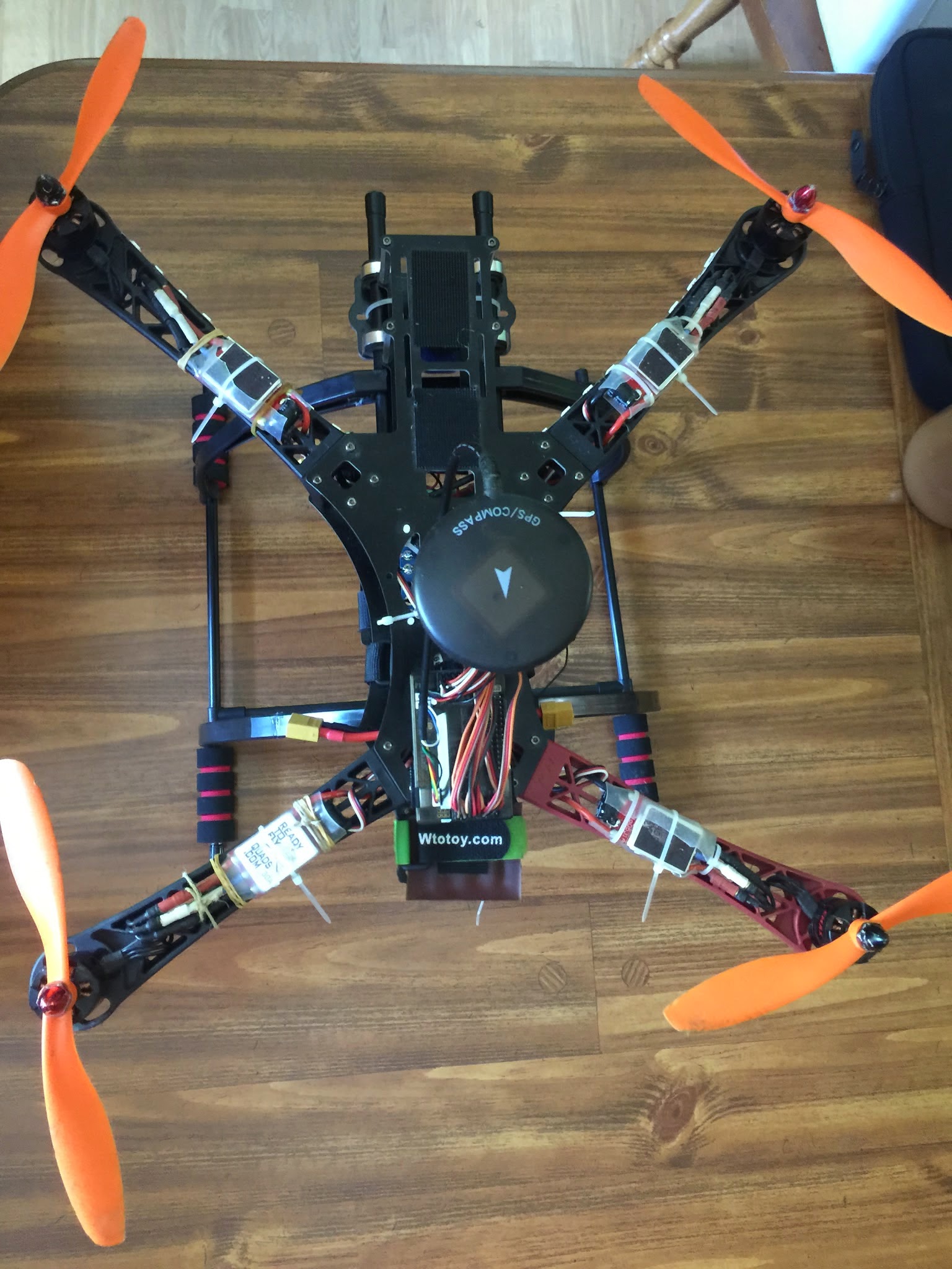

G+_Eddie Hughes Posted May 11, 2015 Share Posted May 11, 2015 Couldn't figure out how to paste the photo in my other thread... The battery is strapped and Velcro'ed under the body and the receiver is between the top and bottom plate located under the flight controller... (Anyone know why my 450 class yaws so much? It is constantly turning clockwise and is hard to control. I have no yaw control on my transmitter. I am using the APM 2.6 flight controller but everything else except the landing skids are stock from the know how list. I have recalibrated my accelerometer, compass, and esc's a bunch of times as well as auto-trimmed and auto-tuned but nothing seems to work. I tried different flight modes, (loiter, althold, acro, sport, drift, etc...) but nothing allows me to regain my yaw control on my transmitter. In the video I had RTL engaged and this was the result. Any help is appreciated!) Thank you!? Link to comment Share on other sites More sharing options...

G+_Fr. Robert Ballecer, SJ Posted May 11, 2015 Share Posted May 11, 2015 Ok... that's interesting.... -- Ignore all other advice -- Your motor rotation is wrong: #1 = top left #2 = top right #3 = bottom right #4 = bottom left #1 & #3 should be Clockwise #2 & #4 should be counter-clockwise You have #1 & #4 turning CCW You have #2 & #3 turning Clockwise Swap leads to make them turn the right way, and swap props on #1 & #2 Check you pinout on the Ardupilot to make sure ESCs are in the proper pins.? Link to comment Share on other sites More sharing options...
G+_Taylor Graham Posted May 11, 2015 Share Posted May 11, 2015 Oh wow, i didn't even think to check that! I'm surprised he was able to take off. Link to comment Share on other sites More sharing options...
G+_Eddie Hughes Posted May 11, 2015 Author Share Posted May 11, 2015 Fr. Robert Ballecer, SJ, The information I found online about the APM said, #1 = top right #2 = bottom left #3 = top left #4 = bottom right http://copter.ardupilot.com/wiki/initial-setup/motor-setup/ But, knowing that you have had a lot more experience flying than myself, I took your advice (realizing that the back 2 motors were switched) and swapped the leads and props on the back to motors...I worked on it for 3 days btw...lol FLIES LIKE A DREAM!!! Thank you everyone very much for the help!!! I am now going to get som crazy glue and fix my landing skids and take her for a ride. Please feel free to make fun of me for this mistake so I never do it again :) Link to comment Share on other sites More sharing options...
