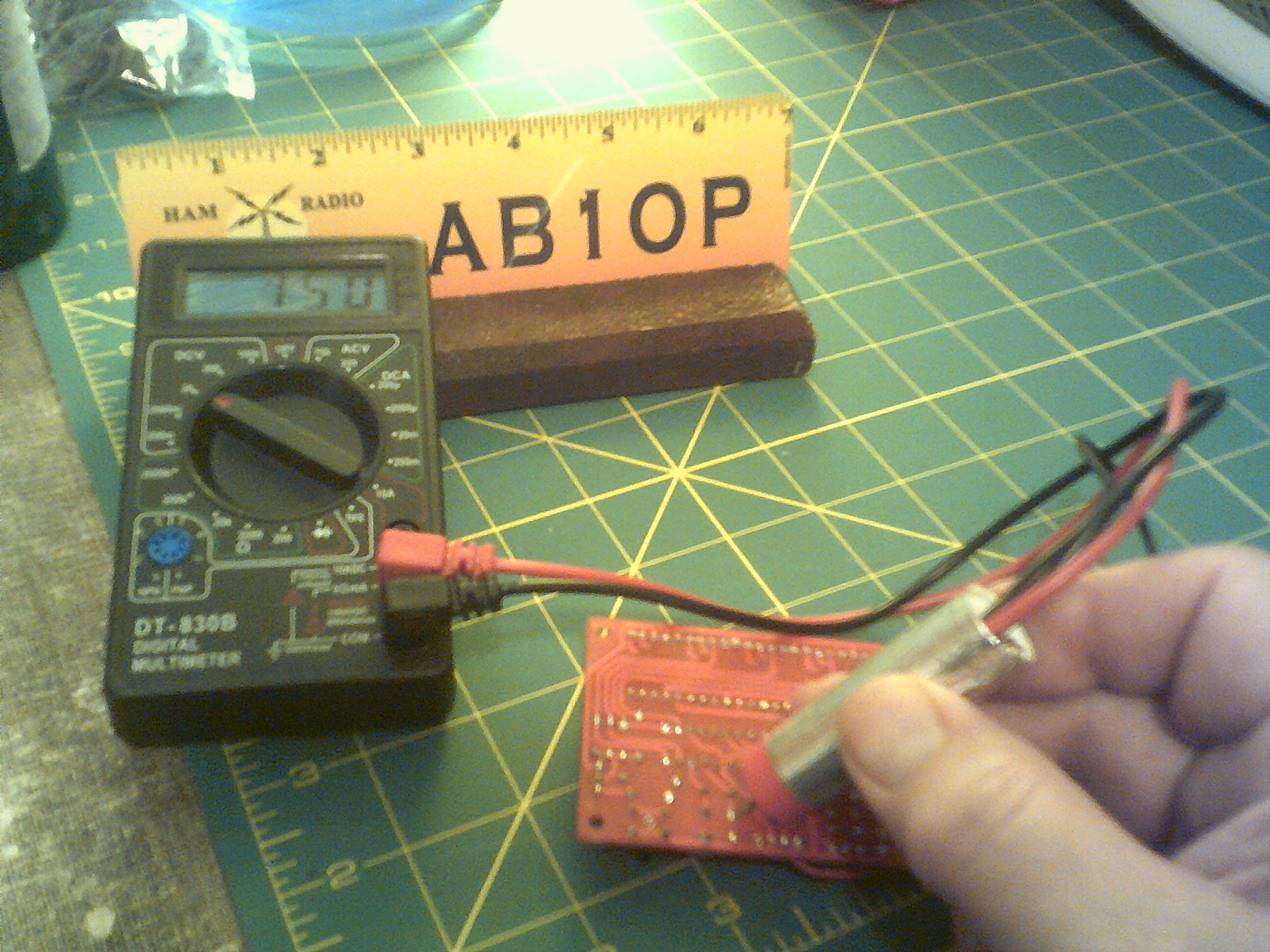

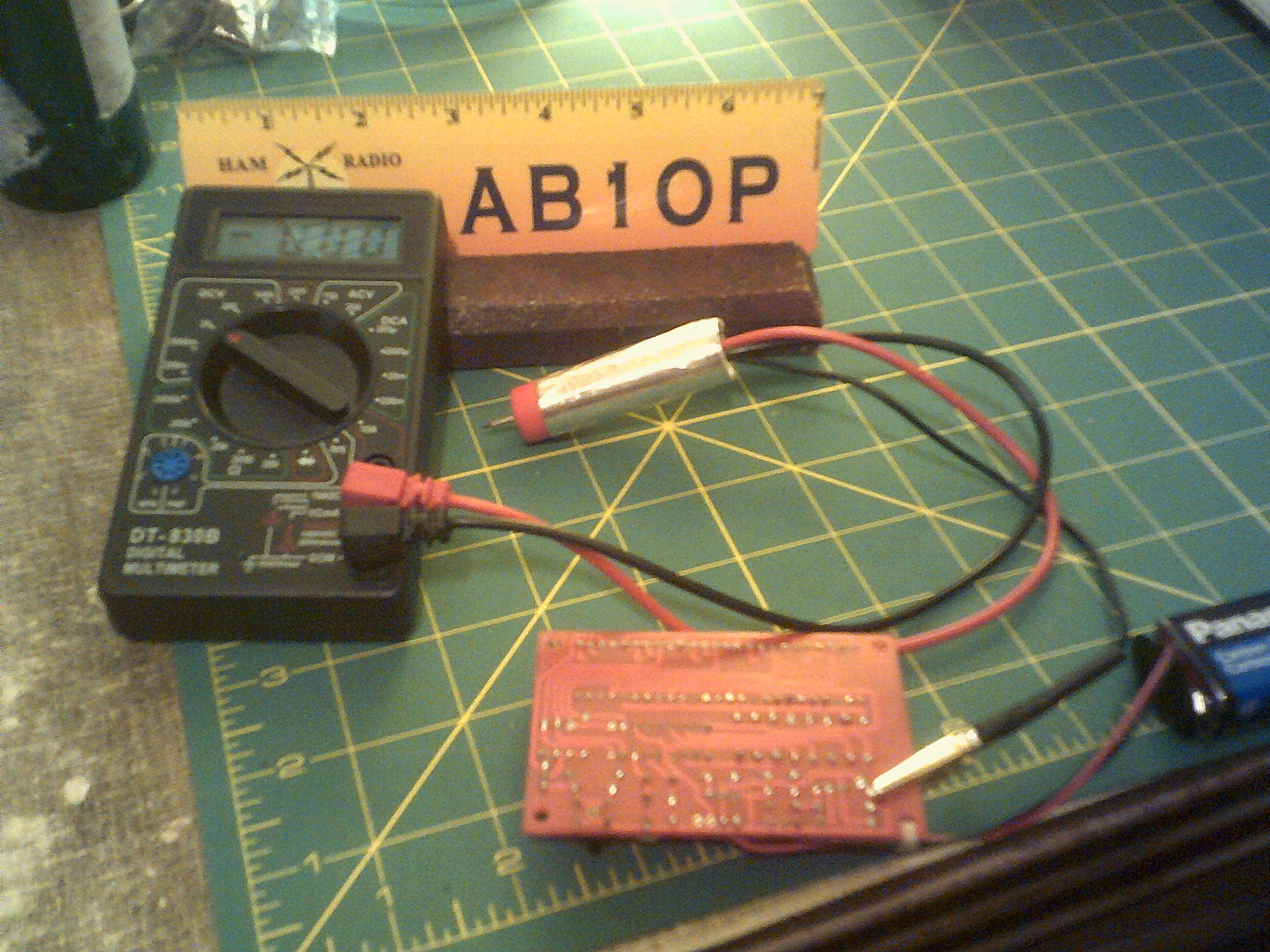

My parts from Mouser Electronics arrived. http://www.mouser.com/
