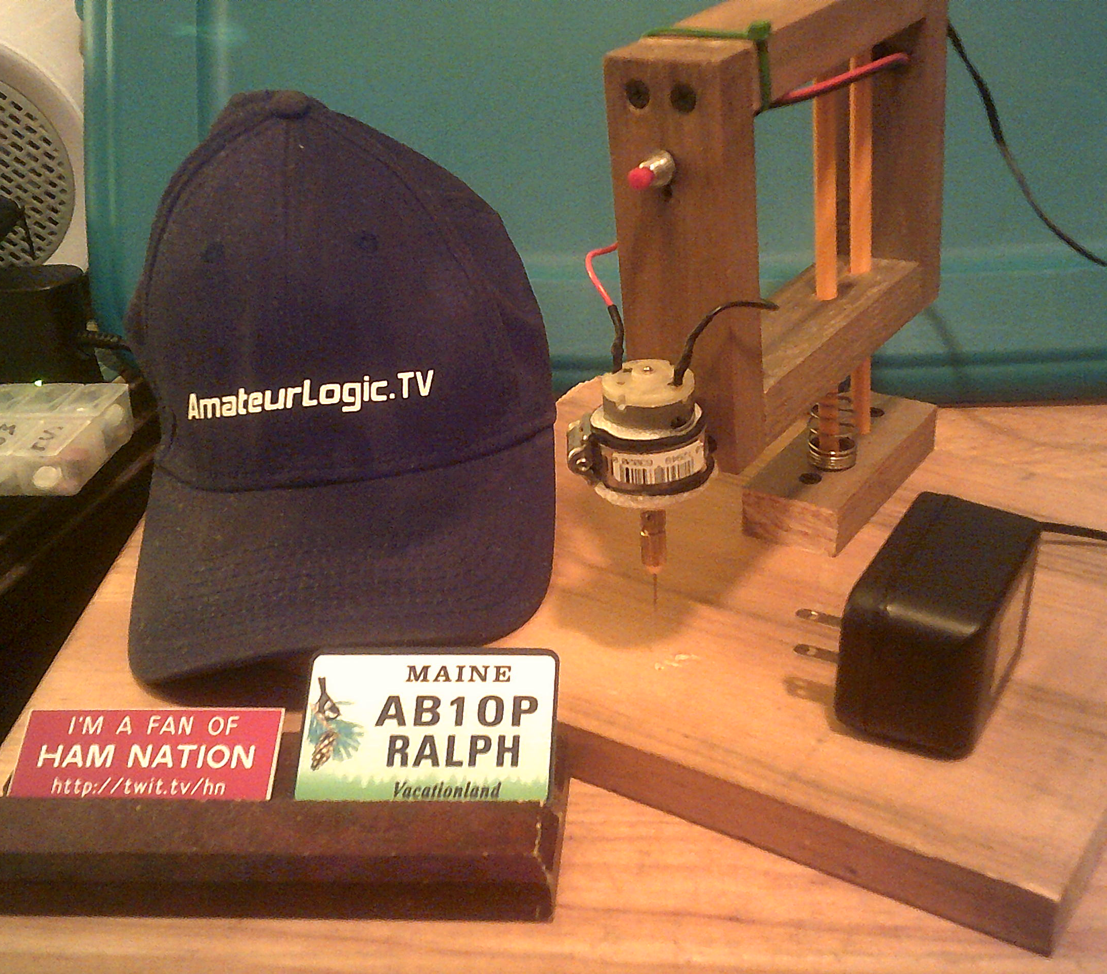

G+_Ralph Mills Posted September 28, 2016 Share Posted September 28, 2016 What's a poor ol' man to do? No 3D printer, no maker space and more important NO money. Go Cheap and Stay Home. Originally shared by Ralph Mills My Cheap $4 PCB Drill Jig. A re-purposed 12Vdc 1A wall wart, 1"x 3" Lumber, Scrap Pine Board, 2 pencils. Momentary push button switch, Spring, Power 2.1mm barrel connector, 1.5 inch hose clamp, wire, screws, zip tie and the Banggood $4 USD Drill and bit combo. (only thing I didn't have laying around.) http://www.banggood.com/12V-Small-PCB-Drill-Press-Drilling-With-1mm-Drill-p-929516.html Oh and I used some of the packing material to deaden the rattle between the motor and clamp. Not for close tolerances (a lot of "play" in there) just a quicker means to drill a dozen or more holes in pads on my Single sided PCB projects than a pin vise. KE5QKR Emile Diodene I hope once again to have my project recognized as "Cheap Old Man" Compliant. I'm sure the people over at TWiT's Know How could design a 3D print that would be prettier and allow more precise drilling. I highly doubt it could be cheaper! 73 de AB1OP_Ralph Link to comment Share on other sites More sharing options...
G+_Eddie Foy Posted September 29, 2016 Share Posted September 29, 2016 Love it! But started down that route and went for smt, no drilling (well for most of the pcb ) no tearing off pads,. ( but need the eyes for drag soldering ) Link to comment Share on other sites More sharing options...
