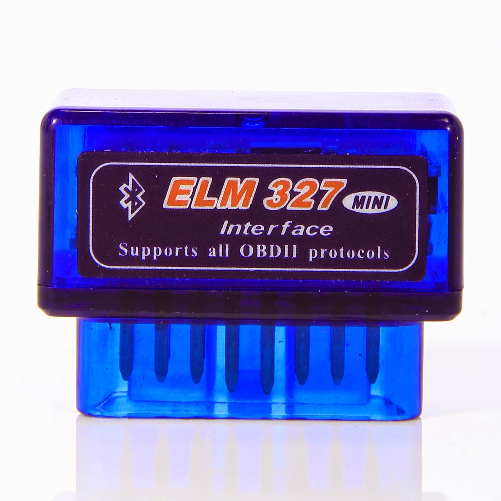

G+_Taylor Graham Posted May 23, 2014 Share Posted May 23, 2014 Just watched the latest ep of Know How, saw you were talking about OBD2. Didja know about the ELM327 mini OBD2 bluetooth adapters? You can monitor anything your OBD2 port has access to with any android/iOS device. You can even take video on the device and overlay info/gauges/maps using an app called Torque. I have one, its great. Have diagnosed, fixed, and cleared a few engine codes already. Link to comment Share on other sites More sharing options...

G+_Daniel Armstrong Posted May 29, 2014 Share Posted May 29, 2014 Couple problems, there are several versions of the ELM327 clones, some work, some don't. For instance there are 2 versions just of the translucent blue one pictured, one with a solid bump on the connector side, and one with a separate tab there. I got the one with the tab and it worked on '90s GM, and Chrysler stuff, but wouldn't connect to an '05 Impala. 2nd, iOS doesn't allow Bluetooth SPP (serial port protocol) and the adapters are OBDII to serial bridges with either a serial-bluetooth, serial-USB, or serial-WiFi bridge, so you can't use the Bluetooth version on iOS. So while the clones are nice, a genuine ELM327 would be better, and if you really care a service shop level tool like the OTC 4000 Enhanced, Genisys or Pegisys are nice to have, but I like Torque Pro or OBD Car Doctor better. Link to comment Share on other sites More sharing options...
