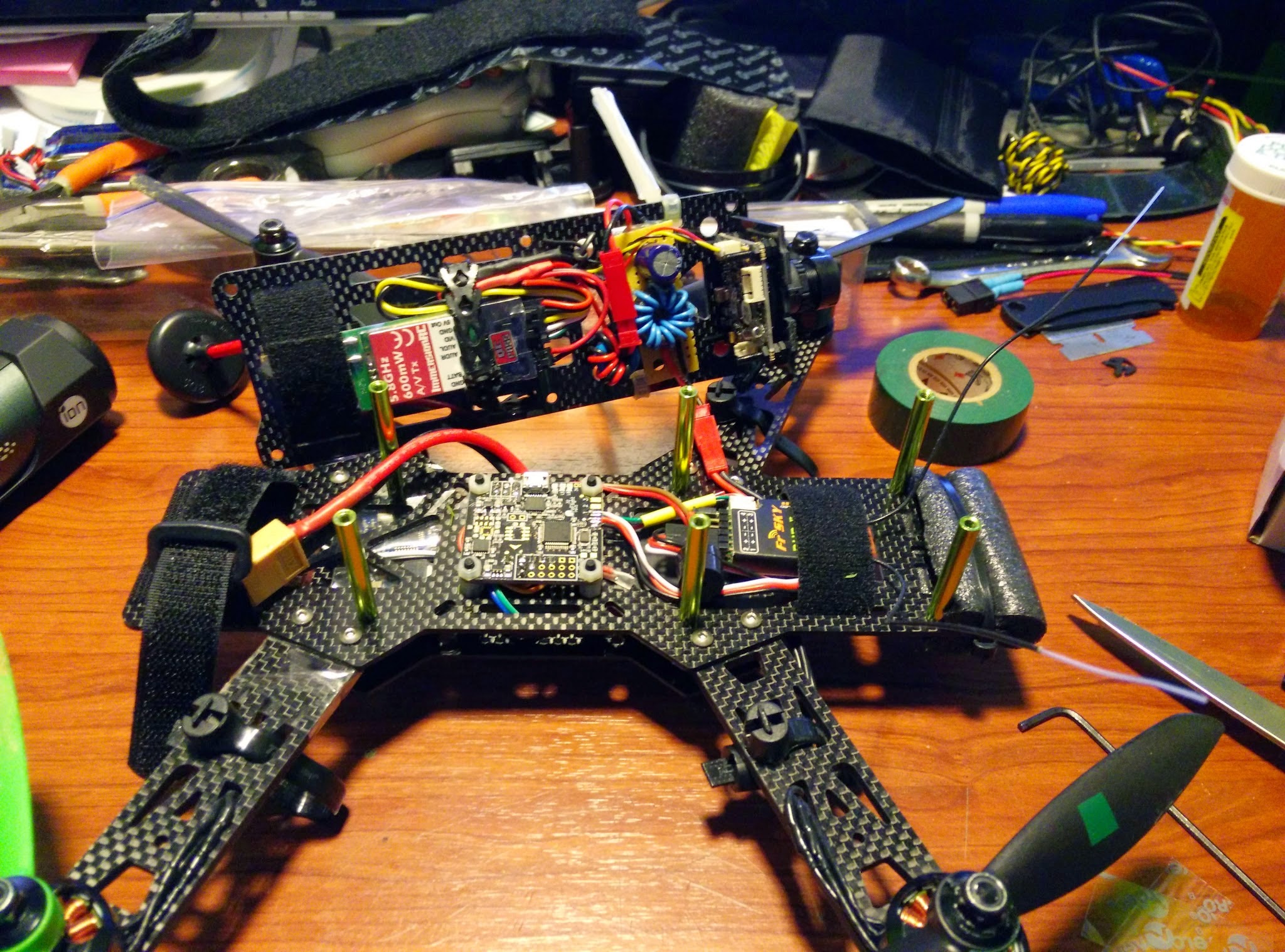

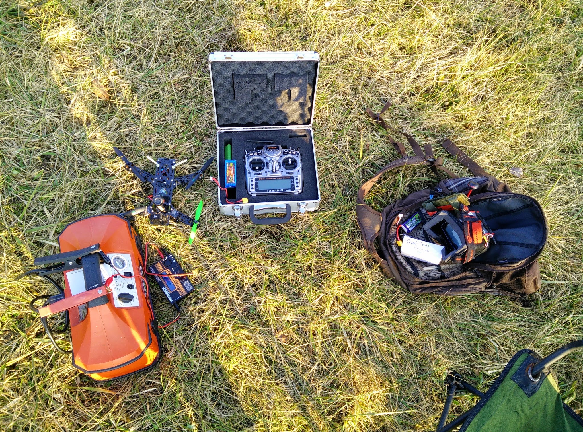

G+_Taylor Graham Posted December 26, 2014 Share Posted December 26, 2014 Since everyone is posting quad builds... emax 250 frame | cobra 2204 2300kv motors | HQ 6045 props (all the lift) | HK blue series 12a escs | afro pdb | naze32 flight controller (cleanflight fw) | frsky d4r-ii reciever (cppm+telemetry) | turnigy nano tech 1300mah 45c battery Fpv: sony super had 600 | immersion 600mw vtx | diy power filter | spironet antennas ground station: frsky taranis | quanum fpv goggles | immersion uno vrx Link to comment Share on other sites More sharing options...
