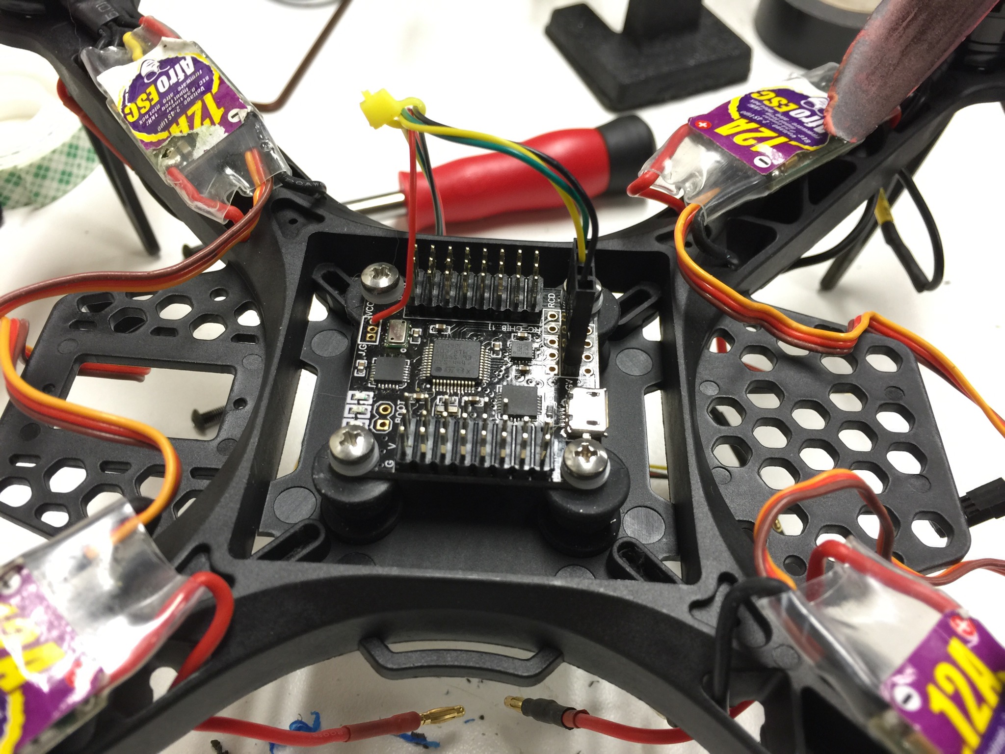

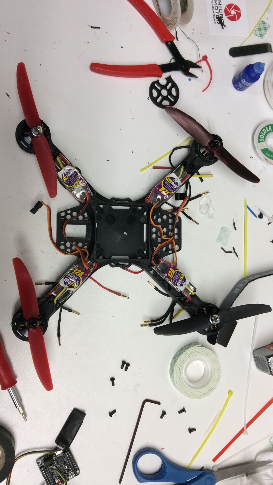

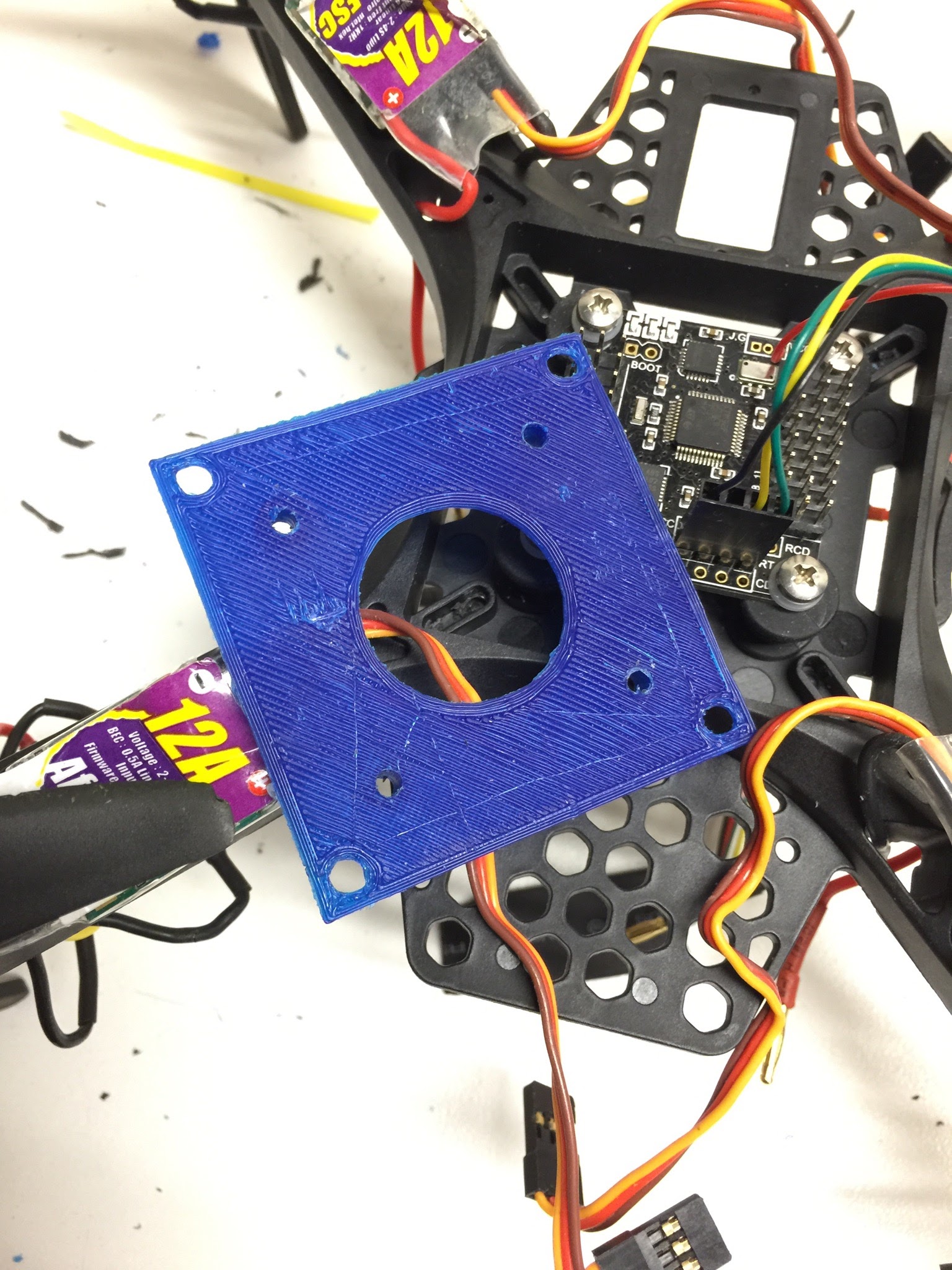

G+_Brian Festa Posted May 15, 2015 Share Posted May 15, 2015 The murderquad broke a leg. So I am breaking out the back up frame. It's another FPV260. I used a mounting adapter my friend made me for the dragonfly32 pro as a template and mounted it on damping balls and nuking washers. Right now it's screw into the frame but I am going to change this to bolt through. #workinprogress Link to comment Share on other sites More sharing options...

G+_Michael Heinz Posted May 15, 2015 Share Posted May 15, 2015 Nice idea; just FYI, though, with the 260 I found it worked a lot better to mount the ESCs to the bottoms of arms. Haven't noticed any heat issues. Link to comment Share on other sites More sharing options...
G+_Brian Festa Posted May 15, 2015 Author Share Posted May 15, 2015 Yeah I was going back an forth with escs on bottom. I have high intensity leds coming in a few colors and will be putting those in the bottom to help with orientation and so I can start night flying ? Link to comment Share on other sites More sharing options...
G+_Michael Heinz Posted May 15, 2015 Share Posted May 15, 2015 Yup - that's a good reason. Link to comment Share on other sites More sharing options...
G+_Michael Heinz Posted May 15, 2015 Share Posted May 15, 2015 BTW - I haven't found replacement legs for the 260 frame, but legs from the 250 fit if you wrap a bit of electrical tape around the pegs to make them a mil thicker. Link to comment Share on other sites More sharing options...
