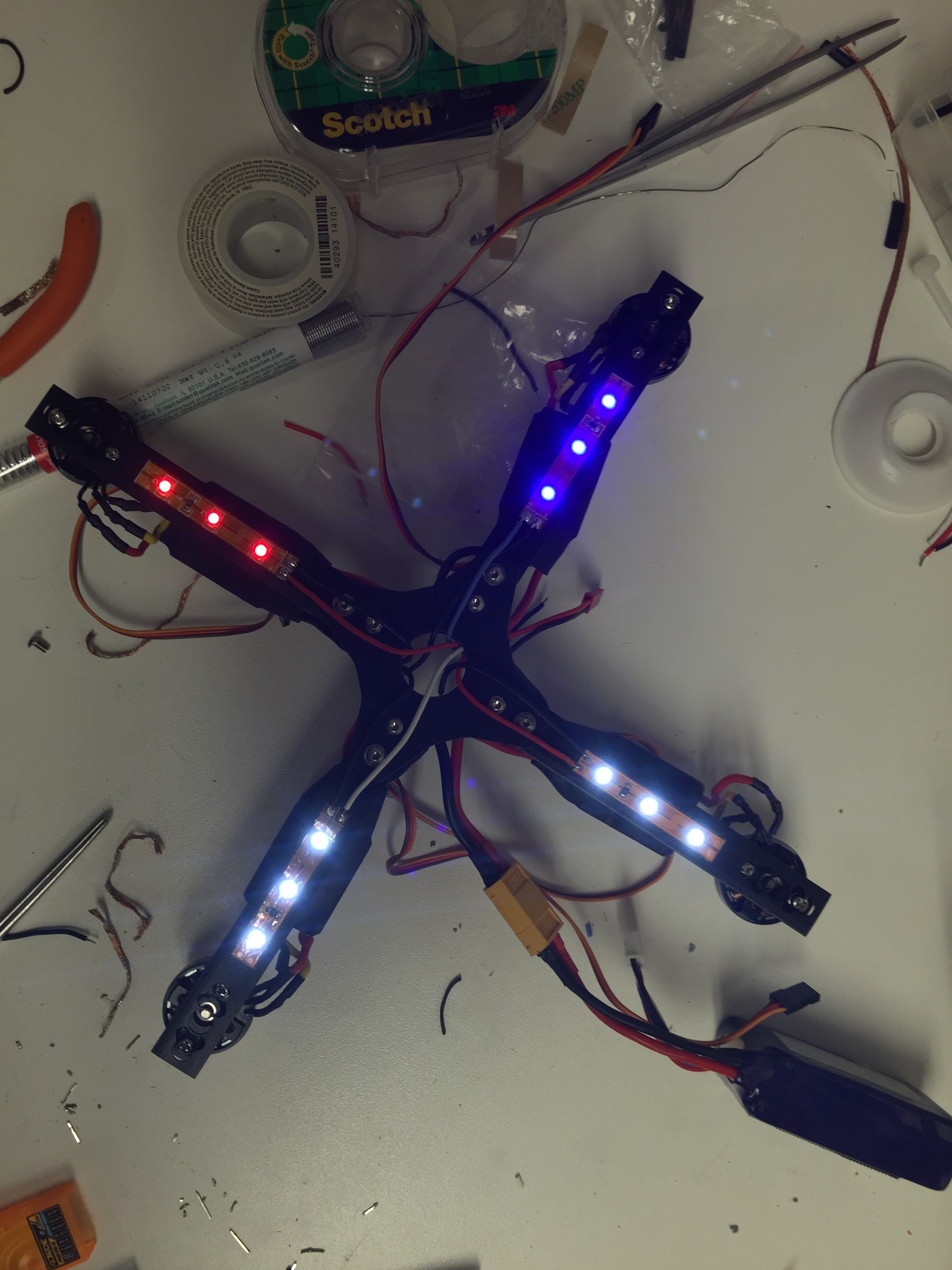

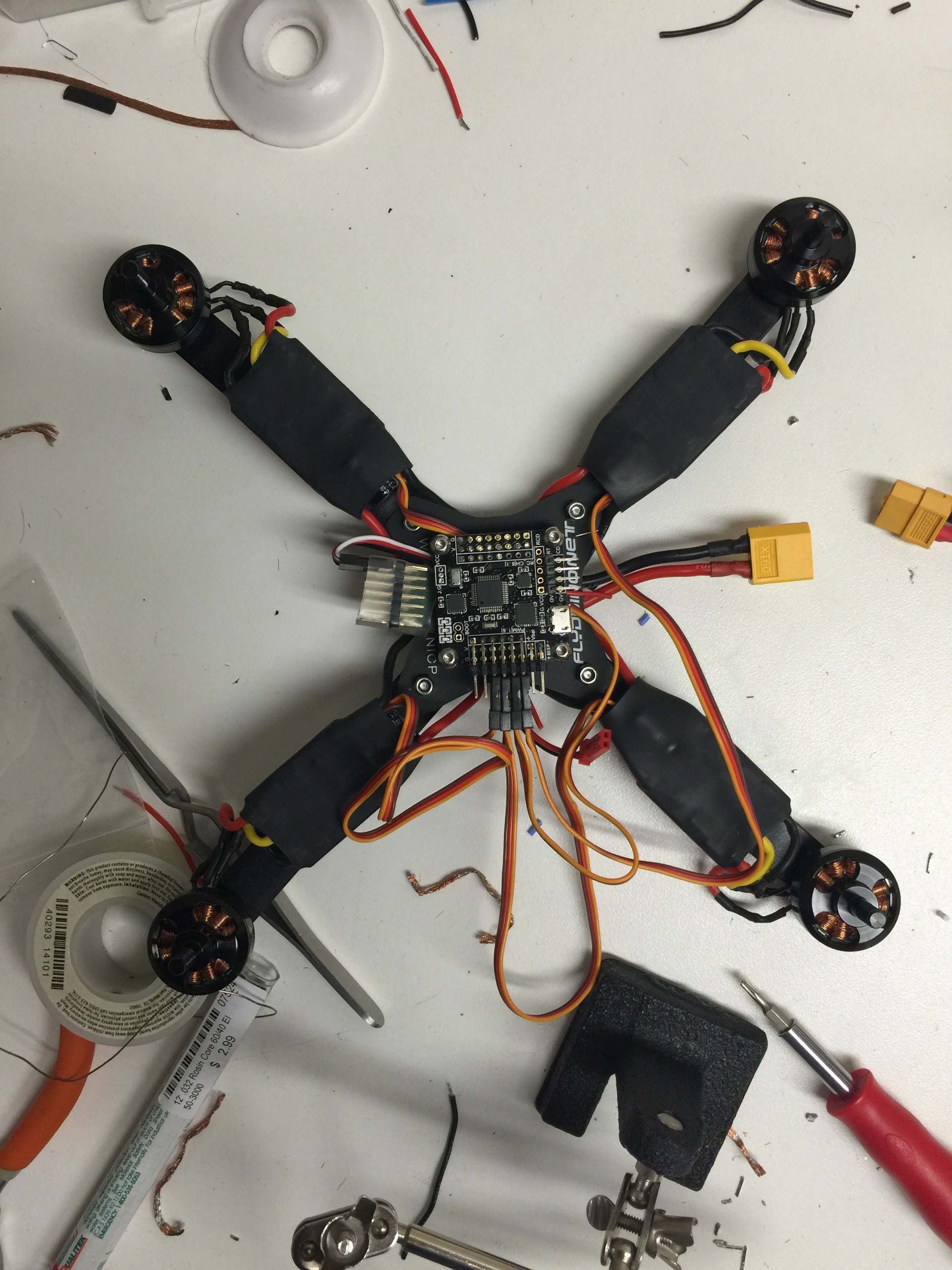

G+_Brian Festa Posted June 6, 2015 Share Posted June 6, 2015 The new quad build is pretty much done. Just need to tidy up the esc wires and mount my rx. Anyone ever try hot gluing escs to the frame before? Hoping the leds will help with orientation. I may add colors to the side of the arms as well hopefully test flying tomorrow. Link to comment Share on other sites More sharing options...
G+_Fr. Robert Ballecer, SJ Posted June 6, 2015 Share Posted June 6, 2015 ESCs can get hot... REALLY hot... definitely hot enough to melt hot glue. :) Link to comment Share on other sites More sharing options...
G+_Brian Festa Posted June 6, 2015 Author Share Posted June 6, 2015 Fr. Robert Ballecer, SJ well scratch that idea then. Thanks. This bad boy will have almost. 7:1 thrust to wait ratio onn6045s :) it's the culmination of my quad obsession. I will be making a post will the full build. So I wanna make her real purity too hehe Link to comment Share on other sites More sharing options...
G+_Brian Festa Posted June 6, 2015 Author Share Posted June 6, 2015 I'll take a look. They are Afro 20a escs. The most I'll pull is 18-20a on 6045s which I won't be running often. Most times it will be 6030 which are more in the 11-14 range. Link to comment Share on other sites More sharing options...
G+_Brian Festa Posted June 6, 2015 Author Share Posted June 6, 2015 What about silicone for attaching be escs Link to comment Share on other sites More sharing options...
G+_Brian Festa Posted June 6, 2015 Author Share Posted June 6, 2015 I'll try that then I have the 3m grey outdoor stuff I use it for installs at people's house slot. Didn't even think of that. I will probably end up back at black rubber bands Link to comment Share on other sites More sharing options...
