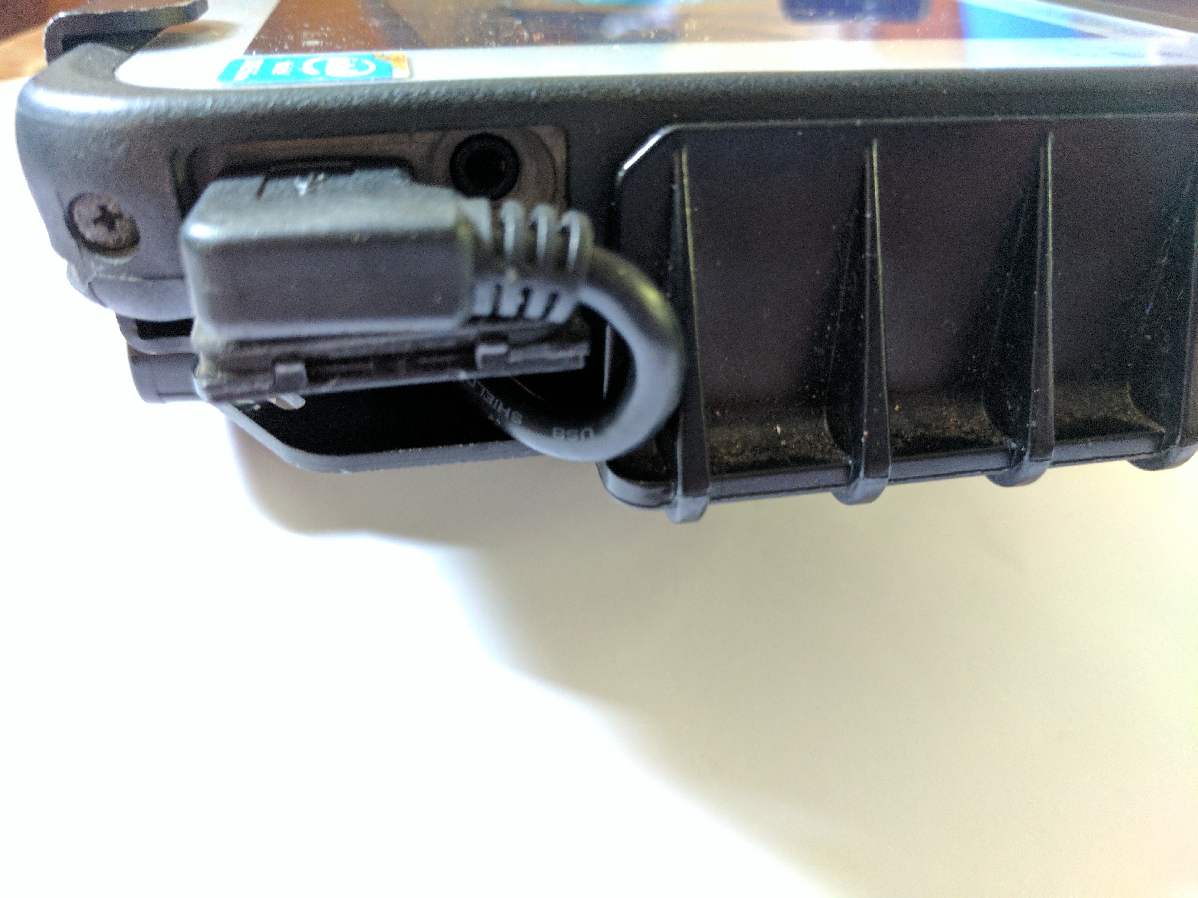

G+_Daniel N Posted April 25, 2017 Author Share Posted April 25, 2017 John Sullivan Thanks for the reply. OK I will try to explain it as best I can. I'm a Land surveyor and use the tablet with the radio plugged in to communicate with the Instrument I use. So with the radio plugged in the usb it gets "bumped" and "hooked" quite a bit as its sticks out on the side of the tablet (see photo below). I Already had to get the usb port fixed once. So I'm looking for a way to minimise wires coming out of the tablet. Hope this makes sense > Link to comment Share on other sites More sharing options...
