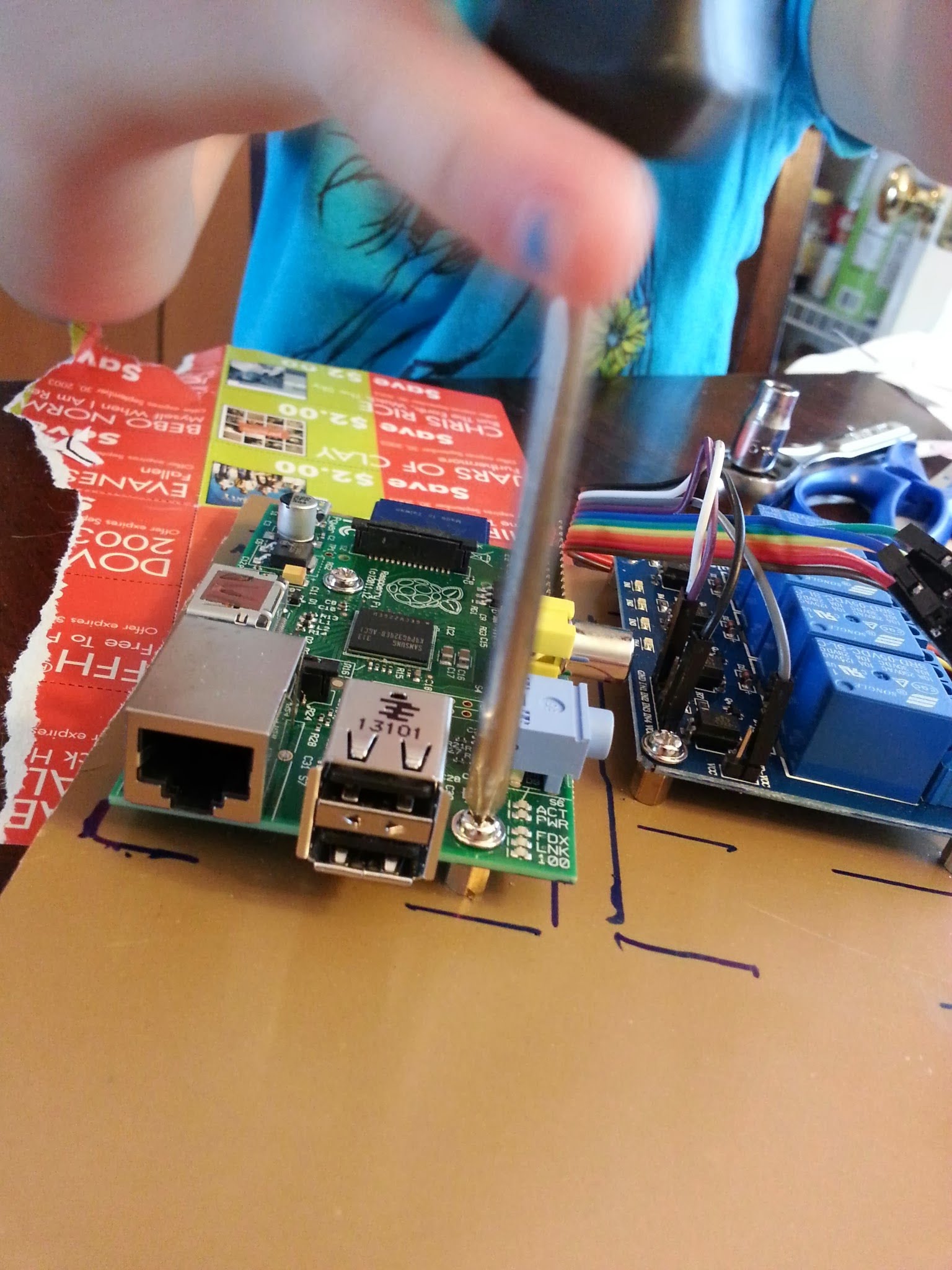

G+_Ben Reese Posted December 5, 2017 Share Posted December 5, 2017 More to David Peach?'s point, I've had success screwing stand-offs directly into wood (laminate flooring in this pic). But I like the hot glue idea too. Link to comment Share on other sites More sharing options...
