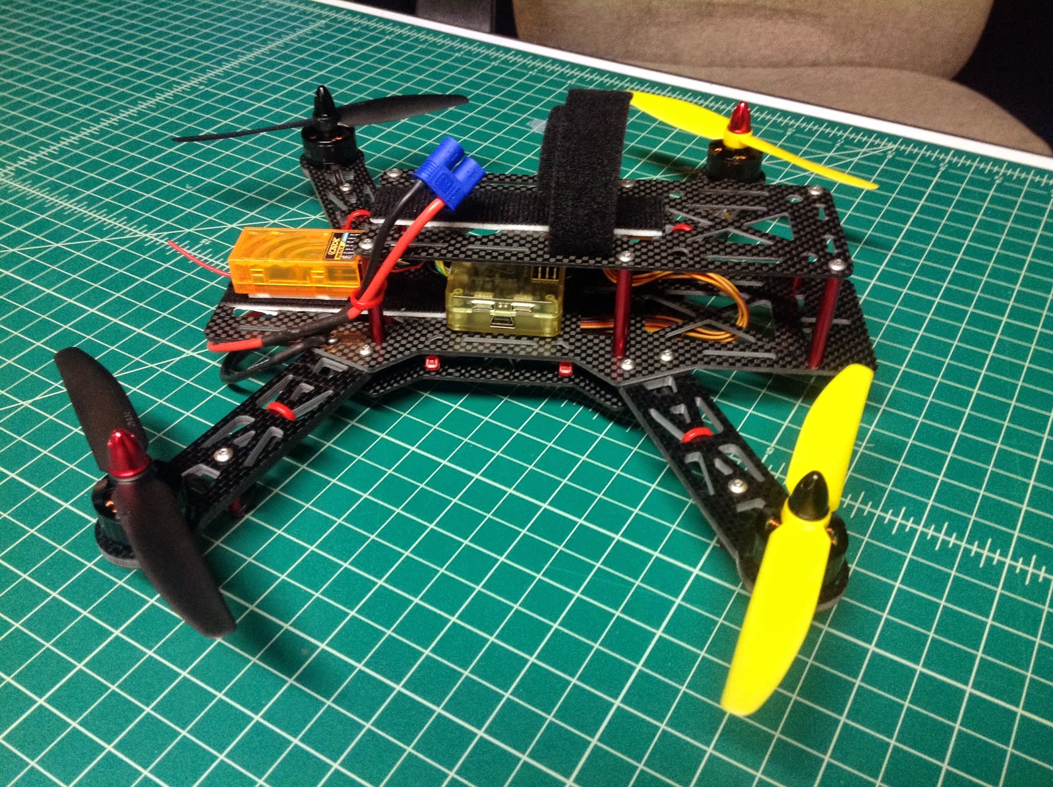

G+_Mr Bill Posted March 11, 2015 Share Posted March 11, 2015 Finishing up my first 250 build. I used an emax nighthawk frame with emax 1806 motors and emax 12 amp ESCs. Everything is working, she flies (as well as her pilot can manage)... but I am noticing an extremely high pitched squeal. It really makes you question whether your head is about to explode. It seems far higher pitched and louder than normal motor whine. My attempts to research causes led to a single article about ESC Control Frequency (I can choose between 8KHz and 22KHz on these ESCs). I'm reaching the bottom of my bucket of knowledge and frankly, am not sure what that changes/means. Anyone have any hints, clues to try and knock out the squeal? Link to comment Share on other sites More sharing options...

G+_Mr Bill Posted March 12, 2015 Author Share Posted March 12, 2015 It was pretty much all the time but with varying intensity. That said I made two changes to the ESCs and the squeal is gone. 1) changed the Advanced Timing to Very High ( did not fix it alone ) 2) changed the control frequency to 22KHz from 8KHz I suspect I could back out the first change. I will probably try this weekend. Thanks everyone. Link to comment Share on other sites More sharing options...
