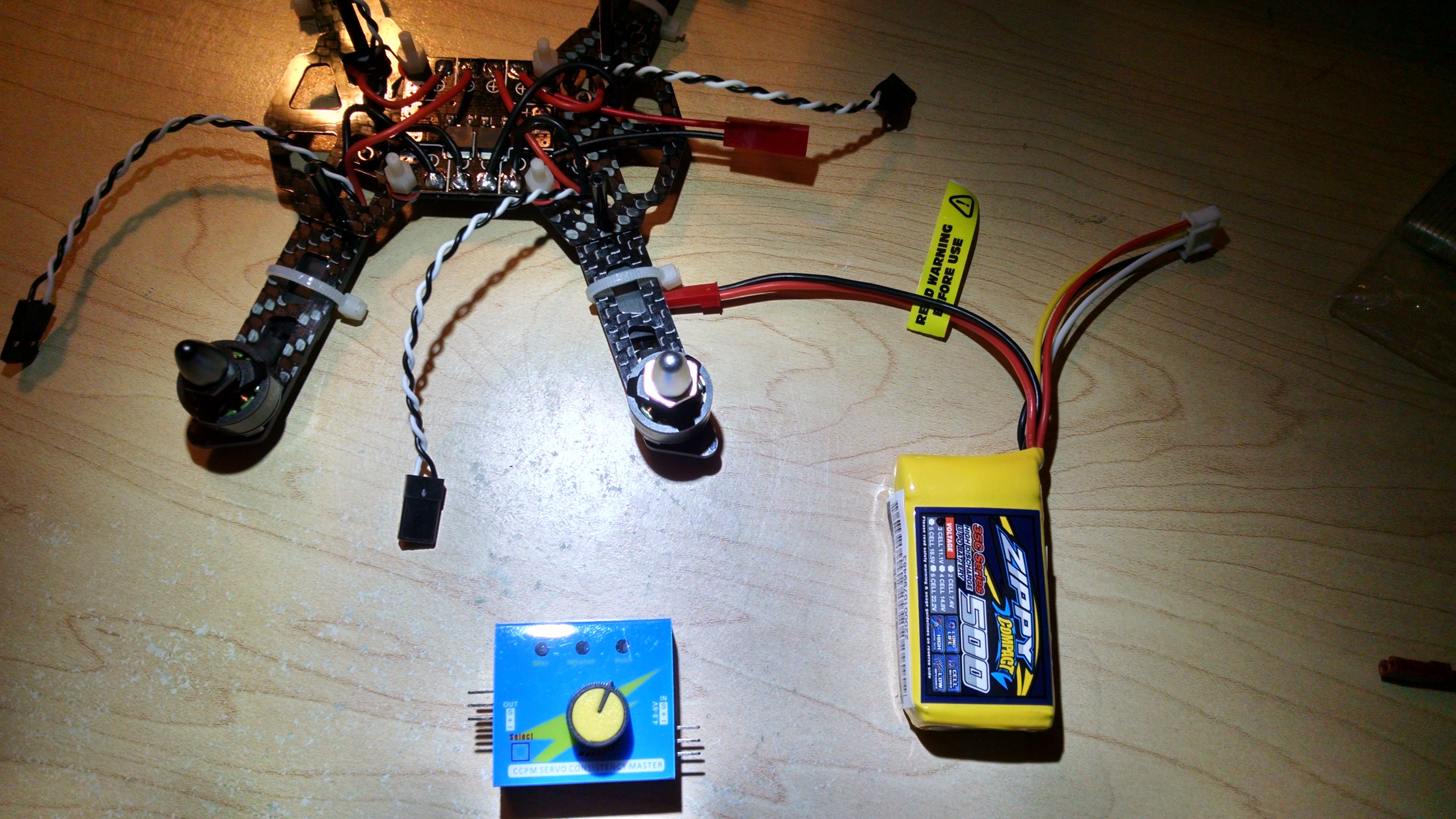

G+_Brian “Yikesfpv” Gipe Posted March 20, 2016 Share Posted March 20, 2016 Hey my fellow geeks and builders! I have a quick question. Do I need a voltage regulator between the battery and this servo controller? I can't get my motors to spin up but they make a nice sing song when i plug the main battery in. Link to comment Share on other sites More sharing options...
G+_610GARAGE Posted March 20, 2016 Share Posted March 20, 2016 Yes. Normally, the esc would provide the 5v, but, assuming you're using the esc that Fr. Robert Ballecer, SJ used, then they don't have a bec(voltage regulator) onboard. You will have to provide your own. Also the leds on the controller will light up when it has power. Link to comment Share on other sites More sharing options...
G+_Brian “Yikesfpv” Gipe Posted March 20, 2016 Author Share Posted March 20, 2016 They lit up w/ the 11.1 volt. Don't think I fried anything though. Link to comment Share on other sites More sharing options...
G+_610GARAGE Posted March 20, 2016 Share Posted March 20, 2016 You probably did. Sending 11 volts probably wouldn't release the magic blue smoke, but will fry the ic. Sorry. A good rule to follow, if it is a server connecter (ie those 3 pin headers) its 5v only. Not always true, but it's a good rule to follow. Link to comment Share on other sites More sharing options...
G+_Brian “Yikesfpv” Gipe Posted March 20, 2016 Author Share Posted March 20, 2016 If I connected my esc's would they also be damaged? Link to comment Share on other sites More sharing options...
G+_610GARAGE Posted March 20, 2016 Share Posted March 20, 2016 I don't know. Those esc are opto coupled. So it is possible that you blew out the couplers. But it is also possible that the 11v never made it to the esc. Link to comment Share on other sites More sharing options...
G+_Carlton Dodd Posted March 20, 2016 Share Posted March 20, 2016 If they still "sing", the ESCs are probably okay. BTW, the most probable cause for them not spinning is that you haven't armed the controller. Either through a configured switch, or a joystick position combination. Link to comment Share on other sites More sharing options...
G+_Brian “Yikesfpv” Gipe Posted March 20, 2016 Author Share Posted March 20, 2016 Carson Black Yes all 3 lights light up on the tester. Just doesn't do anything when I turn the knob. Link to comment Share on other sites More sharing options...
G+_Brian “Yikesfpv” Gipe Posted March 20, 2016 Author Share Posted March 20, 2016 Thanks Carson Black . I've got some bec's I can hook up and see if it's still working. Or just find a 5v battery. Otherwise I'll order a new tester. Link to comment Share on other sites More sharing options...
G+_Brian “Yikesfpv” Gipe Posted March 20, 2016 Author Share Posted March 20, 2016 Ok. Thanks Wayne Hobbins . I'll solder up the bec later this evening and test it out. Link to comment Share on other sites More sharing options...
G+_Brian “Yikesfpv” Gipe Posted March 22, 2016 Author Share Posted March 22, 2016 Yep, it's fried. lol. I ordered 2 more but I think my flight controller will come in soon. Might just be able to test with that, huh? Link to comment Share on other sites More sharing options...
G+_610GARAGE Posted March 22, 2016 Share Posted March 22, 2016 Brian Gipe Yea, you could use your flight controller. Link to comment Share on other sites More sharing options...
