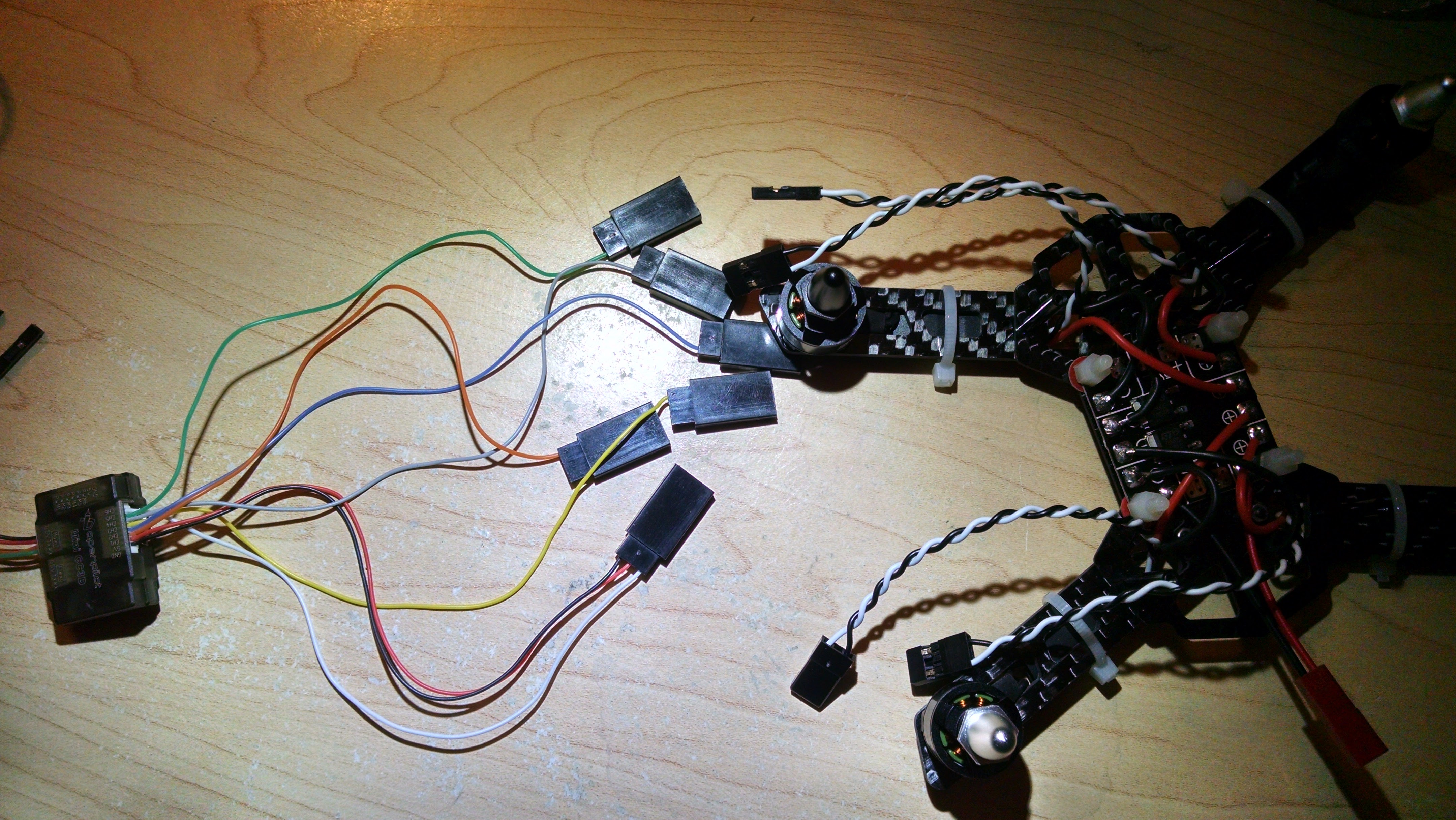

G+_Brian “Yikesfpv” Gipe Posted April 7, 2016 Share Posted April 7, 2016 Hey guys! So I need to connect my esc's to my flight controller. I think I need to connect the ground cables but there is only one. I'm going to cut and solder them, of course. Reason I'm asking is I connected them w/out ground to cleanflight and the motors would not spin up using the GUI. Link to comment Share on other sites More sharing options...
G+_Brian “Yikesfpv” Gipe Posted April 7, 2016 Author Share Posted April 7, 2016 Maybe I need to connect it to my PC via UART? Link to comment Share on other sites More sharing options...
G+_Travis Hershberger Posted April 7, 2016 Share Posted April 7, 2016 Without ground the electrons have no place to go! Think of an electrical circuit as a circle, if the electrons can't get back to where they started from they don't "go". So if you're powering them from a battery, the positive and negative(ground) wires both need to be connected. Link to comment Share on other sites More sharing options...
G+_Brian “Yikesfpv” Gipe Posted April 7, 2016 Author Share Posted April 7, 2016 Ok. So can I connect them all to the same ground wire? Link to comment Share on other sites More sharing options...
G+_Travis Hershberger Posted April 7, 2016 Share Posted April 7, 2016 Yes, common ground is fine. Link to comment Share on other sites More sharing options...
G+_Brian “Yikesfpv” Gipe Posted April 7, 2016 Author Share Posted April 7, 2016 Awesome! Thank you Travis Hershberger?. I'll set that up tonight. Link to comment Share on other sites More sharing options...

G+_Brian “Yikesfpv” Gipe Posted April 9, 2016 Author Share Posted April 9, 2016 All engines are go! Thanks a lot, guys. I believe my testing is done. Everything is spinning and working in cleanflight like I wanted. Now I just need to start building. Link to comment Share on other sites More sharing options...
