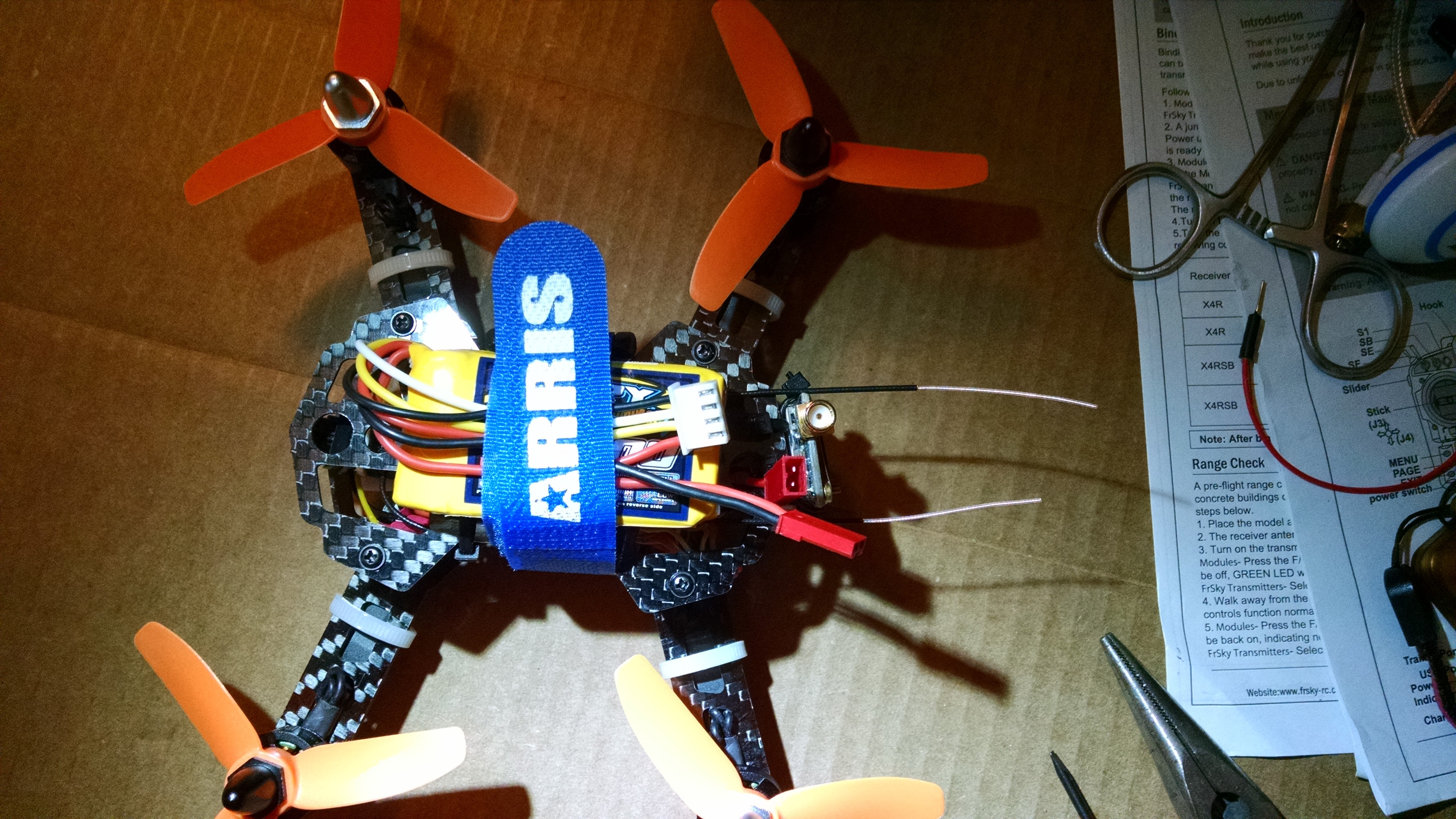

G+_Brian “Yikesfpv” Gipe Posted April 24, 2016 Share Posted April 24, 2016 Hey, guys and gals! Got my Diatone 150 up and running. Only problem is I don't have enough batteries. lol. Can I use 4s batteries with a jst plug? What batteries do you reccomend. Thanks a bunch, my friends:) Link to comment Share on other sites More sharing options...
G+_Brian “Yikesfpv” Gipe Posted April 24, 2016 Author Share Posted April 24, 2016 Well I ordered some 3s 850 mah's. Should last a bit longer. In the future I might switch to 4s and just switch out the plug. Is it safe to use 14.8v in a 12v connection? Link to comment Share on other sites More sharing options...
G+_Chris W Posted April 26, 2016 Share Posted April 26, 2016 Most switching regulators will handle that small voltage difference with no problem, but I'm not sure about the esc's. They sometimes (I've heard 'usually') use linear regulators, which could overheat badly with a higher-than-design voltage. I'd look up the input voltage spec on all your onboard gear just to be sure. Link to comment Share on other sites More sharing options...
