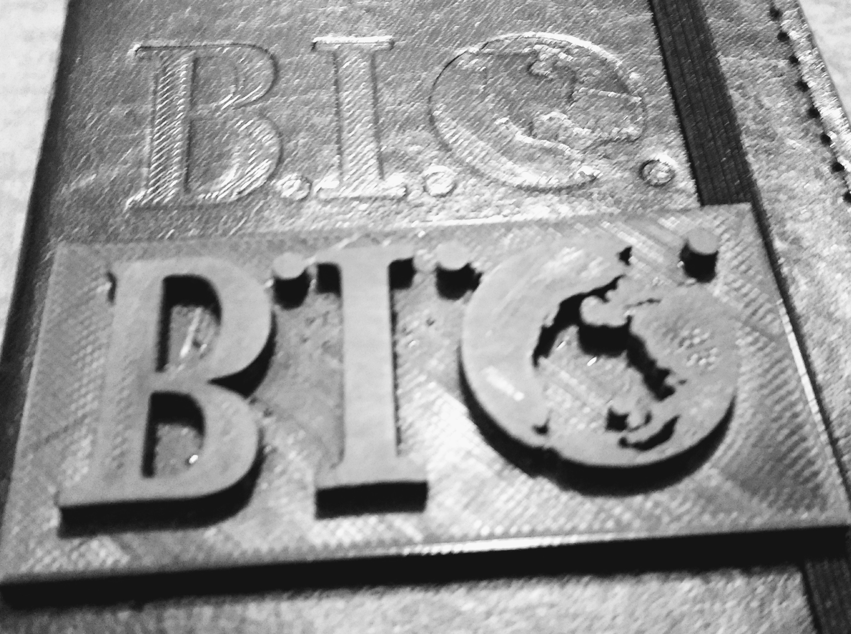

G+_David Peach Posted November 11, 2017 Share Posted November 11, 2017 To emboss my pocket notebook I imported an SVG version of my office logo into TinkerCAD. Then extruded it up 6 mm. Flipped it over so I had the mirror image of the logo. Added a 3 mm rectangle as the base. Then I used C-clamps and blocks of wood to squeeze the logo into the front cover of the book. You may think that it is not necessary to print the base so thick, but 2 mm for the base was not sturdy enough to apply equal pressure across the logo when it was clamped down. I recommend practicing the technique before trying it on something important. I embossed my web address on a couple of items to help me find out what doesn't work well (2 mm base being the main thing). This turned out better than expected. Link to comment Share on other sites More sharing options...

G+_Scott Wilkinson Posted December 19, 2017 Share Posted December 19, 2017 I did a similar project on raw leather, so the leather could be moistened, which helped. But I used liquid nail to glue the print on to a 3/4 plywood backer, and another piece of plywood on the back of the leather. This allowed considerably more pressure to be applied with a bench vise, resulting in a very deep impression. Link to comment Share on other sites More sharing options...
G+_David Peach Posted December 19, 2017 Author Share Posted December 19, 2017 Scott Wilkinson next time I'm going to hit the cover of the book with a little heat from a hair dryer before doing it. I think that will give a better impression. Mostly I'm compressing the cardboard layer under the fake leather cover. Link to comment Share on other sites More sharing options...
