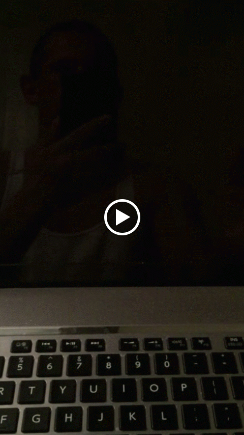

G+_Vincent Panico Posted April 21, 2016 Share Posted April 21, 2016 This what happens when I turn on my laptop it works sometimes when I let it sit over night and unplug it? Toshiba Satellite P75-A7200 #toshiba Link to comment Share on other sites More sharing options...
G+_Keith Mallett Posted April 21, 2016 Share Posted April 21, 2016 I think your hard drive is dead. Can you remove the battery? If so unplug the power cord, remove the battery and let it sit for at least 2min, 5 preferably. Plug it in without the battery and see if you can turn it on and you can get into the BIOS or at least see the HP splash screen. The POST (Power On Self Test) will check the BIOS, CPU, RAM and video first before going to the hard drive, but I have seen system not able to POST with a dead drive so you may need to remove it to check. Is it under warranty? Link to comment Share on other sites More sharing options...

G+_Eddie Foy Posted April 21, 2016 Share Posted April 21, 2016 There have been times I'll force a POST failure. Just mash keys, remove HD &/or RAM. (No, POST is built into the system. Its checks everything out before allowing the BIOS to bootstrap load from media) Link to comment Share on other sites More sharing options...
G+_Eddie Foy Posted April 21, 2016 Share Posted April 21, 2016 I don't think it sounds like the click of death. Sounded more like it was coming out of the speakers. (to me at least). But Vincent Panico should verify. Link to comment Share on other sites More sharing options...
G+_Dominick Valentic Posted April 21, 2016 Share Posted April 21, 2016 Yeah it sounds like the speaker popping rather than the HD but the acoustics could just be weird in the video... It'd be nice if you had another HD handy with an OS on it just to rule out completely Link to comment Share on other sites More sharing options...

G+_Keith Mallett Posted April 22, 2016 Share Posted April 22, 2016 Hey Vincent Panico What did you find? A clicking sound is mechanical and the only mechanical devices in your laptop are the HD and the optical drive. Link to comment Share on other sites More sharing options...

G+_Vincent Panico Posted April 28, 2016 Author Share Posted April 28, 2016 No where, it comes on and the sound is still there but the screen stays black. Link to comment Share on other sites More sharing options...
G+_Midwest Concert Video Posted April 28, 2016 Share Posted April 28, 2016 If the screen is black, that usually indicates a failure of the FL board if the backlight is florescent. Again, does the external monitor connector work? Link to comment Share on other sites More sharing options...
G+_Keith Mallett Posted April 28, 2016 Share Posted April 28, 2016 OK I think the clicking may be the piezo speaker that is not working properly giving you a beep error code but it sounds like a click. Do this - Remove the battery and power Remove the hard drive Remove the optical drive Remove both RAM dimms Plug in the power, no battery It will not post without ram. Count the beeps (clicks) in short succession, and in groups. So it may be click-click..... click-click-click.... click-click. I can't remember if Toshiba is on the 3 or 4 beep code set. See what you get. Link to comment Share on other sites More sharing options...
