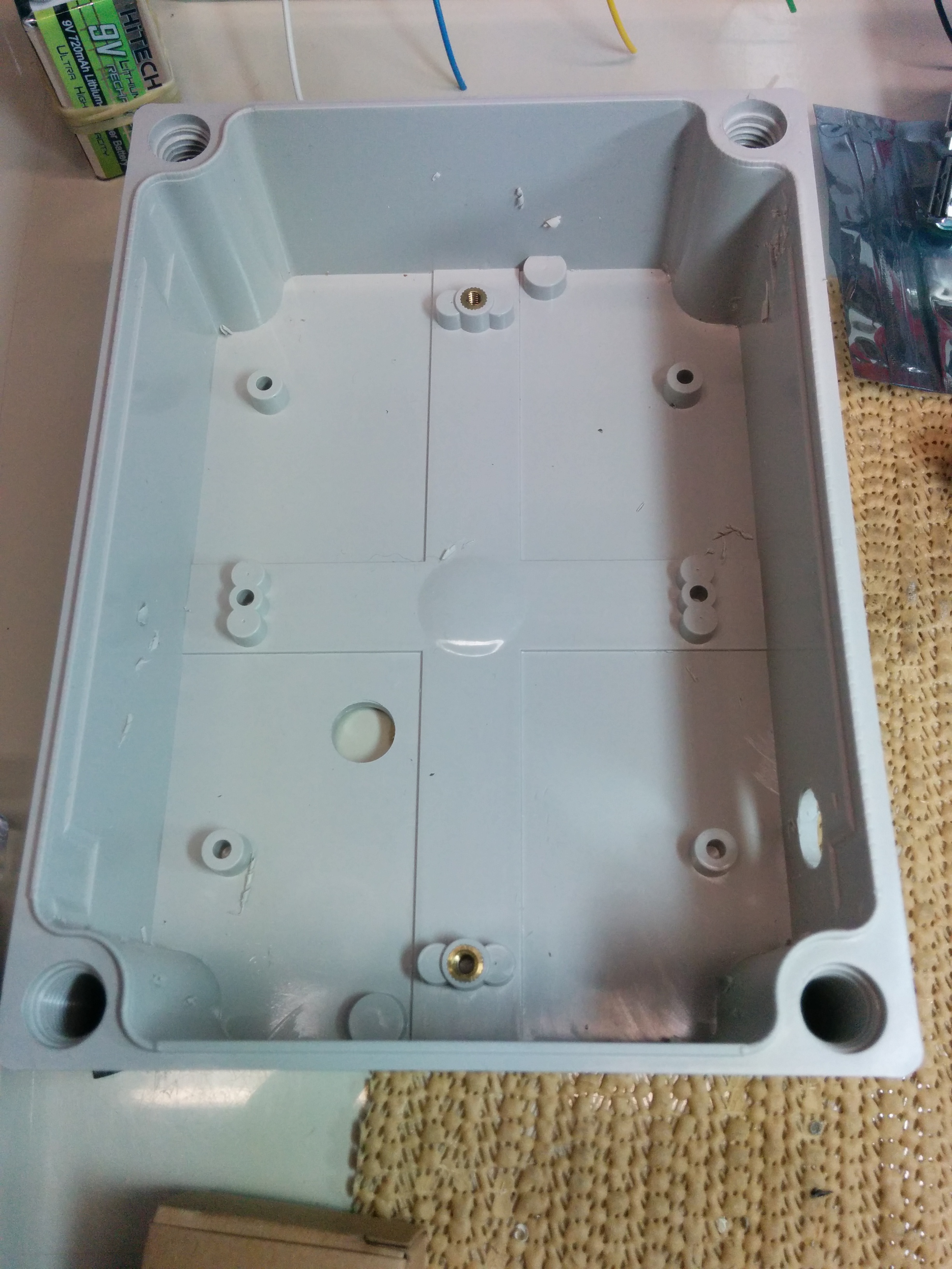

G+_Travis Hershberger Posted July 30, 2015 Share Posted July 30, 2015 Ok, seemingly silly question here that I have a partial answer to. I'm building a temp and door sensor out of a Raspberri Pi 2. Got all the hardware I need for it, but now what's the best way to mount everything inside the case? I'm thinking using spare motherboard standoffs to stack the boards after I've got everything soldered up, but how to get them to attach to the box? Link to comment Share on other sites More sharing options...
G+_Stephen Butler Posted July 30, 2015 Share Posted July 30, 2015 So the moral of Wayne Hobbins?? answer is, get a 3d printer? Am I reading it wrong ?? Link to comment Share on other sites More sharing options...
G+_610GARAGE Posted July 30, 2015 Share Posted July 30, 2015 I would get a piece of plastic (or sheet metal). Mount the plastic to the inside of the case (there should be standoffs already in the case for this) then bolt down your hardware using standoffs. This is technically the proper way to mount stuff into an enclosure. At least for building controls. Link to comment Share on other sites More sharing options...

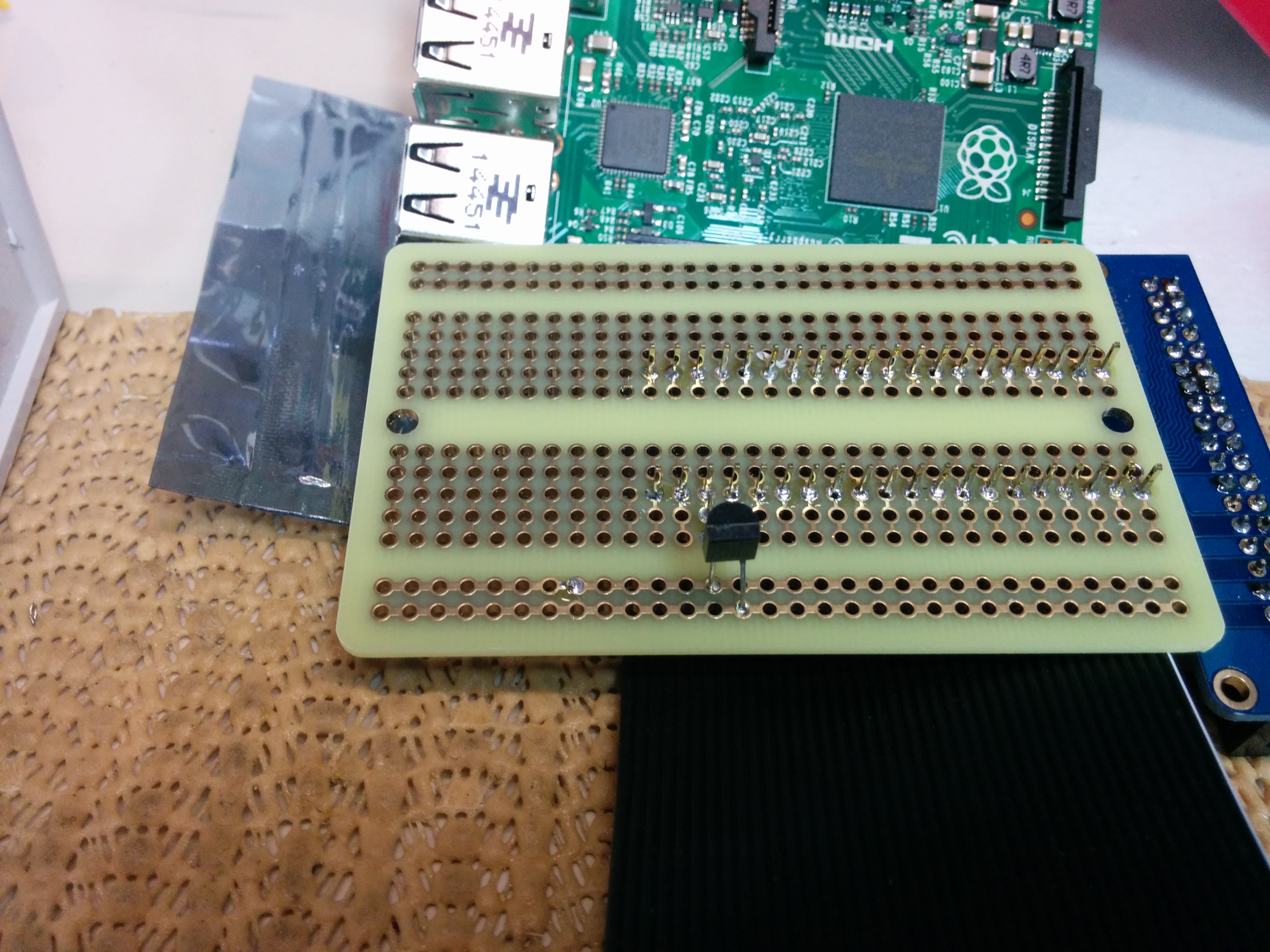

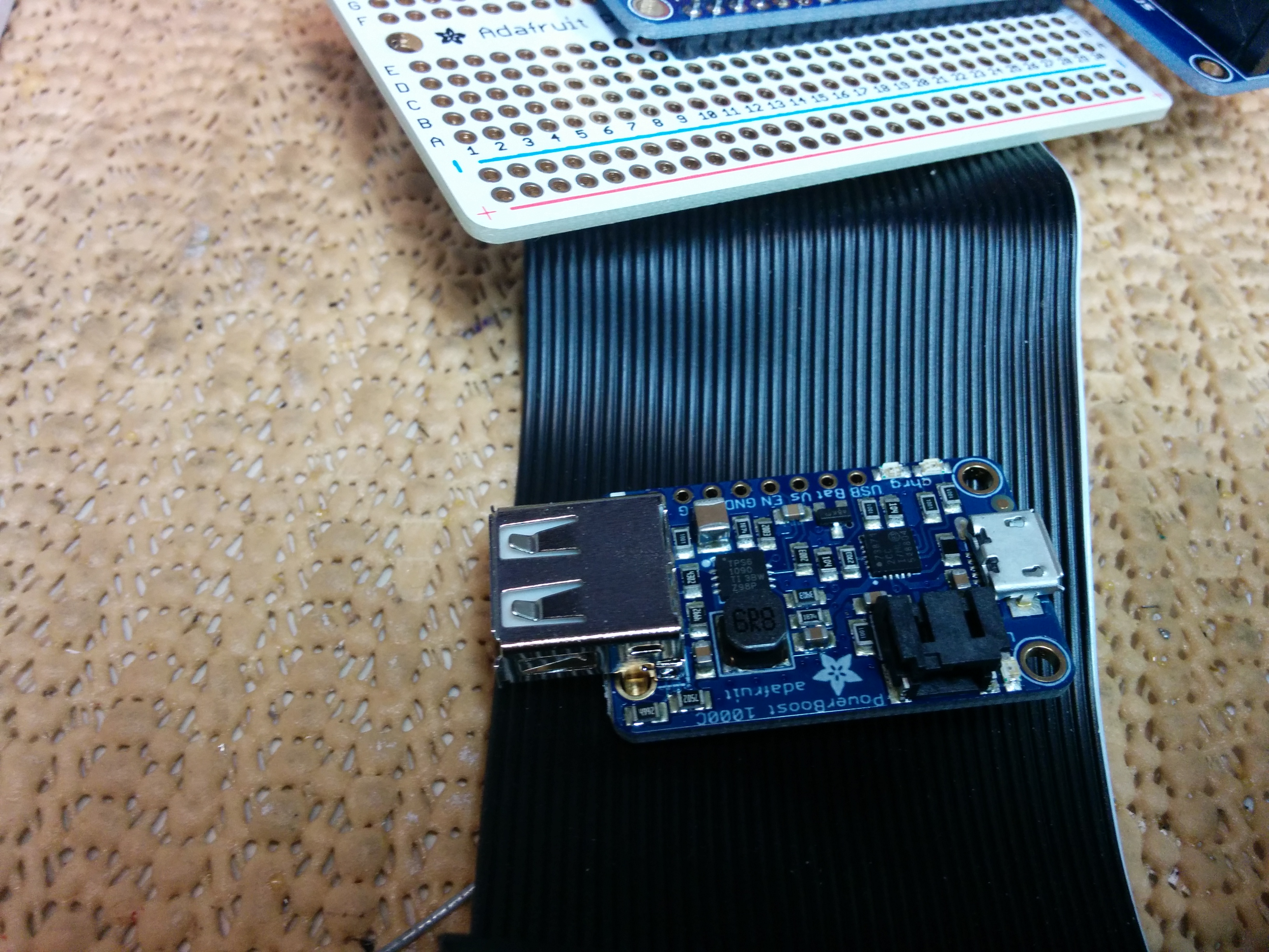

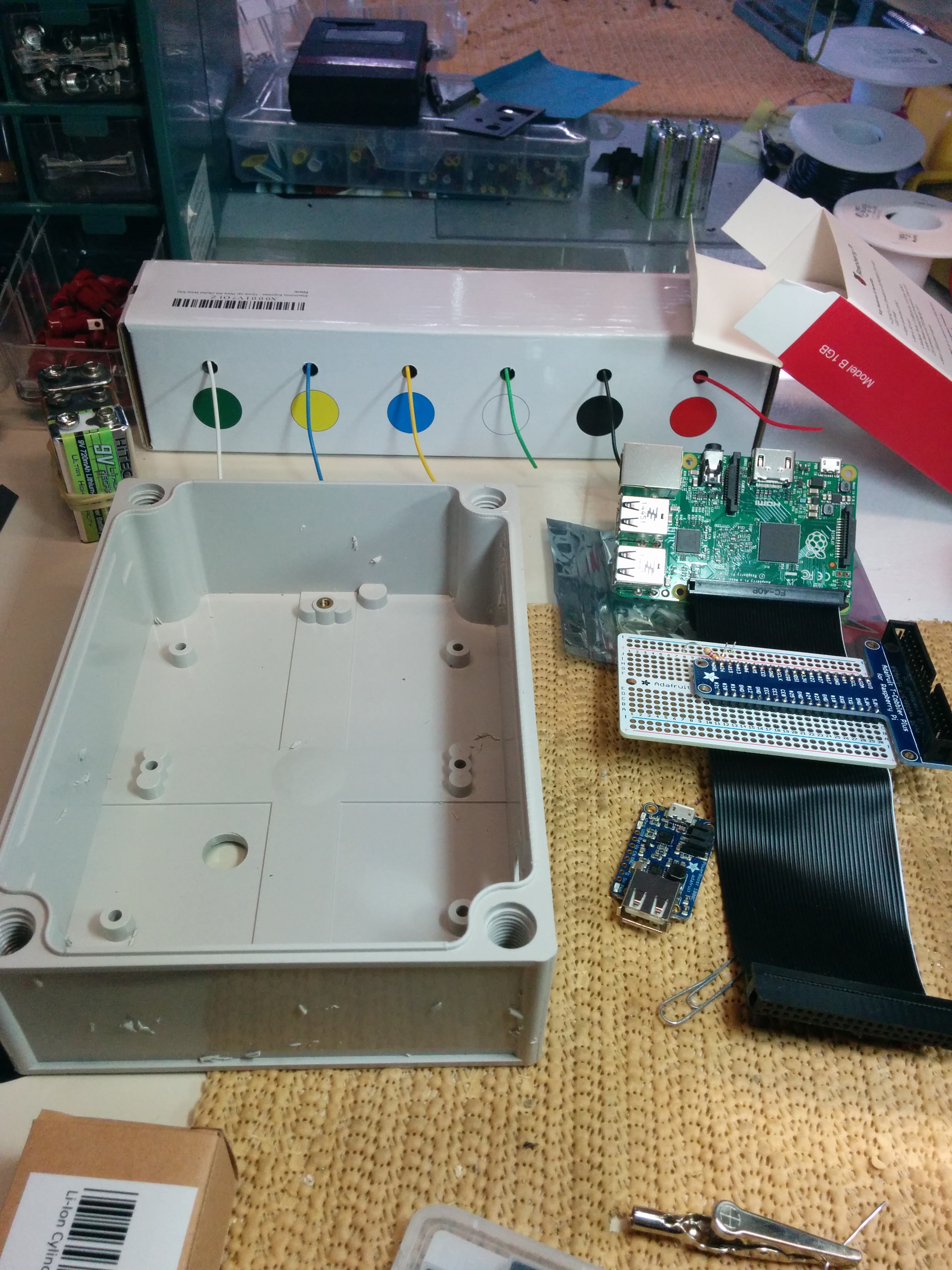

G+_Travis Hershberger Posted July 31, 2015 Author Share Posted July 31, 2015 Well, it's all put together and the pi in installing Rasbian. All that left is the programming which is a bunch of copy-paste from already completed sensor tutorials online. Build pictures and walk through on the way, programming still to be done but will be posted over in Coding101. Link to comment Share on other sites More sharing options...
