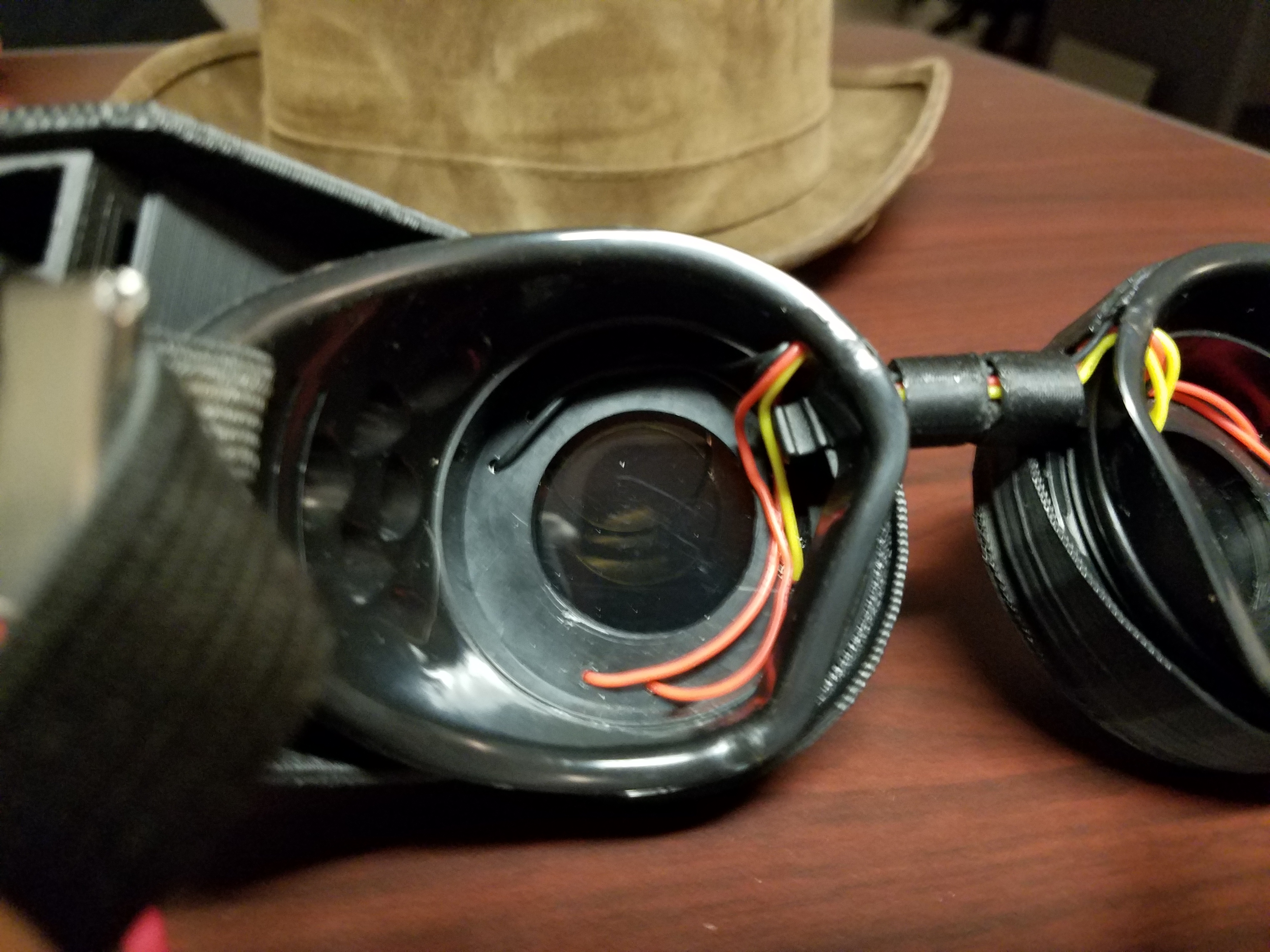

G+_Stephen Vermilyea Posted May 2, 2017 Author Share Posted May 2, 2017 Ken Jancef for my googles I ordered those same ones from Amazon could not wait for china. What they sent was not what was pictured either but correct dia. I had to drill some extra holes to feed the wires. > Link to comment Share on other sites More sharing options...
G+_Shooter_FPV (Shooter_FP Posted May 2, 2017 Share Posted May 2, 2017 Why did you have to drill extra holes? The rings you show seem to be ok. I'll probably order them today. Link to comment Share on other sites More sharing options...

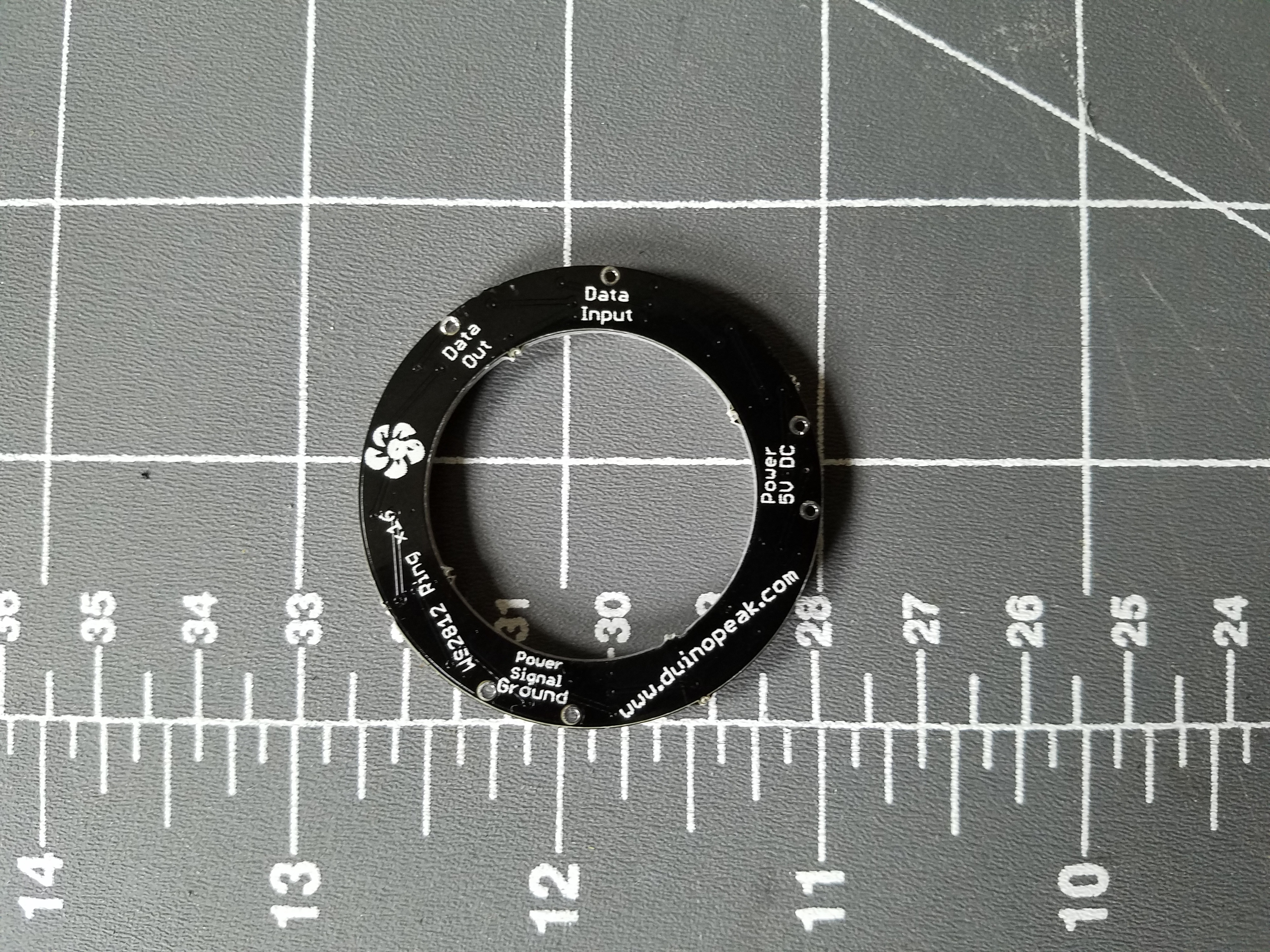

G+_Stephen Vermilyea Posted May 2, 2017 Author Share Posted May 2, 2017 The rings I got have through hole solder joints. 2 for VCC, 2 for GND and 1 for Din and 1 for Dout, but they are located 120 degrees apart. I had to drill holes in the LED ring holder where those solder joints were located and provide extra length wire to those locations. (as shown in the picture I posted above.) Link to comment Share on other sites More sharing options...
G+_Shooter_FPV (Shooter_FP Posted May 2, 2017 Share Posted May 2, 2017 Oh wow... that seems completely different from what's pictured on the Amazon ad... Link to comment Share on other sites More sharing options...
G+_Stephen Vermilyea Posted May 2, 2017 Author Share Posted May 2, 2017 This is what i got from amazon Link to comment Share on other sites More sharing options...
G+_Shooter_FPV (Shooter_FP Posted May 2, 2017 Share Posted May 2, 2017 That's the one Adagruit sells... I checked their site earlier. Ordered the ones from the Amazon link I posted. I can see how those ones have the holes, and they are so spread out. I hope the Amazon ones are ok. And now I'll have to find a build to use the big rings... lol Link to comment Share on other sites More sharing options...
G+_Shooter_FPV (Shooter_FP Posted July 10, 2017 Share Posted July 10, 2017 Stephen Vermilyea So I'm finally going to start my goggles project, and I got the exact same LED rings... not sure why the design changed... was it a pain to drill out the holes? did it affect the overall design/build? Link to comment Share on other sites More sharing options...
G+_Stephen Vermilyea Posted July 12, 2017 Author Share Posted July 12, 2017 I printed all the parts as Padre designed them. I had to dremel the inside diameter of the LED rings to get them to fit the LED ring holder. I don't recommend that(it was a pain). If i would have had the time, I would have modified and printed the holder to fit the ring. To get the holes in the holder, I installed and lined up the data in and out holes in ring with the opening in the holder. Then I used a sewing pin to transfer the other holes to the holder and drilled them out a little bigger than the wire size. Have fun building. I would love to see your goggles when your done. Link to comment Share on other sites More sharing options...
