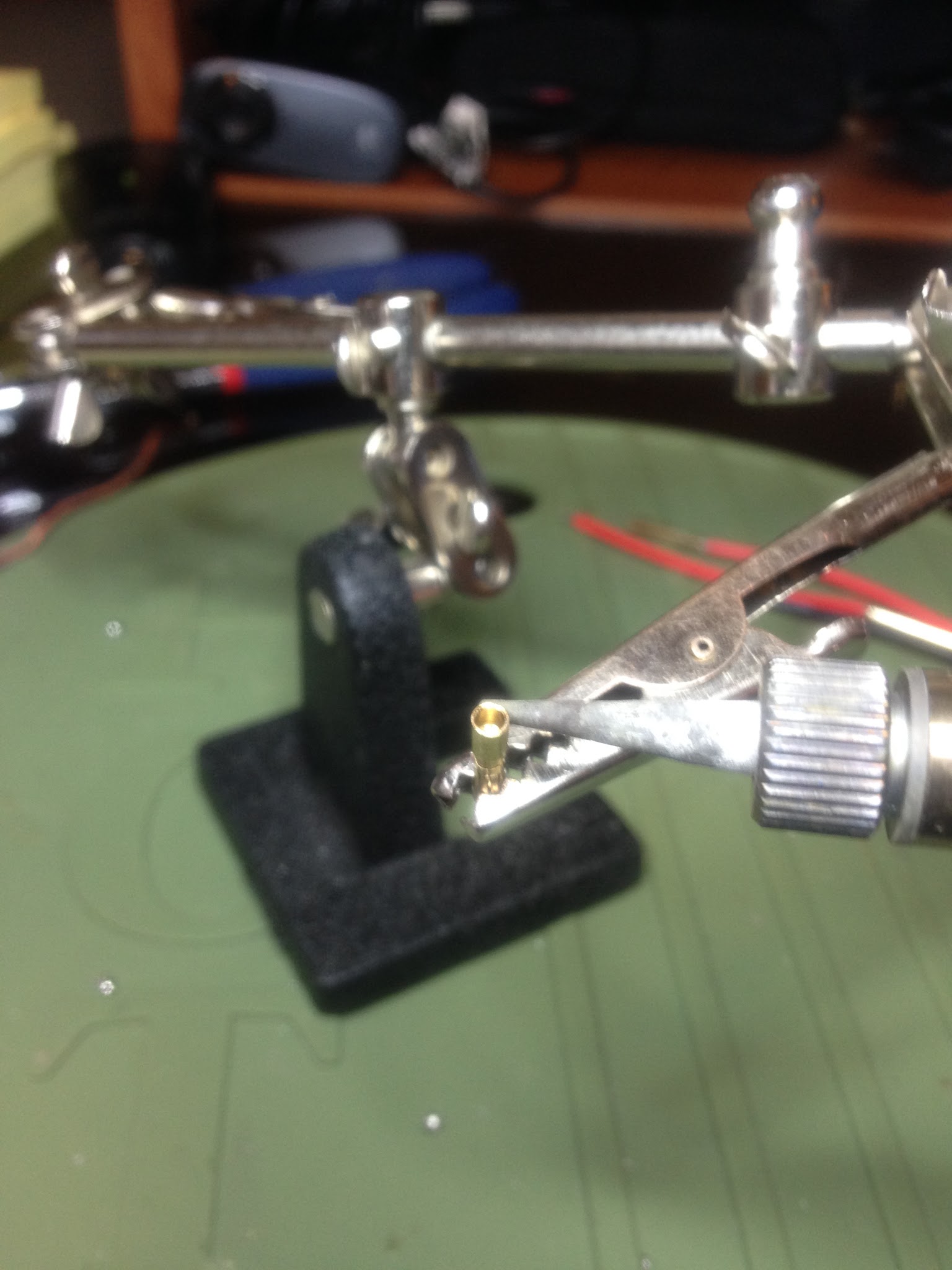

G+_T Burns Posted April 6, 2015 Share Posted April 6, 2015 I've been holding the tip of my iron to this bullet for 10 minutes and it still won't melt solder inside the cup. Temp is turned all the way up on the iron. It's a Velleman VTSS5 from iFixit. Any tips? Dan Salter Fr. Robert Ballecer, SJ Link to comment Share on other sites More sharing options...
G+_Dan Salter Posted April 6, 2015 Share Posted April 6, 2015 Based on that pic I'd say my guess is unlikely to be the whole issue. The bullet looks far enough away from the clip. The only change I'd make is to apply the heat from further up the tip from a thicker part, 5mm or so should do it (greater heat transfer). It should only take a few seconds so if this doesn't help I'm guessing the tip isn't hot enough. As to why another know-hower will have to advise... Link to comment Share on other sites More sharing options...
G+_Rob Egly Posted April 6, 2015 Share Posted April 6, 2015 Clean that tip, and use some melted solder to get good heat transfer into the cup. Link to comment Share on other sites More sharing options...
G+_T Burns Posted April 6, 2015 Author Share Posted April 6, 2015 Using the thick part of the tip worked finally. I'm interested to see the difference the new iron makes when it comes in. Link to comment Share on other sites More sharing options...

G+_Ben Reese Posted April 7, 2015 Share Posted April 7, 2015 You could have probably stuck the tip into the bullet and applied solder as you pulled it out. As for a wooden jig, couldn't a wooden clothespin work? Might need to modify it a bit to make the spring hold tighter. Link to comment Share on other sites More sharing options...

G+_Eddie Foy Posted April 7, 2015 Share Posted April 7, 2015 Also, if its an adjustable heat iron, crank it up!!! If too low, you heat everything up . Having it hot, it does better/quicker spot heating, which is what you want. (Try soldering a SO-239 and you'll see what I mean in a hurry) Link to comment Share on other sites More sharing options...
G+_Steven Atkinson Posted April 7, 2015 Share Posted April 7, 2015 I'd do what Rob Egly? said, clean the tip or replace it. Dirt is one of the main causes of problems you will find when soldering. Link to comment Share on other sites More sharing options...
G+_John Baggott Posted April 7, 2015 Share Posted April 7, 2015 Looking at the TIP it needs a good clean but it does look like it is shot, rather than the alligator clips try a wooden clothes pin Link to comment Share on other sites More sharing options...
G+_T Burns Posted April 15, 2015 Author Share Posted April 15, 2015 Final Followup on this one, I got the weller WLC100 and got the job done in under a minute, just as I expected it to. I blame the previous iron. Link to comment Share on other sites More sharing options...
