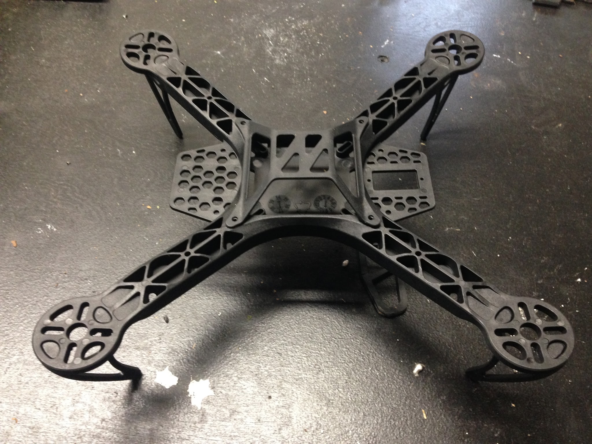

G+_T Burns Posted May 12, 2015 Share Posted May 12, 2015 Got the new KK260 with upswept arms to replace the HK250. Now waiting on the replacement ESC to rebuild after the crash. I also ordered an "RCX-FPV260 Top Frame from MyRCMart.com ( http://www.myrcmart.com/rcx-fpv260-top-frame-glass-fiber-p-8778.html ) Which raises a question in my mind: Is there a way to get a longer ribbon for the KK 215 screen and mount the screen and buttons elsewhere on the quad? That way I could mount the KK in the middle of the quad under the top frame and not worry about whether I can see the screen or tap the buttons. The only other option seems to be to get a different FC with bluetooth to change the settings in the field. Link to comment Share on other sites More sharing options...
G+_Michael Heinz Posted May 12, 2015 Share Posted May 12, 2015 I like that top frame, although I think the wires on my ESCs are just slightly too short to reach if the KK is on top. Link to comment Share on other sites More sharing options...
G+_MyTmou5 Posted May 12, 2015 Share Posted May 12, 2015 It shouldn't be too much of a problem to see if you mount it on the lower plate of the long frame. I transferred my kk to a cicada ls-250 frame which has a similar configuration. I can peer through the holes in the top plate to see the kk display and stick my fingers in through the side openings to reach the buttons. Link to comment Share on other sites More sharing options...
G+_Michael Heinz Posted May 13, 2015 Share Posted May 13, 2015 Yeah, mine are also bottom mounted although I don't have that frame extender. (I'd probably have to upgrade my motors to deal with the extra weight.) Link to comment Share on other sites More sharing options...
