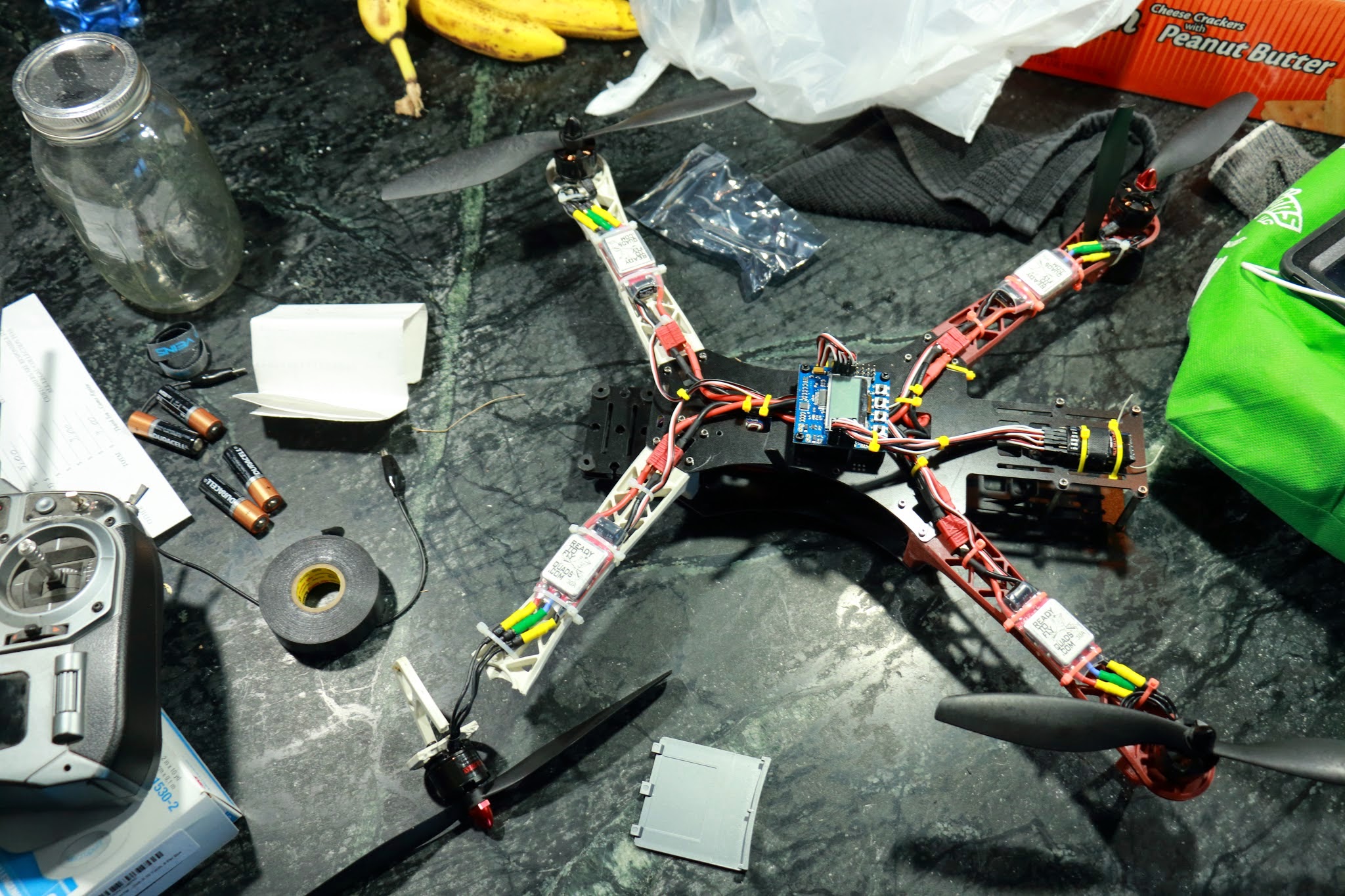

G+_610GARAGE Posted March 28, 2015 Share Posted March 28, 2015 So I just got my motors for my alien X quad. I installed it, checked rotation, every thing seemed good. It is a bit gusty today, but I wanted to see if everything was properly working. I just wanted to get it a couple of inches off the ground. I gave it a little throttle, it started roll, I cut throttle. Wanting to see if it was just my dead zones on controller, I tried again with a little more throttle. It shot up to about 3ft off the ground started to roll the otherway, I started to drop throttle to lower it back to the ground, and a gust of wind took it. It did a barrel roll right into the ground. Broke a blade and an arm. This is why I can't have nice things. :( Link to comment Share on other sites More sharing options...

G+_610GARAGE Posted March 28, 2015 Author Share Posted March 28, 2015 Yea, a little turtle wax, some bubble gum, no one would notice. :) In my defence,I just notice that my remote is acting a little goofy, I took it apart, and all of the caps are around .35nf, so yea, there dead. Link to comment Share on other sites More sharing options...
G+_610GARAGE Posted April 2, 2015 Author Share Posted April 2, 2015 Yup, I'm an idiot. I had motor 3 and 4 reversed. Although in my defence, it should go top left, top right, bottom left, bottom right. Not top left, top right, bottom right, bottom left. Just sayin. Link to comment Share on other sites More sharing options...
