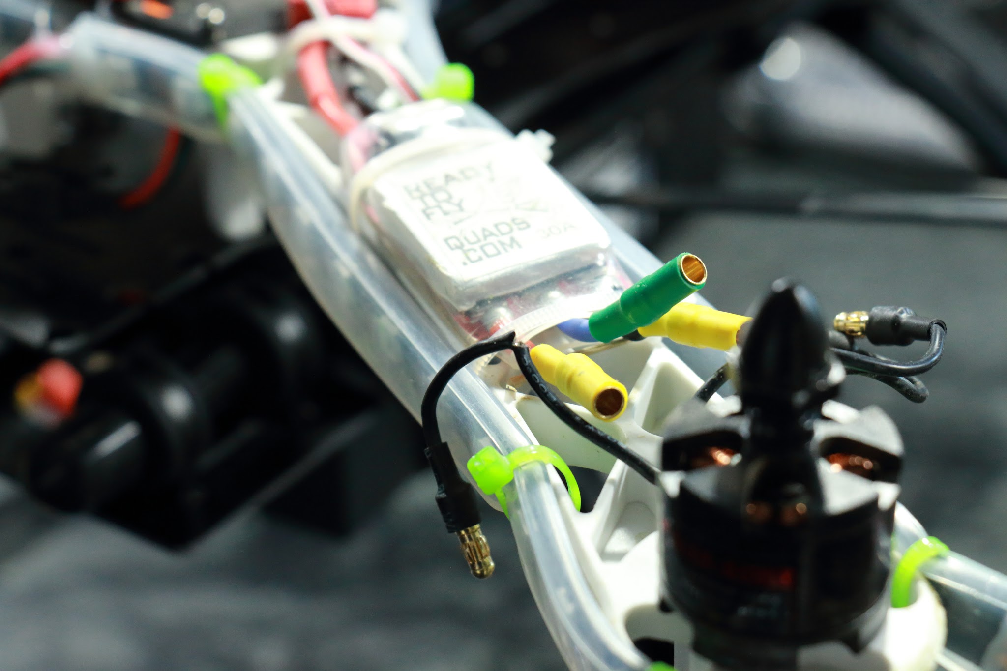

G+_610GARAGE Posted May 14, 2015 Share Posted May 14, 2015 I was working on my quad and noticed this cut motor wire. My best guess of what happened is that during my last crash, the propeller broke and graced the wire. The problem is it wasn't severed. So if I didn't notice, the wire would most likely would have melted into two. That would have probably resulted in motor failure and another crash. So remember, when you crash, check wiring. Ecspecially if you use carbon fiber propellers. Might be obvious, but I thought I'd share. Link to comment Share on other sites More sharing options...
G+_Fr. Robert Ballecer, SJ Posted May 14, 2015 Share Posted May 14, 2015 Good tip... we haven't talked about a thorough pre and post flight checklist, but looking for electrical faults is a BIG one. ESPECIALLY for those of you with carbon fiber frames... remember... carbon fiber is conductive. :) Link to comment Share on other sites More sharing options...
G+_610GARAGE Posted May 15, 2015 Author Share Posted May 15, 2015 Wayne Hobbins You jinxed me!!!! :) I went to fly my quad and that motor wasn't working right (seemed lazy). Checked the wire going into the motor and it was super loose. So I think something did come loose. Owell, I ordered T2212-980KV motors from readytoflyquads.com. Hopefully they're a bit higher quality then these emaxs. Also an ESC just in case. Link to comment Share on other sites More sharing options...
