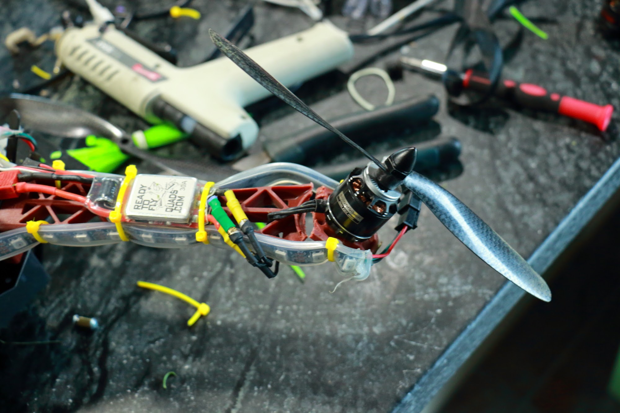

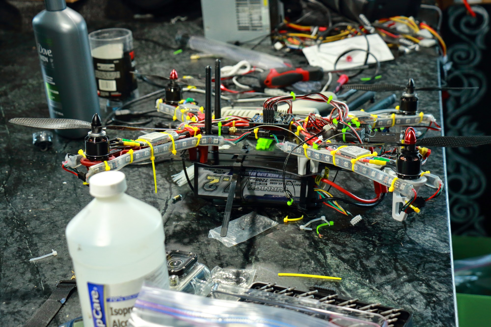

G+_610GARAGE Posted May 25, 2015 Share Posted May 25, 2015 YAQC (let me know if I'm annoying you guys with that) So I was flying my quad, and one of the nuts flew off. GRRrrrrr!! I had enough parts to repair it (I should say rebuild it), but the second test flight, the nuts were loose, and the third flight, another propeller flew off. I had the nuts in the right spot, so rotation of the motor tightens them. Whats going on!! My guess is that I have the propellers that are keyed. So I am wondering if the nuts aren't self tightening and during spin down, the nut are coming loose. Any idea of what I could do, beside loctite? I had my gopro on, so if you want to see the video: Stupid G+ won't let me upload a video and photos. Incase you are curious, my motors are ready to fly quads; T2212-980KV with "DJI style" Self-locking Propeller adapters. My (huge) battery is a 4s and propellers are 8". Link to comment Share on other sites More sharing options...
