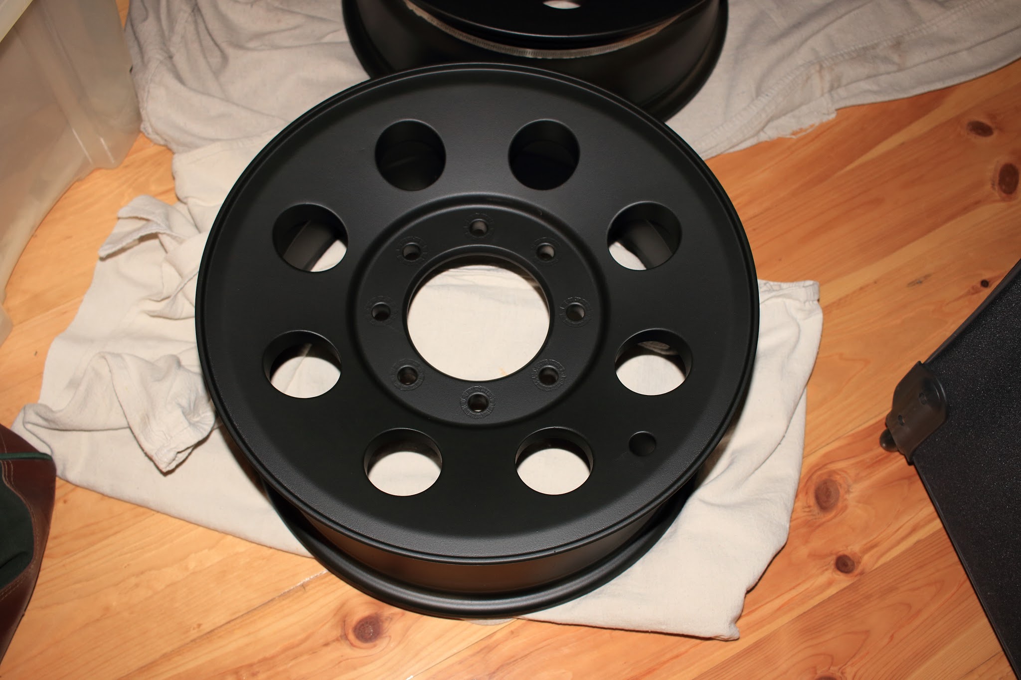

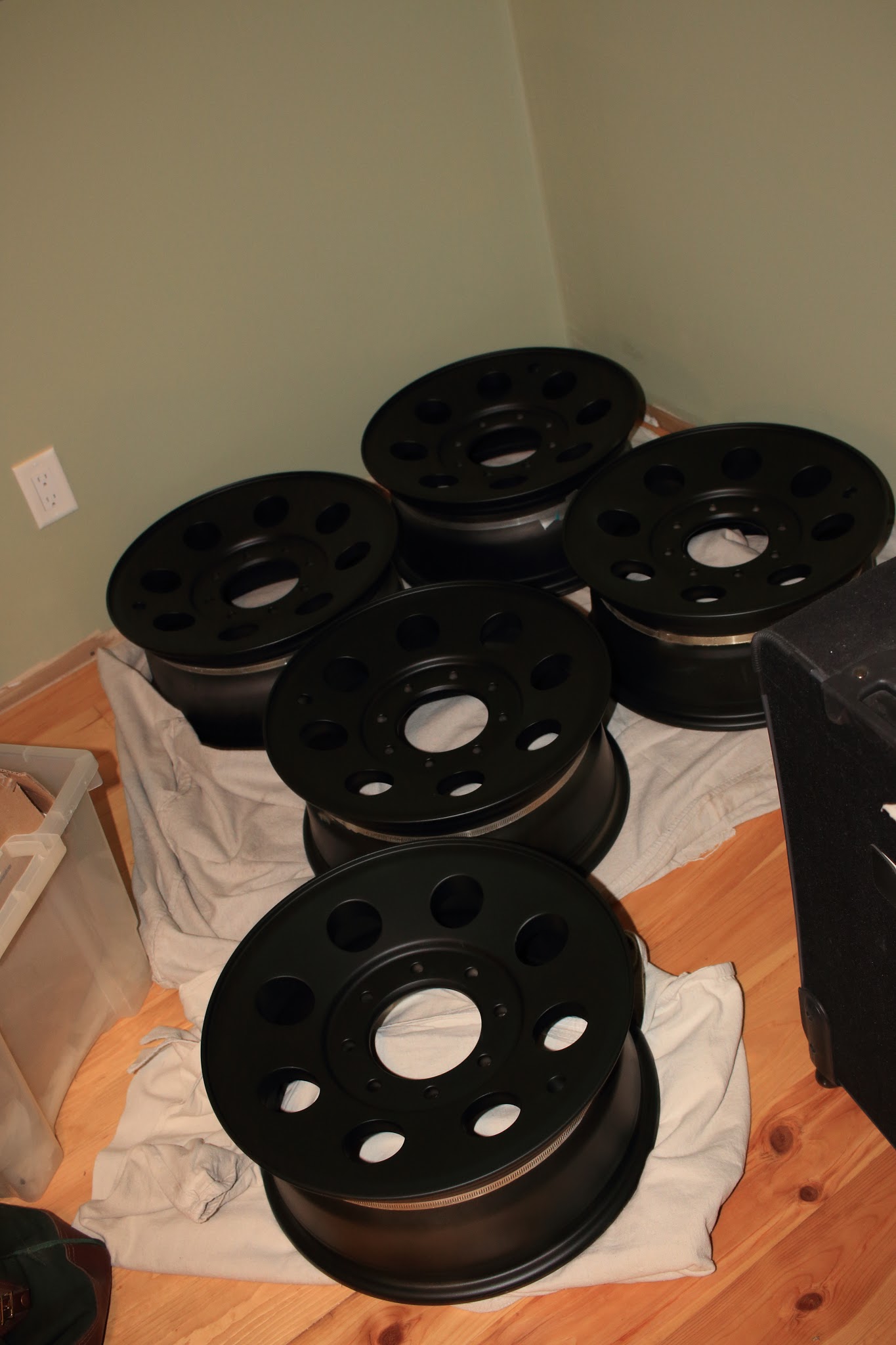

G+_610GARAGE Posted January 30, 2016 Share Posted January 30, 2016 A couple of days ago I posted about using an old phone as a ip camera to monitor my powder coating oven temperature. The rims that I was powdercoating are done and I thought I would share the final product, though it didn't turn out great. But at no fault of the phone. :) Originally shared by 610GARAGE Rims are done, or are they? The first group was pretty good, but the second batch didn't turn out so well. There's contaminations from my gloves, the primer clumped up in certain areas, and some spots didn't get covered well. All of these problems are hard to see, especially when mounted, but my tires aren't going to be in stock until a month from now, or MORE! So I am contemplating painting my axle and repainting my rims. Though, these problems are hard to find, so I may just beat them up and repaint the next tire change. Link to comment Share on other sites More sharing options...
