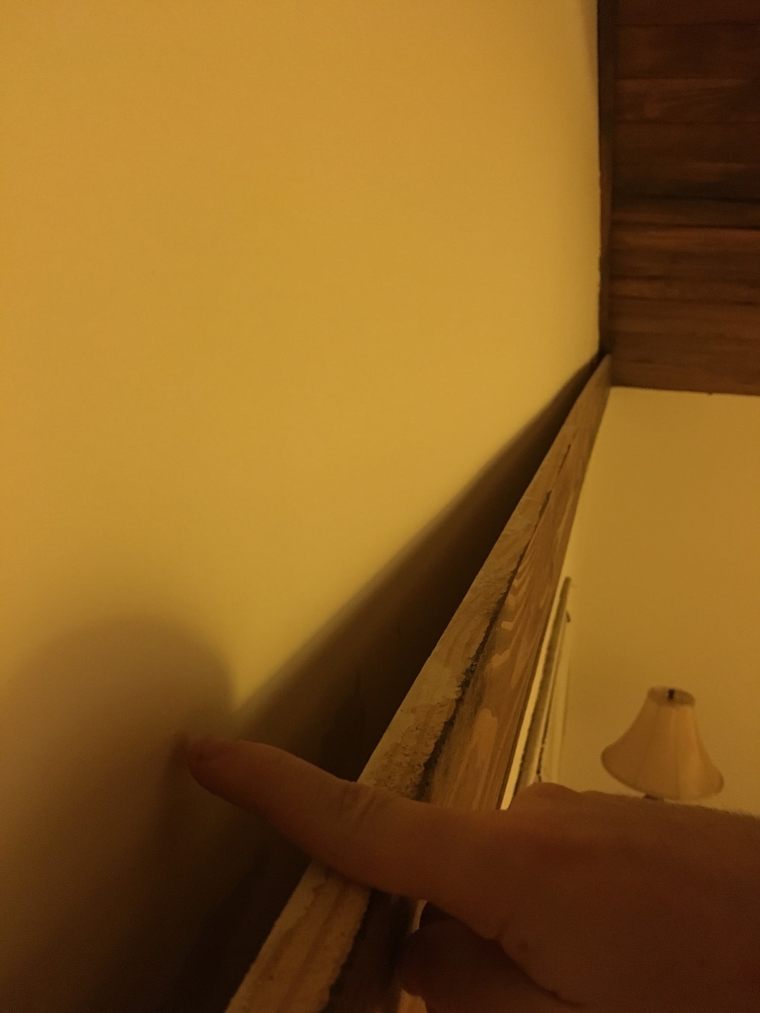

G+_Brandon Cook Posted February 2, 2016 Share Posted February 2, 2016 Hey guys. So the room is almost done. I planned on putting some led strips in the wall faux beam. The trough was supposed to be 3-4" wide with a standard outlet built in. Problem is, they left me with a 1.5" trough and an unfinished wire. I'm sure I can figure out the plug situation, but I know nothing of led strips. Most of the ones I've seen require a power brick at the end. Due to my space issue I don't think that is an option. Is there an option out there that I don't know about? I'm pretty sure I'm not even googling the right things right now. Link to comment Share on other sites More sharing options...
