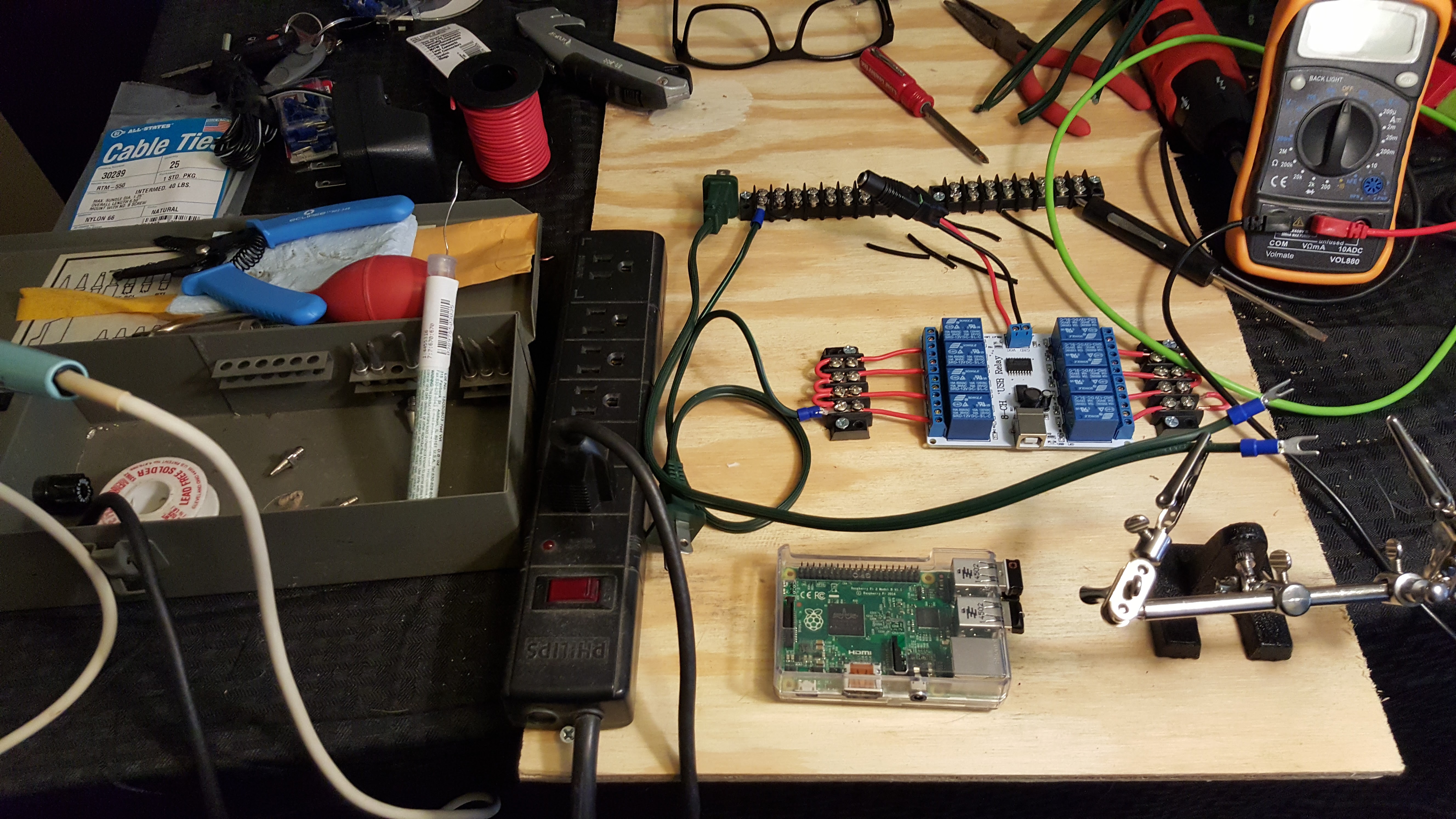

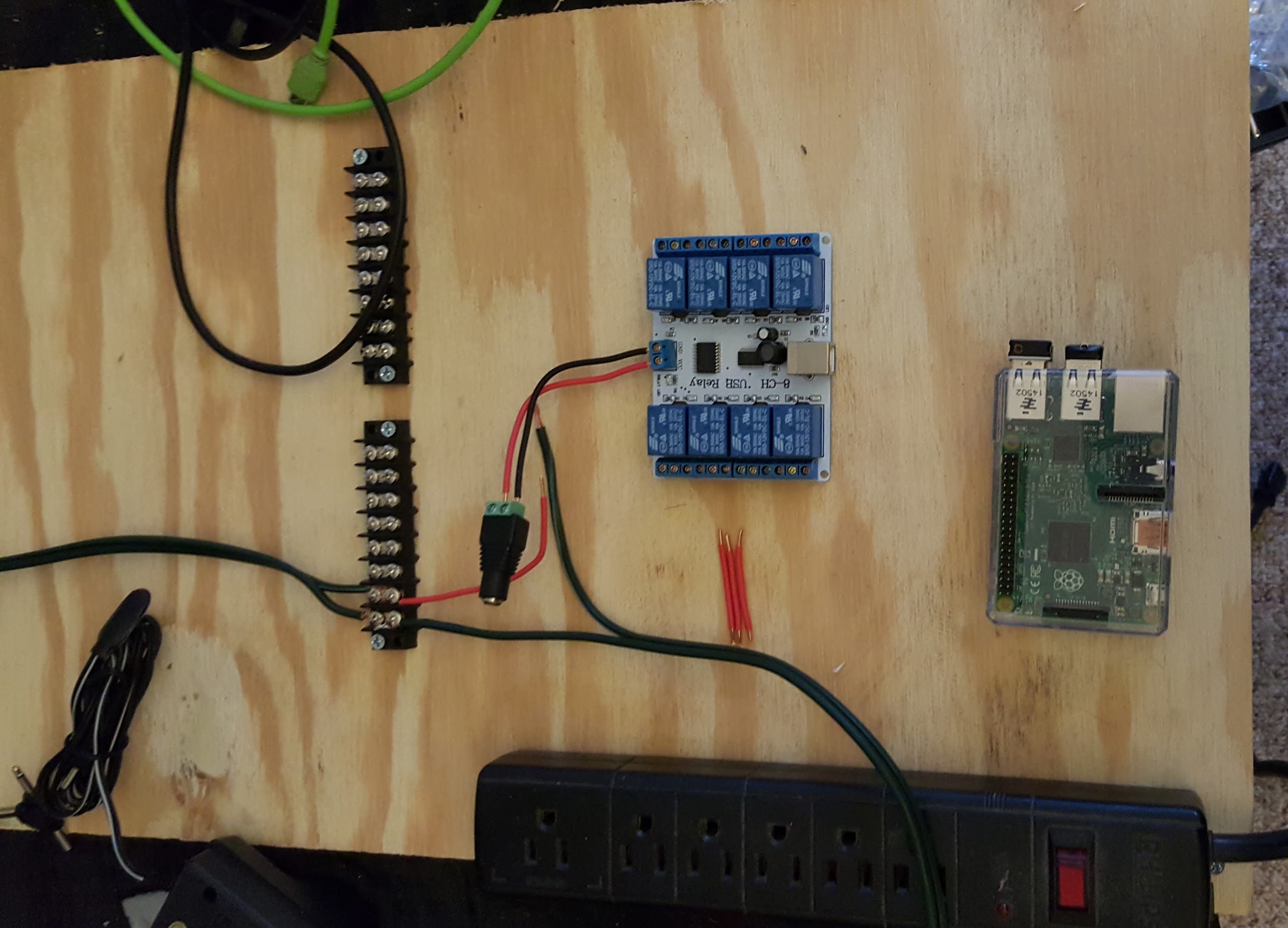

G+_Thomas Nelson (CaboZone Posted November 23, 2015 Share Posted November 23, 2015 Just got done with my RPi control for my Christmas lights. Using the SainSmart USB relay board to control the outlets. Wrote some python to run the system. Found a windows program called Vixen to create the lighting sequence. and it works! Link to comment Share on other sites More sharing options...

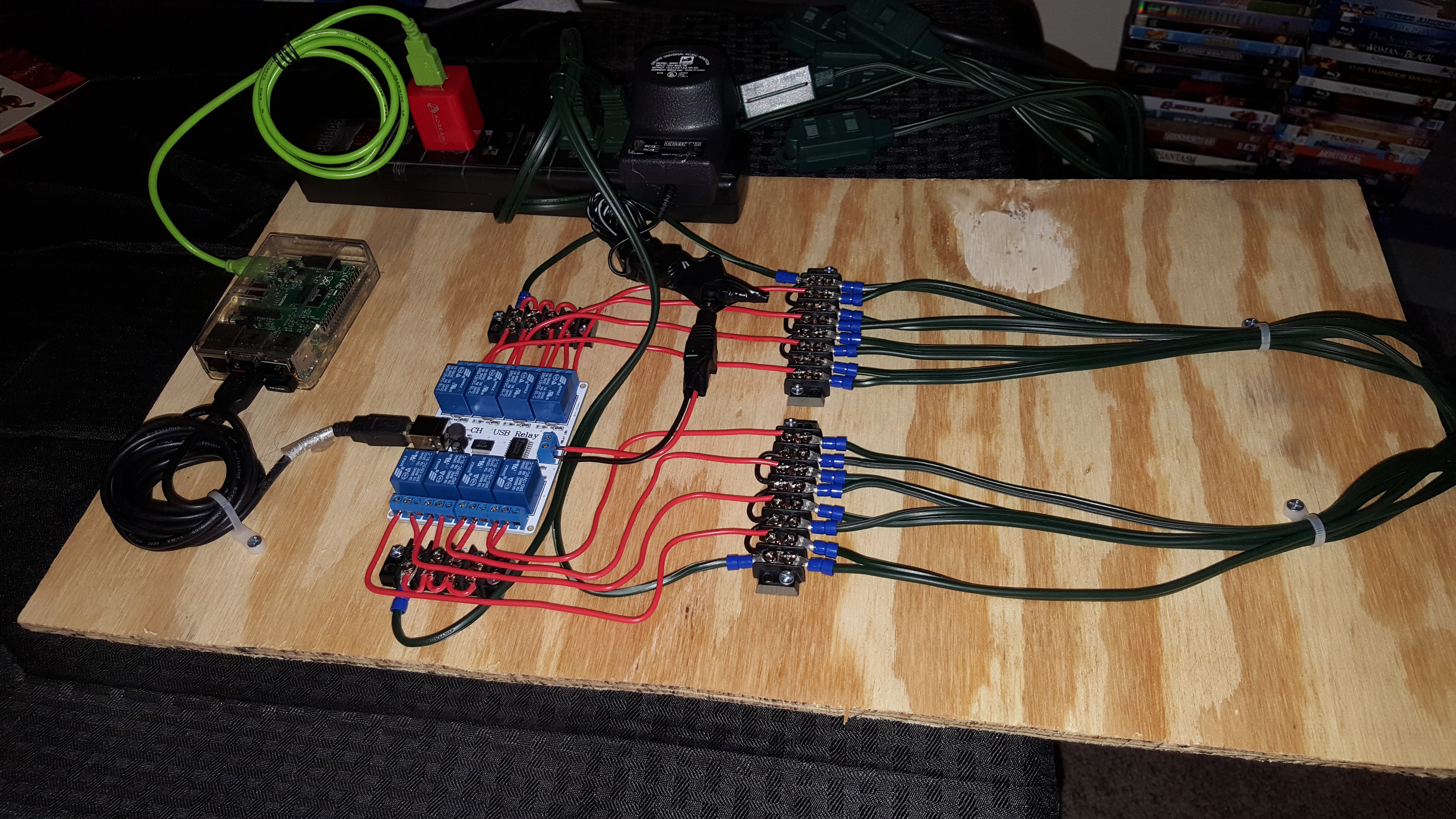

G+_Thomas Nelson (CaboZone Posted November 23, 2015 Author Share Posted November 23, 2015 Board is mounted in the garage and cords go out under the garage door Link to comment Share on other sites More sharing options...
G+_Jason Perry Posted November 24, 2015 Share Posted November 24, 2015 Very nice. Two question though. How many amps are those relays rated for, and What was your reasoning behind giving each side of the board its own plug? Let us know how it goes when all the lights are set up I would love to do something like this one day. Link to comment Share on other sites More sharing options...
G+_Thomas Nelson (CaboZone Posted November 24, 2015 Author Share Posted November 24, 2015 Each relay is 120V / 10A, so enough to power a few light strands easily. I separated each side for some electrical isolation and these were dollar store extension cords, didn't want to push them too much. I have everything up on the house now, will try to get a video posted soon Link to comment Share on other sites More sharing options...

G+_Thomas Nelson (CaboZone Posted November 26, 2015 Author Share Posted November 26, 2015 I used solid core wiring so that I could route the wires how I wanted. Came out good, Link to comment Share on other sites More sharing options...
