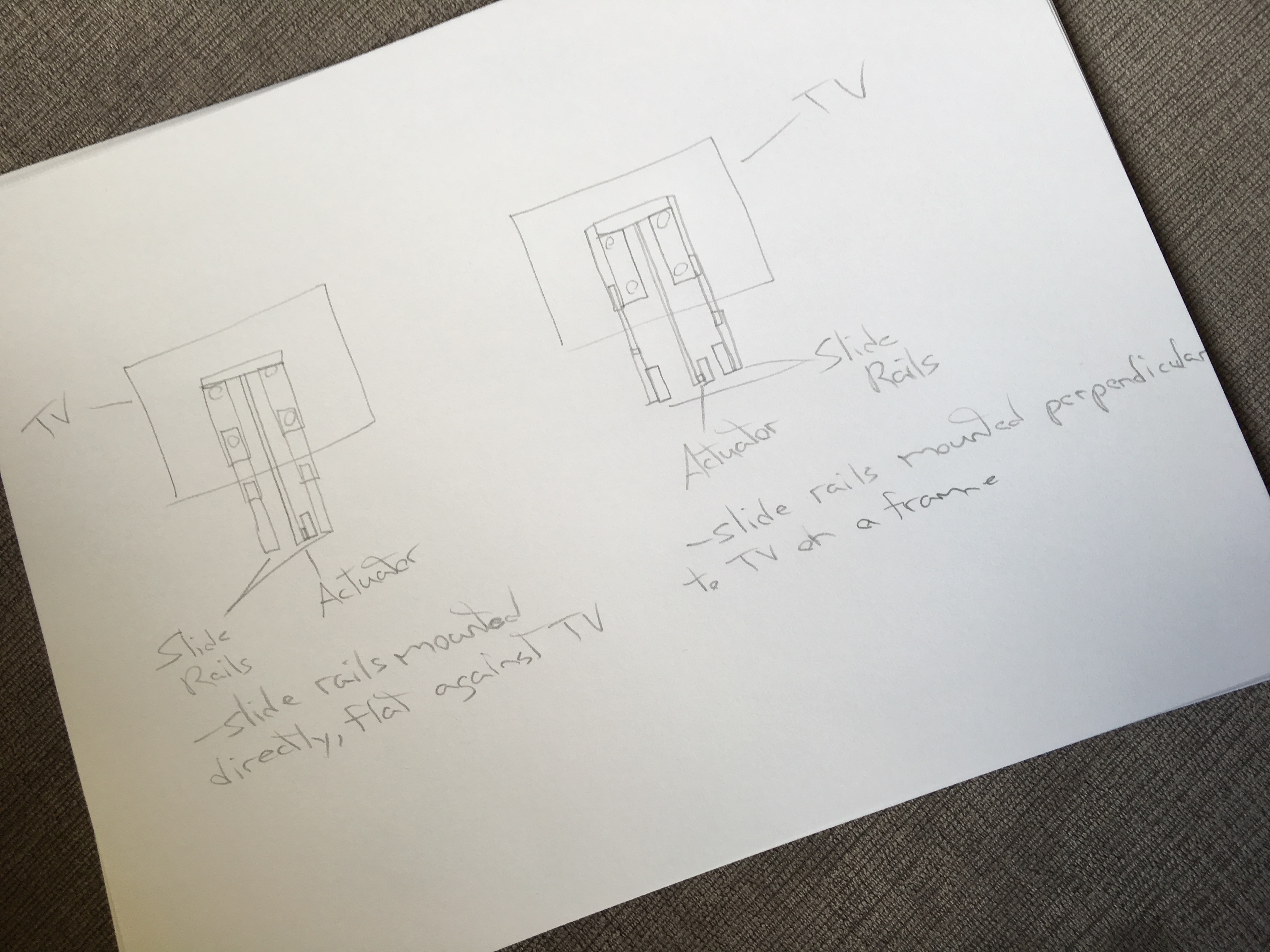

G+_Michael Wild Posted August 19, 2016 Share Posted August 19, 2016 I am renovating a 1978 Airstream and want to add a TV lift in the bedroom. I have determined I am going to use a 30" linear actuator with 30" full extension slide rails. This will be my first project like this so every aspect is new to me. Question: Where is the best place to buy the linear actuator? I have provided a potential parts list below, anywhere else I should look? Also, I have two designs. I am short on depth so one option is to attach the slide rails directly/flat against the TV. The other is to attached them perpendicular to the TV onto an aluminum frame. I get the TV mount will not be as strong, but I don't think I need the extra strength. Thoughts? Thanks, Michael TV Lift Parts List - All prices in CAD unless otherwise noted 30” Linear Actuator Options: $159.99 - 150 lbs - http://www.firgelliauto.ca/products/premium-linear-actuators $166.65 - Firgelli - http://www.robotshop.com/ca/en/12vdc-30-stroke-200lb-premium-force-linear-actuator.html * Stroke: 30” * Retracted Length: 34.53" * Extended Length: 64.53" ? $114.33 - http://www.ebay.ca/itm/30-Stroke-Heavy-Duty-Linear-Actuator-12v-12-Volt-DC-200-Pound-Max-Lift-30-Inch-/122042491322 $114.96 - http://www.ebay.ca/itm/Heavy-Duty-30-30-Inch-Linear-Actuator-Stroke-225-Lb-Pound-Max-Lift-12V-Volt-DC-/261895618990 $121.49 - http://www.progressiveautomations.com/ca/mini-linear-actuator#ig_lightbox2[gal]/0/ $219.99 - Potentiometer - http://www.progressiveautomations.com/ca/linear-actuator-with-potentiometer 30” Full Extension Drawer Slide Options: $57.40 - 200 lbs - http://www.leevalley.com/en/wood/page.aspx?p=46578&cat=3,43614,43616&ap=1 $132 - 400 lbs - http://www.leevalley.com/en/wood/page.aspx?p=50505&cat=3,43614,43616&ap=1 12 Volt Polarity Reversing Momentary Switch Options: $21.99 - Rocker - http://www.princessauto.com/en/detail/12v-dc-polarity-reversing-rocker-switch/A-p8467169e $21.99 - Toggle - http://www.princessauto.com/en/detail/12v-dc-polarity-reversing-momentary-toggle-switch/A-p8467193e Link to comment Share on other sites More sharing options...
G+_Eddie Foy Posted August 19, 2016 Share Posted August 19, 2016 I've used the Firgellis and they work well (though ones I used not in your weight/length range) Happy with their quality. But I'd like to offer gravity. Linear actuators are expensive. A simple motor to extend via linkage or block N tackle is easier and cheaper. You only nee to drive one way and to a single position. (and home) There are helical cables out there But being a trailer, a good thing to have is a air compressor and small storage tank. Ponder an air cylinder. Link to comment Share on other sites More sharing options...

G+_Jason Marsh Posted August 21, 2016 Share Posted August 21, 2016 Restoration budgets commonly exceed the post-restoration value of the vehicle. It's something people do as a labor of love. DOn't worry about the other Jason's comment. Now, about that hideaway tv... Does it need to be a powered thing? A counterweighted retractable tv setup would be easier and a lot cheaper to build, albeit without as much cool factor. I'd imagine you could have a thinner package by placing the slides flat against the back of the tv. WIthin the cabinet, provide a cradle and cushioning for the tv when retracted. I'm sure there are RV-specific hardware for retractable TVs, but you could probably spend twice as much going that route. Link to comment Share on other sites More sharing options...
